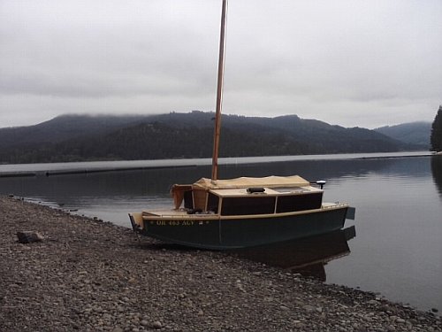

Mark Albanese's Jewelbox Jr is pulled up for the night for a campout. Looks like an excellent cabin slot cover!

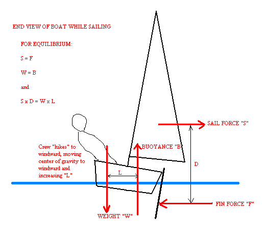

Here is an end view of a boat sailing along in conditions that don't change. By that I mean it is a "static" view which is not to say the boat is sitting still, only that the forces on the boat are not changing as they would in a "dynamic" analysis. So this boat is in a steady wind and in smooth water! I suppose if you went sailing every day of the year you might get to sail in that situation once or twice a year. So it is not totally realistic but is better than nothing when doing the analysis. I don't know how to do a dynamic analysis which would include the effects of rolling and pitching in waves and of gusting winds. I've never seen that sort of study done and doubt if it was ever done in a serious way by a single designer. Perhaps in an America's Cup effort worth millions of dollars a few brains use a super computer to get a dynamic analysis, but not here.
Anyway, in a static analysis all the forces on the object will total to zero and the boat won't be accelerating in any way. It is in equilibrium. There are four forces shown and we'll look at them one at a time.
The weight W is the total weight of everything, the hull, rig, crew, food, stowaways, etc., etc.. As simple as this may sound, weighing a boat is rarely done and the designer can only guess at it in the beginning design stages. And if ten boats are built by ten different builders using identical drawings the weights of the boats will vary a lot no doubt! The weight points downward trough a mythical point call the "center of gravity", basically the point where the boat would balance on say a knife edge.
The buoyancy B is the same as the weight but points upward. The boat will sink down in the water until the weight of the water displaced (pushed aside) by the hull equals the weight of the boat. It can be thought of as acting at a "center of buoyancy" which is essentially the center of the blob of water that is displaced by the boat.
So in the vertical direction the total of W + B equals zero.
Now, if the boat were sitting straight up and down and if all the weights were centered (say like a rowboat or canoe might be) then all would be in balance rotation wise too. But as shown in the example the boat is heeled a bit and the buoyancy has moved off to the side that is deepest in the water while the weight remains centered. Now the two forces are offset by the amount L. And the result is a torque equal to WxL (or BxL since W=B). If there were no other forces on the boat that torque would rotate the boat back to vertical and bring the two forces back in line. But something else is going on here that won't allow that....
HORIZONTAL FORCES...
Looking at forces in the horizontal direction we have the side force S on the sail pushing sideways. Why sideways? Because when a boat is close hauled sailing into the wind almost all of the sail force is sideways. Only a small portion of the total sail force then is pushing forward on the boat and moving it forward. The lion's share in this situation is pushing sideways, so much so that we might as well assume here that all of the sail's force is sideways (as it indeed will be at times).
The boat would slide sideways under that sail force if it were not for the equal and opposite side force generated by the boat's underwater fin (or keel or centerboard or leeboard or daggerboard, etc.). The fin force, F, equals the side force of the sail and is generated by the flow of water over the fin which is at an angle of attack to the motion of the boat (looks like leeway to the skipper). So if the fin is too small or the water flow is not sufficient for it to equal the sail's force then something will happen to make them equal, most likely the boat will start to head more downwind which both increase the fin force and decrease the sail's side force. So if you want to sail to windward well you need a good sized and efficient fin. So F=S when equilibrium is finally established.
But, you say, the sail's force S is way up yonder and the fin's force F is way down below. Let's say the forces are apart by a distance of D. And another torque is established by the offset in the forces equal to SxD (or FxD since S=F).
BALANCE OF TORQUES...
Most engineering involves just figuring out balances like these. It's really simple! For the boat to be in equilibrium all of the forces and all of the torques will total zero (if they aren't the boat will be accellerating in some way). We have already balanced the vertical forces with W=B. And we've balanced the horizontal forces with S=F.
Now we need to balance the two torques on the hull to total to zero. So SxD = WxL. Let's rewrite that to be S = WxL/D. So for the hull to be in equilibrium the force on the sail will be equal to the boat's weight times the offset between the boat's center of weight and it's center of buoyancy all divided by the the offset between the boat's center of sail area and its center of fin area.
What happens if the force S exceeds that amount say as in a gust of wind? The boat will roll to try to increase the distance L if it can. But there is a limit to that distance on any given boat. If the the force S is strong enough the boat will continue to roll right on its side and over. It capsizes!
So my idea is that the sail force S can be controlled by calculating the sail area needed to capsize the boat in a given wind. How do we do that?

You can see all the guesswork involved, especially involving weights and their locations. On small boats the weight of the crew is such a large proportion of the total that it greatly influences the results in the program and in real life. Hullforms assumes the weight is centered but if you place your weight to windward by "hiking" you can greatly increase your righting moment and carry a lot more sail, like this:
On a small boat where the crew weight is large compared to the total the effect of hiking can be huge. Here the man has about doubled the value of L and he can carry about double the sail force than in the original case.
On the other hand if your weight is to leeward you greatly decrease it. So the skipper is something of a tightrope walker. If you hike to windward in shifting gusty winds you may find your "windward" weight suddenly becomes a "leeward" weight and you can capsize backwards!
