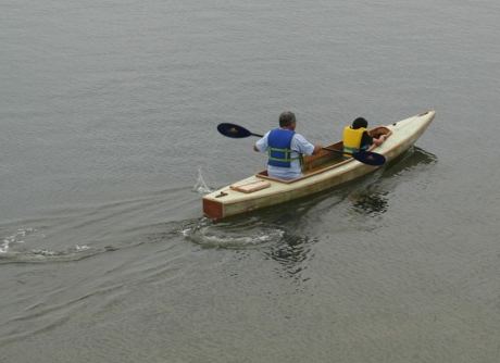

Joe Milavsky built this Larsboat to plans except he used planks of styrofoam glassed on both sides to make a high tech composite. I think Chuck Leinweber made his Imresboat that way too. If you don't mind the cost and mess you can save weight.

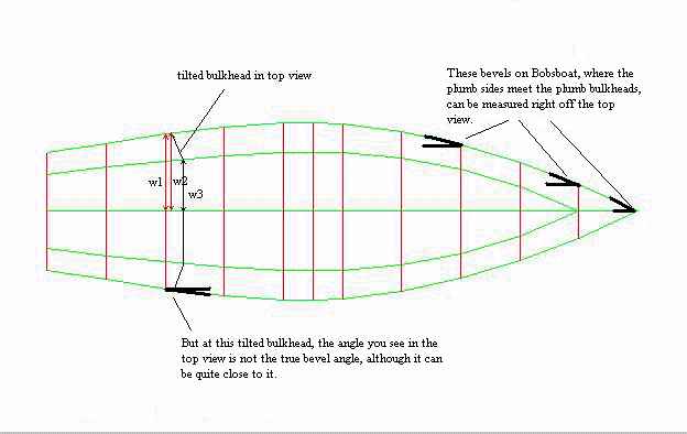

If you have a plumb sided design like Bobsboat, your top view will often suffice to get nearly all of the bevels required. You will be looking straight down the plumb sides in the top view and if your bulkheads, etc. are also plumb, you are seeing it right. Just take a protractor and measure the bevels right off the top view, like this:
What if you have a boat with sides that are flared but not twisted, like many flatiron skiffs? You have to draw another view tilted so you are looking straight down the side.
I've got a little hint that I have found to save a lot of extra view drawing: if the amount of flare is small, say 5 degrees, the bevels are essentially what you see in the normal top view.

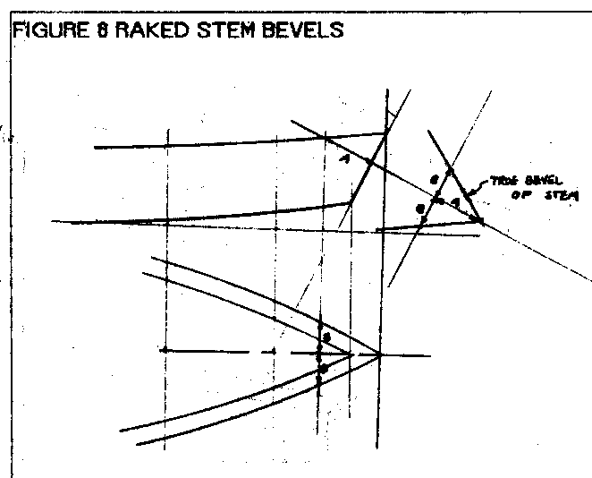

If your sides are flared and have no twist then you will have a raked stem. You can't just measure this one from the top view. Here is a guide of one way to do it.
Remember that you need to twist your view such that you are looking straight down the stem.

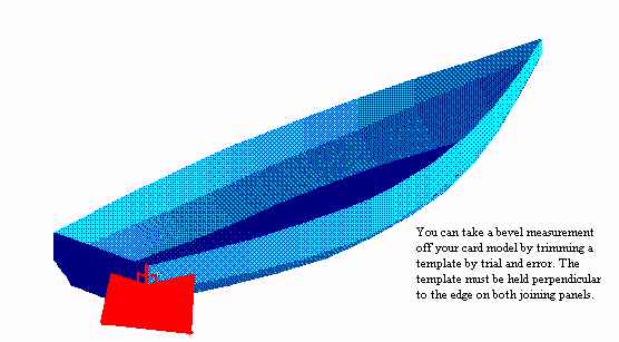

Grab that card model you made last time. Find the intersection of the panels in question, in this case where the side meets the transom. Mark lines on both joining panels that are perpendicular to that joint. Now cut a template that fits exactly at those lines. Like this;
Now use your protractor to measure that angle. You might check the opposite side with the same template. With a small flimsy card model this method is not too exact but then again it requires no computer or twisted thinking so your answer will be pretty close. While you are at it you might double check the stem bevel you calculated with the same model.

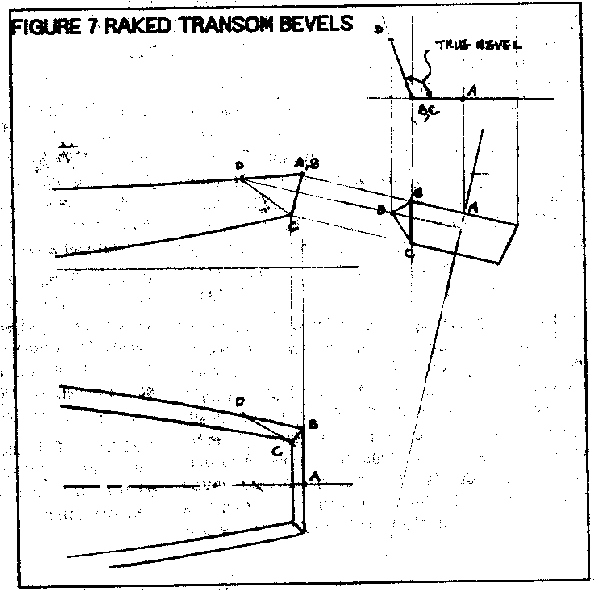

The required bevel can be determined on the conventional drawing board. Here are the basics:
Essentially here you start by making a true shape projection of the transom. Then you make another projection that looks straight down the edge of the transom as shown. These can be done in a jiffy if you are practiced but if you are just drawing a boat every now and then, you might have to go slowly and carefully. Then you ought to check it against the No Brainer Number 2 results. It is easy to twist your thinking the wrong way!

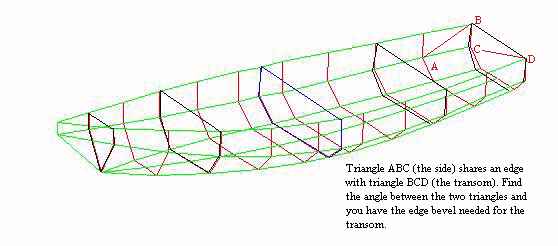

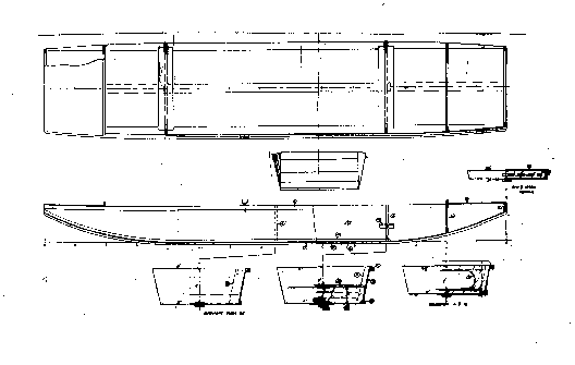

Look at this view of the Bobsboat and note that I have constructed two triangles, one on the side and one on the transom and they share a common edge. We want to find the angle between those two triangles and that is the mystery bevel.
Remember we have already drawn the lines and taken offsets at regular points. So we can look quickly at our drawing and see the xyz dimensions of the points. So only four points in xyz space are needed here to define both joining triangles since they share two common points.
Hope you paid attention to your university math! You may think that 100% of that stuff was useless in real life but I can assure you that about 25 years after I graduated I found 1% that I needed.
Take triangle ABC. The plane that triangle lies in (which is really the plywood panel) can be defined by two joining vectors, vector AB and vector BC. If you take the CROSS PRODUCT of those two vectors you will get a third vector that is perpendicular to the plane of triangle ABC and can be thought of as the "direction" of that plane.
Similarly with triangle BCD. Take another cross product and find its direction vector.
Now if you take the DOT PRODUCT of those two vectors you will get a number that represents the cosine of the angle between the two planes! And from there you can figure what the angle between the two planes is. There you have it - the mystery transom bevel.
Now don't ask me how to figure cross products and dot products. This is vector math involving matrices of numbers and is true rocket science. But you can dig them out of those old math books you probably threw out. In the mid 60's when I was in school we used to beat these numbers to death with a Pickett slide rule and a lot of pencils and paper. If you had thirty kids in a class you would get thirty different answers to the problem given the errors in the endless calculations required. BUT NO MORE! Today you plow your way through it once with a spreadsheet in a PC. Then the machine does the calculation with no error in the time it takes to tap ENTER. My spreadsheet asks for the xyz offsets for the four points that define the two panels and then it spits out the needed bevel angle!
And then I always check the results against my card model just to be sure. Once your spreadsheet has been debugged it is usually faster to figure all of the boat's tilted bevels this way!

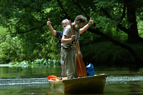

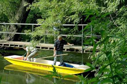

Anyway, our old buddy in Poland, Wojtek Baginski, built the prototype to perfection. In one of Phil Bolger's books he says the real trick of designing a successful boat is to get your design into the hands of the right user, and so it is with Wojtek. Here is his account of the maiden voyage:
"Here is a brief description of polepunt nautical characteristics. The first is that polepunt is incredibly stable. During our cruise the crew (Wojtek Baginski is in the stern in most of these photos and his boating buddy Wojtek Holnicki in the bow) was often forced to gather on the stern first, and next on the bow (after boat's center has passed over the bar) to jump over a tree or a branch laying in the water, not stopping the punt. We were using the internal stiffener as a walkway and it helped much to keep the balance.

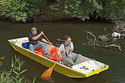

The second notice is that polepunt responds to oar action very well. After more of less a strong push of a pair of paddles she smoothly went a long distance on calm water. Looks like rowing will be successful as well, when an oarsman will take a seat at the center of the boat, and will pull the boat with the pair of 7 foot oars (we have chosen a pair of heavy ones for the Vistula , because of possible wind and waves acting on her open area against the boat). As for using a pole, it's really amazing and effective power, but needs a bit of experience. Worth learning!

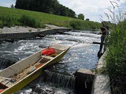

Another notice is that the boat is surprisely strong, I think because of relatively low ratio of free plywood surface to chine logs, stiffeners, gunwales and frames. She got a few strong hits and scrapes from wooden, concrete and stone objects, but generally everything is OK, external chine logs gave good protection to the sides in extremal conditions. I laminated the bottom with a fiberglass twice, inside and outside, by the way.
So, the boat is really useful in various conditions (we checked her out during 20 km long raft in various water areas including wild state creek, regulated state creek, small man made lagoon and big river). I think with her low cost and quick building process she is a very good proposition not only for beginners but for advanced adventurers as well (hey don't look at me! :).
Thanks Jim."

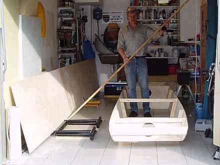

Nothing to builiding Polepunt, of course. Nail and glue construction from four sheets of 1/4" plywood.
