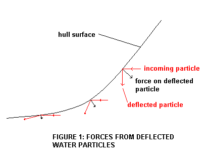

Phil's theory starts with the idea that the boat is crashing through a sea of frozen peas. As it moves along it pushes each pea out of the way, the push being somehow proportional to the speed of the push and also the angle that the hull meets the peas. The push is perpendicular to the surface of the hull. The sum of all those little pushes is the drag caused by the form of the boat. (Drag caused by surface area friction with the water is another story.) Sort of like this:
particle
Right away you can see that a long finely shape boat should have less form drag because the angle of that the hull makes with the peas is more shallow than a short blunt boat. No surprize there. And a narrow boat will push the peas with less force than wide boat.
So, ignoring the surface area part of the problem, making a boat longer and narrower should make it faster.

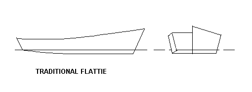

Here is a picture of a typical flat iron skiff:
flattie

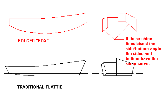

It's the sort of boat that we've looked at all our lives. It has a pointy bow with the stem fairly deep in the water. Bolger would say something like this: The bow sides curve a lot more than the bottom. Therefore the pressure on the sides is greater than the pressure on the bottom. So the water on the sides will try to move from the higher pressure on the sides to the lower pressure on the bottom, eddying around the sharp chine as it goes. The eddies are energy robbers that slow the boat.
What is really interesting about Bolger's theory is that he ties together the shapes of the different hull panels, the sides, bottom and bilge panels. By his idea, those panels should all have the save curvature, if possible, for the best flow lines. The same curvatures would mean the panels have the same pressures and the eddying would be minimized. So the Bolger boat would have perhaps the hull narrowed and especially have the bow rocker increased a lot. Usually a firm following of the Bolger rule would result in a flat bowed scow. Bolger's version of the same boat might look like this:

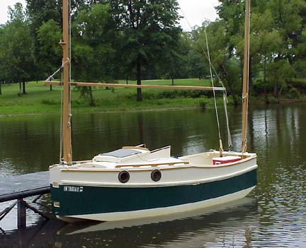

This particular Mico belongs to John McDaniel. It's one of the finest examples you will find, probably the best built boat I've ever seen. You can see the Bolger theory at work here. The bottom is highly rockered, the bow sweeping very high. The bow is also squared off and would sweep even higher if it were not squared off. But even here the bow is not swept up to the degree of matching the bottom and side curves. Phil also believes that the plumb sides give superior motion over flared sides. All these elements combine to give what we all call the Bolger Box.

By the way, you can tell at a glance at the hull lines whether the sides and bottom have equal curves. Look at the lines below. If in the end view the chine line bisects the side/bottom angle then the two panels have equal curvature.

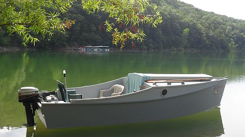

The lines above are for Piccup Squared. But I've used the theory quite a bit including Moby, Pencilbox, Cubit and Jewelbox, all shaped exactly to the theory. They are all scow bowed. Karl James' Jewelbox is shown below, it's roomy simple scow hull very apparent and you can see the chines sweeping well above the waterline fore and aft. These boats all sail quite well, with the warning that any wide flat bow will bother you in rough water. It's possible that the pointy boats are better then.

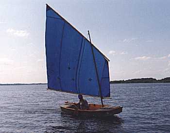

I haven't used the little bow transom. I've either gone full scow bow or full pointy bow. But the idea behind the Bolger theory is kept in mind and the bow is swept up above the water as you see here in the pointy bow AF2.
