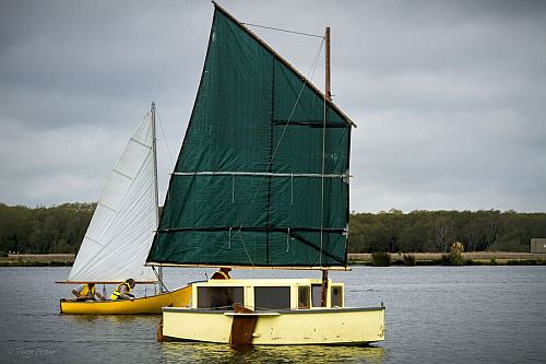

Robert Kellock has been sailing his Philsboat in New Zealand for several years now. In this photo he is in a recent "race".....

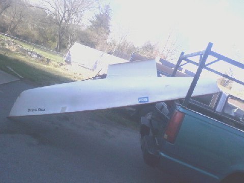

the next experiment was to remove an even 2" from the bottom of the fin ( the above picture ), reducing the area to 3.75% of the sail area. i did this because i wanted to see just how shallow the fin could go, before losing windward performance. it kind of sets up my limitations. also, if the full keel proves to be a bad performer, but fin2 ( this fin )was a good performer, i would choose to go with the shallower board, for ease of launching. i don't think the 2" difference would be noticeable, as far as drag is concerned, but fin2 does have less wetter surface than fin1. the lead did not change.
in fact, truth be told, if fin2 launches sufficiently easily, i may not try the full length keel. it would be greater wetted surface and not much shallower.

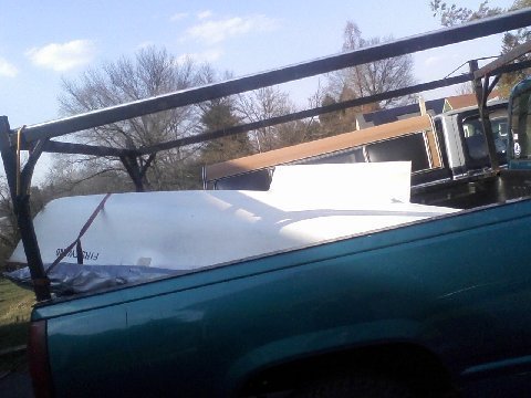

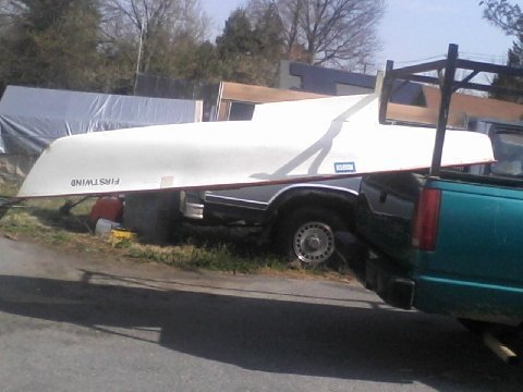

this picture was taken with the boat in the back of the truck, but you can see, if you compare it to the other picture, that the fin is noticeable shallower.
ok. that was a success. it was shallow enough to make launching much easier than with fin1. no adverse sailing performance. it may be a tad faster. wind conditions, on this test run, were more stable, than before. approximately 8 mph winds from the north. she tacked between NW and NE consistently, sometimes a bit closer.

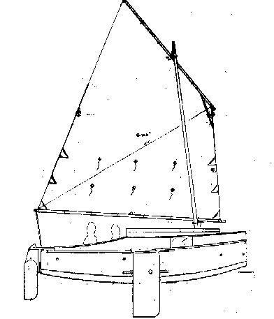

When I got the plans for the Fatcat2 I studied them and wondered if I could use the leeboard on Morning Gloring.
I built and installed the leeboard and Monday got the chance to take it out on the gulf.
I was on a run and low tide out of the harbor and had the board up. When I got out in the channel with some depth I got the board down and that didn't seem to bother running at all. When I got out into deeper water, I headed off to a broad reach and it seemed to track straighter and point better. Then I came to the first tack, I swung the tiller over and the boat came about with no effort. That never happened before without a fight or start the motor. I thought to myself, OK don't get excited let's just sail back and try it again. This time it came around again with ease. And that's the way it went the rest of the day. I could sail the boat any where I wanted in heavy wind or light. I was delighted.
