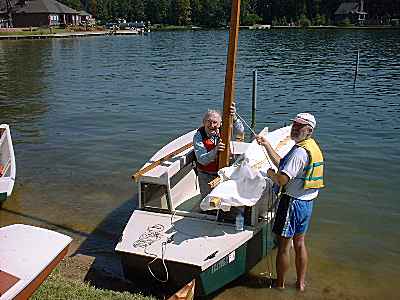

Ian Rogers built this pretty Family Skiff in England. Note that he used a daggerboard instead of the standard pivoting leeboard.

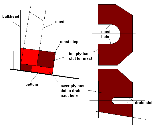

Mast steps vary but on smaller designs I prefer to use the solid chunk method. Well, almost. The mast shouldn't bear directly against the bottom of the hull, especially if the boat has no stiffeners along the bottom centerline. Why? Because the mast of a sailboat is almost always in compression, pushing down at the step and sometimes with a very large force. Also masts often rotate during sailing. So here is how I prefer to do the job:
What you see here is that the step is laminated in two pieces. The bottom bearing piece is usually 3/4" thick and the top piece is 1-1/2" thick. The top piece has the hole for the mast heel. You can cut it out with a band saw or saber saw usually. Same with the thinner bottom piece. The bottom piece should have, I think, a small slot to drain away any water that pools in the mast hole of the top piece. Cutting that drain slot is very easily done before the piece is attached to the top piece. Glue and nail the bottom piece to the top piece.
Now to install the step. Usually it fits into the intersection of the bottom and a bulkhead. Those two elements almost always meet at an angle. The step should fit right into that angle. Measure the angle on you hull and trim the front face of the step to match it. Fasten the step very well into the hull with lots of glue and stout nails or screws into both the bulkhead and the bottom.

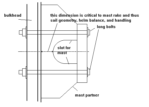

Mast partners vary even more than mast steps! Some are just planks bolted across the boat's wales with a hole through for the mast. Some are thick plywood plates bolted and glued to the fore deck. Most of mine are lumber pieces bolted to a bulkhead like this:
Almost all are 1-1/2" thick lumber. Sometimes the partner lumber has to be pretty wide to accept the mast hole or slot, but also to space the mast the proper distance from the bulkhead. That might seem trivial but it is quite important. The proper dimension here will ensure the proper rake to the mast, and that puts the sail in the right position fore and aft, and that gets the handling of the boat just right. So the rake of the mast is one of the sacred things about your boat plans. (On the other hand, if your boat doesn't handle right, you can tinker with the mast rake to try to fix that. Rake the mast more aft and you should increase your weather helm. Rake it forward will decrease weather helm.)
Usually a mast partner like this is made in two pieces because that is easier. The hole for the mast becomes a slot that can be cut with a saber saw instead of needing a large hole saw. All that is easy enough. The real problem is bolting it to the bulkhead because the bolts need to be long, usually longer than the common drill. Here is how I do it. Once the step is made I drill the holes for the bolts through the step while it is on the work bench. Then I put the step in position on the bulkhead and spot the holes on the bulkhead with the drill. Remove the step and complete drilling the bulkhead holes. Long bolts are required and I don't know if there is much harm in making the bolt holes 1/16" or so oversized so that precise fitting isn't required. Long bolts are required and tighten the nuts well so that there is lots of friction between partner and bulkhead. In my opinion, this mast partner assembly is no place for wood screws - use through bolts.

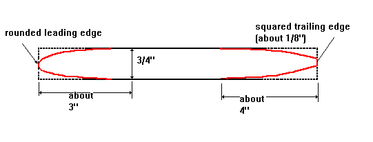

Trim the glued up leeboard blank to final shape. Then streamline the front and aft edges that will flow through the water. Don't just round the edges with a router bit. It doesn't have to be carved to a full airfoil shape but I would suggest something like this:
Here is how I do it. Clamp the trimmed blank to the workbench. Start the shaping on one edge with the coarsest rasp you can buy. As you carve through laminations you will find a nice line forms at each glue joint. Use these as indicators to keep your shaping true down the length of the edge. You will actually find it is fairly easy to do. When you get it roughly where you want it, smooth it all down with a belt sander. I don't own a power hand plane but would try it if I had one. I haven't found normal hand planes or drawknives to be very useful in shaping plywood - the rasp is my favorite tool here. Another useful tool might be a small disk sander with very coarse (20 grit!) paper in a drill.

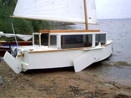

THE LEEBOARD GUARDS...
This is the only tricky thing about leeboards but I think it is still a lot simpler than any centerboard or daggerboard case.

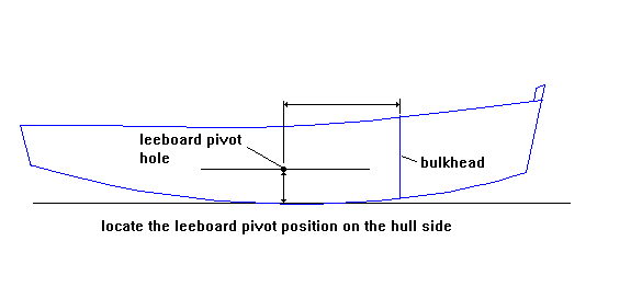

Here is the situation. The leeboard will be attached to one side of the hull, always at or very near to the widest beam of the hull. The leeboard pivots on a bolt that attaches to the lower leeboard guard. It will always be mounted such that it is parallel with the centerline of the boat. Usually it will be mounted vertically when the hull is lever, but not always - sometimes the leeboard is mounted parallel to the flared side of a hull. Is that bad? Most likely you would never notice the effect of the non-vertical leeboard.

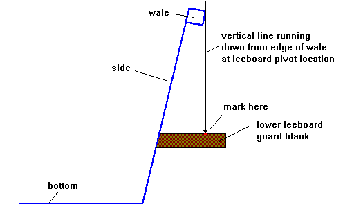

So the first step in installing the leeboard is to locate the leeboard pivot point on the hull. The sail rig drawing will show where the pivot is supposed to be, both up from the bottom, and fore and aft on the hull. Level up you hull and mark where the pivot point should be. Then mark where the lower leeboard guard should fall on the hull. Like this:

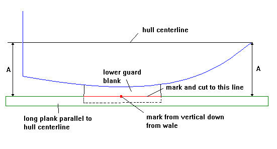

Now to make a piece of wood to fit there. Usually on a smaller boat the lower leeboard guard is made from a piece of 1-1/2" thick lumber. Start with a piece that is a lot wider than the final width. We will trim off the outer face to be parallel with the hull centerline later. The biggest challange will be to cut the inside face of the guard so that it will fit tightly to the side and yet account for the flare of the hull's side and mount perpendicular to the leeboard.
Here is how I have done that. First I place the oversized lumber guard piece right above its final location, right against the wale and scribe the shape of the side there right onto the guard piece. So I'm using the wale shape in that area as a guide to the guard shape. Then I set a saw (a bandsaw works fine but so will a saber saw with a good blade) at an angle equal to the flare of the side. Then I saw to the scribed line at that angle. It should fit! Screw it into position temporarily.
Next we need to locate the outer face of the lower guard such that the leeboard will be parallel to the hull centerline and be vertical. The leeboard will bear on the wale. Place a level on the wale right at the leeboard pivot location like this:
Now place a long straight edge on the guard piece such that it its edge falls on the mark determined above and parallel to the hull centerline, like this:
Mark that line. That is where the outer face of the guard needs to be for the proper leeboard placement. Remove the leeboard and cut the face on that line. Trim the leeboard to its final shape. Drill the pivot hole. Glue and screw the lower leebord guard into position.
