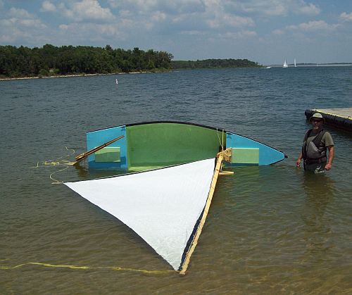

Gene Berry practices capsize with his Mayfly12 with the V bottom. It floats high and level but still took on too much water for reboarding until it was first bailed a bit. This is not at all unusual, you bail it swimming beside the righted boat until it is sufficiently emptied.
