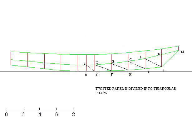

Now imagine that twisted bilge panel is divided into triangles like this:
You can imagine that you could form a panel this way to fill the gap between the bottom and side - the desired bilge panel. The first time I read of this was about ten years ago when Dave Carnell, who never throws anything away, presented a Sam Rabl essay on the subject in Boatbuilder magazine. I think Sam wrote the article in the 1950's and maybe it was a summary of how the work was done in shipyards in WW2. In Sam's day the work was all done on the old fashioned drawing board.

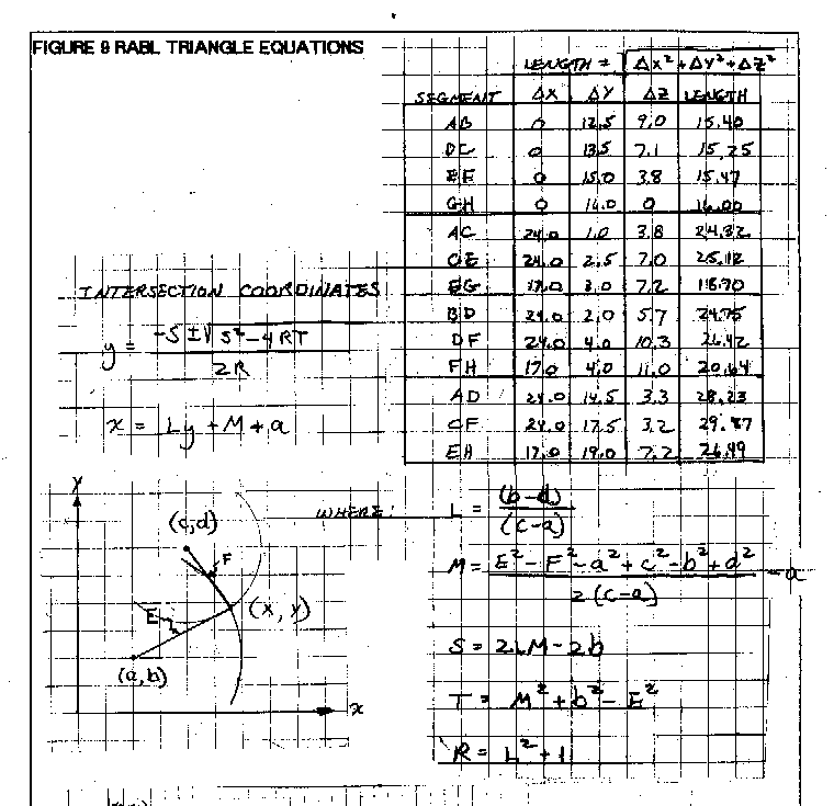

Here is how it works. You have your three view line drawing available and you divide the desired panel into triangles as shown above. You label each intersection and using your table of offsets or by measuring the lines drawing you record in xyz coordinates the location of each intersection. Now, if you know the xyz location of each intesection you can figure the true lengths of all the lines between intersections. Once you know the true length of each line you can draw each triangle in its true flat pattern shape. In this case shown above you would start with the line AB and swing arcs to determine the location of D to get the true shape of triangle ABD. Then knowing the lengths of AC and DC you swing two arcs to find the location of point C to get the true shape of triangle ADC. And so forth, each triangle building on the previous until you reach point M. All of this on a flat piece of paper and the resulting construction is the true flat panel shape of the bilge panel.
Well, almost. Since the real panel is curved and the constructed panel is in segments of straight lines there will always be a bit of error in that the straight lines are a tiny bit shorter than the arcs. If your triangles are small enough or the curvature of the panel is small enough there is no error here that amounts to anything in real life.
Remember that Sam was doing this on a drawing board, including figuring the true lengths of the individual lines. Phil Bolger told me that he tried the method on one of Payson's taped seam multichine designs and Payson told him the resulting panel shape was way off so Harold cut a panel to fit the real boat and revised the panel dimensions to suit. When I tried the method I could see from a scale model that it wasn't working so well.
Here is how I figure the drafting problem. If you start the construction by drawing points AB, say they are 15" apart, and work forward to M, say 90" forward, then any error in locating the first points is magnified about six times by the time you get to M. If you were working in full scale an error of .02", the width of a pencil line, would produce an error of about 1/8" at the tip. That might be OK. But if you are working in say 1/10 scale, that .02" error at the start would put your end point off by maybe 1.2" and that clearly is not good enough. And all the while you are working forward on the construction you are trying to set a compass to great accuracy, etc., all the errors will quickly get out of hand. I suspect Sam was working on big ships and maybe with full scale drawings. What to do?
About that time I got my first used computer, an Apple 2c. I dug through my old math books looking for equations that will define the true shape of a triangle. I don't want to tell you how long it took me to figure this out but this is what I came up with:
In this old example we have two points, one with coordinates a,b and the other with coordinates c,d. From point c,d we swing an arc of length F and from a,b we swing an arc of length E. Those two arcs intersect at point x,y and that is what we are looking for. The two equations in the upper left for x and y require you to solve first a bunch of factors shown in the lower right. Computers are really good at figuring this sort of stuff, even my Apple 2c would spit out the answer in a nano second.
To simplify things a bit I always chose the first two points to be one directly above the other. Well almost. In fact one can't be exactly above the other because in that case the computer will try to divide by zero when it figures the factors and it will get totally confused. So I missplace one point by .001" and the machine is quite happy to plug along.
With the Apple I would first figure the line lengths with a hand calculator as you see in the upper right of the old example, then plug the numbers into the Apple to figure the x,y coordinates of the third point of the triangle. Write that down and go on to the next triangle.

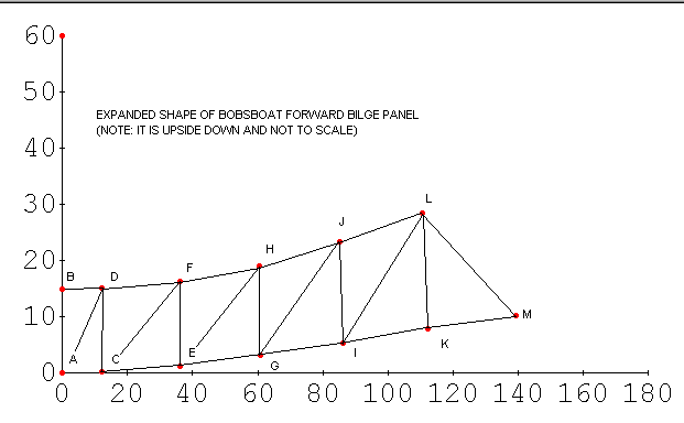

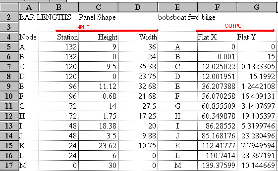

As I got more sophisticated in my used computers I eventually came up with a spreadsheet in MSworks that would do that for me up to sixteen triangles at a time. The machine works to a huge degree of accuracy and the problems of working with the drawing board all go away. Then it just becomes an issue of inputting the offsets correctly. Here is a portion of the results of the Bobsboat forward bilge panel.
The offsets are input on the left and as you type them in the machine figures the flat panel layout on the right. If I am not using all the input spots in the spread sheet, say I have 13 triangles to plot instead of 16 allowed in the sheet, I type in convenient numbers in the blanks which sometimes results in "error" messages generated by the spreadsheet output but they are of no consequence. Then I ask for an xy chart of the results to see if it looks right, a quick check on my input. For the Bobsboat bilge panel it looks like this:
Now if you draw the xy results on your drawing board to reconstruct the triangles, and thus the true shape of the twisted panel, you will have acceptable accuracy. All of your points will be measured from the same base lines, you won't be piling errors on errors. If the input is correct, this method has always worked for me.

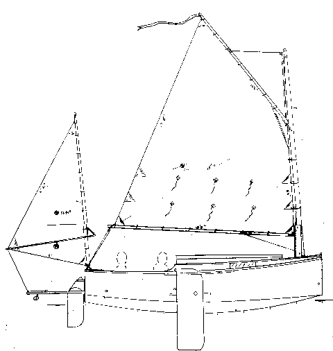

Picara is 18' long where Fatcat2 was 15' in order to get a cabin that two people might really sleep in. There is a small anchor well ahead of the cabin, a raised deck aft of it, and a motor well in the stern. I used multichines to get a hull that can handle rough water better than a flattie. That makes it a taped seam project. She needs nine sheets of 1/4" plywood, six sheets of 3/8" plywood, and seven sheets of 1/2" plywood. The resulting pile of plywood would weigh about 800 pounds and I would expect the empty hull to weigh about that. Add 500 pounds of ballast and you have about 1300 pounds on the trailer. The wide deep hull can handle that and it takes a total weight of 2500 pounds to set it down 10" deep so its chines touch the water.
As for the sail rig, I used a gaff sail to get good area from a short 17' mast which pivots on a tabernacle and stows within the length of the trailered boat. I added a small mizzen for balance and provide steadying at anchor or during sail changes.
