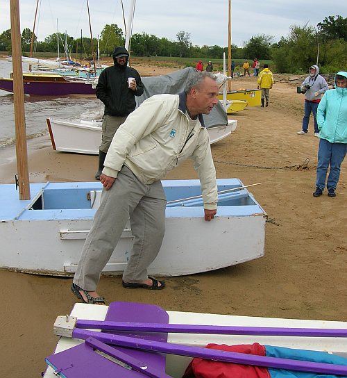

...Richard walked down the line of boats at the meet, maybe 20 or 30 there, and one by one discussed the good and bad points of each boat with regard to capsize recovery. It was sort of cruel, although Richard is likeable and jovial. He didn't ask "whose boat is this?" or anything, just lit into each one. He was going to capsize test a boat to demonstrate the details of recovery and was chosing a subject as he did this. But this is when the real knowledge came out as he discussed details that would make a boat better for recovery.

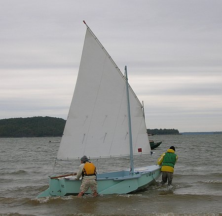

At the time we had a strong onshore wind with whitecaps and no one was boating voluntarily. But Richard pointed out those things were ideal for testing, giving a chance for a real capsize and a fetching up on the launching beach if the recovery failed. It was cold as you see in the photos, no more than 50F, although I'm sure the water was warmer. Richard told of breaking ice in England to give capsize lessons so he was not deterred and no special suits were worn.
He chose Stan Roberts' nice new Family Skiff for the demo, saying it probably had the emergency buoyancy needed and also had the high sides that would make for a good "high sided boat" demonstration to show us the of the special rigging he was suggesting. He removed the mizzen to simplify things a bit. Family Skiff was designed without the mizzen so it would still handle well. Richard pointed out that although the mizzen was a complication on the stern that might need watching in a capsize, it also would provide more strong handholds for reboarding.
The Family Skiff had no motor mounted so the cut down area for the motor was open and Richard immediately rigged a stirrup for reboarding there. So if the outboard had been mounted the reboarding process would have to be rethought. He also rigged a rope running the length of the cockpit as a grab rope to be used when coming over the side, if needed.

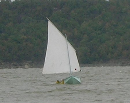

After the lecture and rigging of the emergency ropes, off they went into the blow....

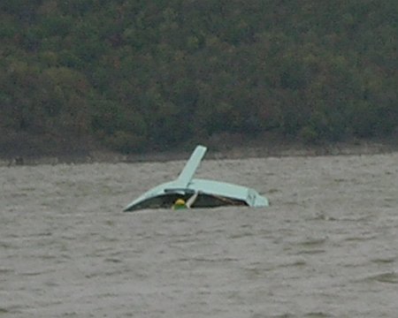

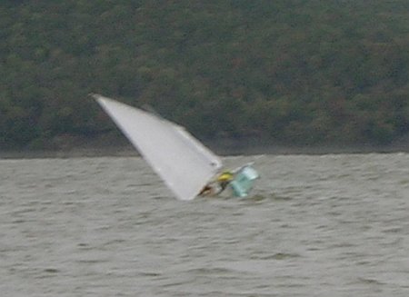

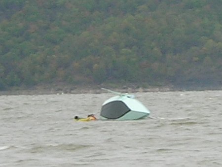

A half mile or so out they forced a capsize (pretty easy given the wind)...
It nearly turtled, which surprised me since the lug rigged boats I tested long ago never would turtle because the buoyancy of the wooden yard would hold them sideways. It might have gone full turtle since it was felt the mast had struck bottom preventing that...
They had capsized it with leeboard up high on purpose so that would not be used to right the boat. Richard grabbed the painter (bow line) and held it aft while Stan put his weight on it to lever the boat (slowly, be patient) upright. But a designated line just for this should be secured, with easy access by the swimmer, just for this.

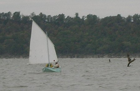

Once upright, Richard swam around to his recovery stirrup and got back in the boat at the stern.
Then I believe he helped pull Stan over the side, I've forgotten (if I ever knew)...
Then they sailed back easily. The whole process seemed fairly reliable and somewhat quick. I was impressed.

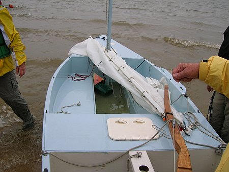

Once back on shore we had a peek at the carnage...except there really wasn't any. There was very little water inside and the did no bailing to return.
