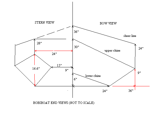

Let's take a quick guess at its displacement using the prismatic coefficient method discussed last time. We will put the draft at 9" which is where the chines and stern will start to immerse. I would expect the boat to go fairly well up until that point, then it will slow dramatically. Here is the endview:
First we will construct a "prism" with a length as long as our waterline when the draft is 9". I will estimate that as 18'. Then the prism will have the same cross section as this boat's maximum underwater cross section. So that cross section will have as shown above a bottom 4' wide and a top 6' wide and a depth of .75' deep (9" draft). That cross sectional area is .5x(4+6)x.75=3.75 sq ft. And the total prism volume would be 3.75 x 18 = 67.5 cubic feet. Now apply a "prismatic coefficient" of .55 as discussed in the last issue and we would estimate a max useful displacement for Bobsboat of 67.5 x .55 = 37 cubic feet of water, which is 37 x 62 = 2300 pounds.
That I think is quite a lot. I would at this time estimate an empty weight of the hull at perhaps 500 pounds and maybe another 100 pounds for the motor. Add four adults at say 700 pounds total and you are looking at about 1200 pounds total. So there is quite a surplus. One thing I must remember is that this boat is to have its motor mounted inboard in a slot that will eliminate a triangular shaped volume of water that is 4' long, maybe 2' wide, and 9" deep which eliminates about 180 pounds of displacement. Anyway, the important point is that we have enough and if someone wants to take on more folks the boat will handle it.

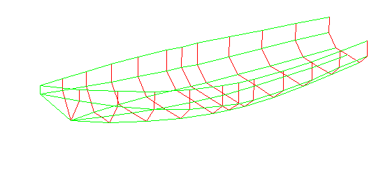

So I go back to the line drawings that I made a few issues ago and measure offsets at every two feet, plus another set at station 11 of this 20' hull so I have a section at the hull's maximum beam. Then I call up Hullform and start a model and start plugging in those offsets. Eventually you will get pretty good at it and be able to knock out a useful model in a half hour or so. Here is my Hullform model of Bobsboat:
Looks like a boat to me. The graphics will show you big goofs in your offsets but maybe not small goofs. I'm not sure how fine the grid needs to be but I'm quite sure that having ten or so stations is plenty to get a good handle on the numbers. I did not model in the motor slot but I'm sure it can be done. Hullform was I think meant for serious ship design and is not challenged much by this small boat. The version I use most was written for DOS, that is it is older than Windows. It runs very quickly on any computer. I would suspect the newer versions require more power and have a lot more graphics.

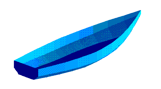

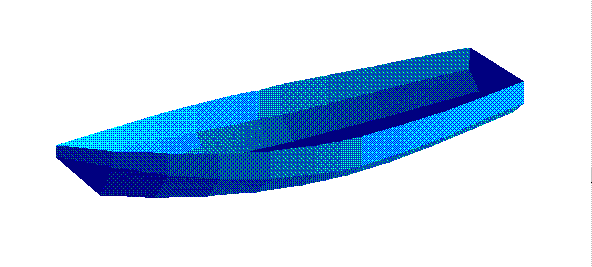

But even the free demos will allow you to see your hull in three dimensions, even will shade things to a certain degree, like this:
And this:
Still looks like a boat to me and I see no need to change anything.

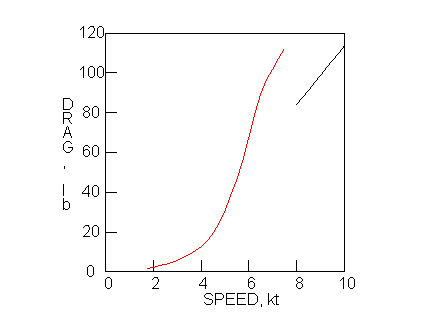

that I noticed in the newer demos is the ability to give a chart of drag/speed for your proposed hull. I'm don't really know the source of the math behind the estimates. You may recall that a couple of years back I built a "Thrustometer" and measured the thrust of a few of my outboards while they were pushing my AF4. Then I compared those thrusts to the Hullform estimates. The comparison was OK, a good starting point I think. Here is the proposed chart for Bobsboat:
When I look at this I see what all slow speed hulls experience - a "hull speed". As you see, drag rises very quickly at about 5 knots. The usual estimate for "hull speed" in knots is something like 1.3 times the square root of the waterline length (in feet). So if we had an 18' waterline then we would estimate 1.3 x sqrt18 = 5.5 knots. And the above chart sort of agrees with that. I'm not sure if we have gained a lot of new information but it is worth while to look at. Hullform will make curves for a range of weights (the above is for 1200 pounds).
Some day I'd like to be able to use the above charts to get a handle on horsepower requirements, a task we tried back with the Thrustometer. If you look at the above there would be a temptation to say, "Hey, a 30 pound thrust trolling motor will push this at 5 knots." And that might be true. But in any breeze the wind drag will quickly outrun the water drag and you will get nowhere or go backwards. From my experience with Birdwatcher, the answer to powering all boats like this is that you need between three and five hp. BW went 6mph with my 3.5 Clinton wide open and about 6mph with my 5.5 Johnson wide open. From the above chart you can see why - the slope of the drag curve is so steep at the "hull speed" that a lot more power gives only a little more speed. That would be true until the boat starts to "plane". In the above chart you see the black line which is the start of the planing line. Somewhere in between the red line and the black line there is a transition. But a hull with a fine stern like Bobsboat or Birdwatcher really won't plane well at all as far as hull trim and controlability are concerned and you should not think of planing that type of hull. The extra power of the 5.5 on Birdwatcher has a real advantage in that I can run at say 4knots at a whisper quiet third throttle in calm conditions and still have some extra to fight the bad conditions.

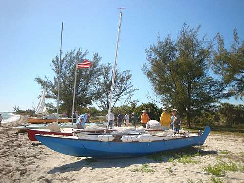

And Gary Blankenship's Frolic2 completed the Everglades 300 mile challenge with him reporting sailing for hours at 7 knots or more. Last count he completed five of the challenges with a 4th overall in 2007 and 7th in 2012. Here is Gary's Frolic2 on the launch pad just before the start. Note the row of fenders mounted on the cabin to be used as beach rollers but also as capsize protection since boats like this can swamp if the cabin is not well corked and there is weight forward.:

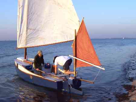

I should add that the little mizzen is Gary's addition and is quite valuable on a long cruise, and by my experience usually a bother for a short daysail. Although Gary has never used a motor on his Frolic2 he still retains the well and saw no need to change the offset rudder.
