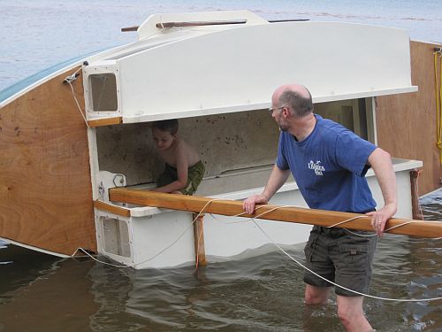

Andy Wallis & Co. capsize test his IMB. She is trying to self right and note that he is pushing down on the mast to prevent that. You can see why I think this Bolger invention cabin has a lot of merit. There is no ballast other than the weight of Andy's young replacement and she takes on no water when knocked over.

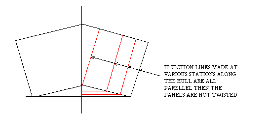

For some reason, and don't ask me why because I don't know, you will get a nicer looking boat, at least in terms of a plywood boat, if all the lines in the end view are straight. Once you think that you sort of design things in reverse. Normally you might draw a pretty side view and then a pretty top view and then way down the road construct the end view from those two. But now I often start by drawing the end view, all with straight lines. Then you might add a top view and then the side view but by then they have become the slaves of the end view. Look at it this way: If you have the end view nailed down and draw the sheer line in the top view, the sheer line in the side view is already determined. Etc. I suspect the reason the end view all of straight lines gives a better looking boat is because it prevents you from getting too kinky with the other views. But you can tell a lot more just by looking at the end view.
If the section lines of the hull are all parallel when presented in the end view, then the planks that make the boat have no twist. This is one issue that you will need to force into your design if you are to avoid twisted planks. If the planks are not twisted then the boat will be easier to build. But maybe more important, if the planks are not twisted you will be able to determine their shape before the boat is built by conventional drafting.

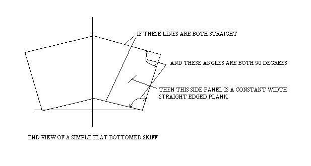

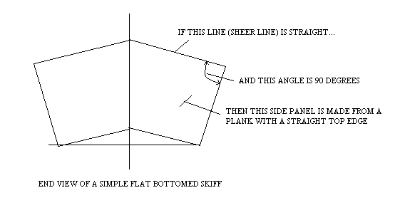

Next, if the sheer line in the end view is straight, and the section lines of the side are perpendicular to it, then you know the plank that forms the sheer, the side panel in say a flat bottomed boat, can be cut with its top edge straight. That usually saves labor and materials but I found is not a major driver in a design. Like this:
And if the other hull lines are perpendicular to the section lines then those lines will become straight lines when you go to cut them to shape in a prefabricated design. Like this:
So that is how a boat like Bolger's Teal, curved in all ways, is designed from the start with side planks that are constant width and all straight lines. Panels like that sitting flat on the floor don't look like much of a boat, but when bent around forms with flare they end up with rocker and sheer sweep and all the elements of a sweet boat.

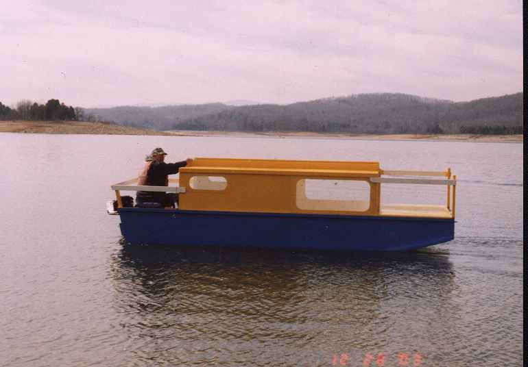

SHANTEUSE, SHANTYBOAT, 16' X 6', 700 POUNDS EMPTY
Shanteuse is a slight enlargment of the mini shanty Harmonica. Shanteuse is 1' wider than Harmonica and has a 3' extension on the stern to allow a small back porch and a motor mount that is totally out of the living area.

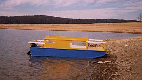

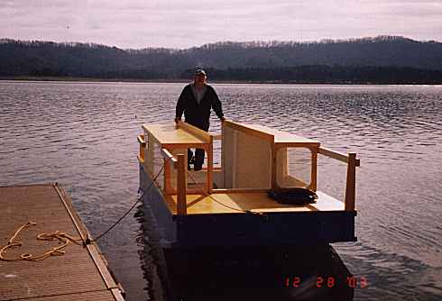

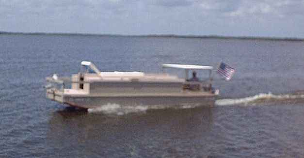

Above is a Shanteuse built in Florida by Vince SantaMaria a couple of years back but he stretched his to 24' so I couldn't really call that one a Shanteuse. But here is one by Douglas Snelson in Tennessee that looks to be right to the plans so I will call this one the prototype. He sent a bunch of photos:
I've also made Shanteuse a little heftier. I'm thinking this one will weigh about 700 pounds empty where Harmonica comes in at around 400 pounds. I'm not sure if the extra beef is needed because Harmonica seemed totally adequate to me as far as strenght and stiffness go. But the extra size of Shanteuse is probably going to take it out of the compact car tow class. The plywood bill for Shanteuse looks like six sheets of 1/2" plywood and eight sheets of 1/4" plywood. I would not use fancy materials on a boat like this and am reminded of Phil Bolger's warning to never spend a lot of money building a design that was intended to look cheap. I see pine exterior plywood at my local lumberyard selling for $11 or a 3/8" sheet and this entire boat could be built of it. So the plywood bill would be less than $200 and I'm thinking the entire bill less than $500. The pine plywood looks quite good to me, its main drawback being that it doesn't lay very flat.

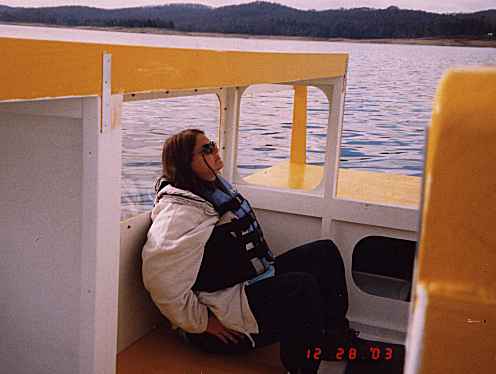

These boats can be very comfortable to camp in. The interior volume and shape are not unlike the typical pickup camper or the volume in a full sized van. It's not huge, it's cozy. The top has an open slot 28" wide from front to back on centerline. You can close it over with a simple tarp, leave it open in good weather, or rig up a full headroom tarp that covers the entire boat. I've shown lots of windows but the window treatment can be anything you like. You do need to see out. I would be tempted to cover the openings with screen and use clear vynal covers in the rain or cold. For hard windows I think the best material might be the Lucite storm window replacements sold at the lumberyard. Easily worked, strong, and not expensive.
As for operation, these are smooth water boats. So it is best to stay on small waters that never get too rough. On bigger waters you need to watch the weather very carefully. For power I would stick to 5 or 10 hp but I'm very much a chicken about these things. To plane a boat like this, remember the good old rule of a horse for each 50 pounds. So if you are running at 1000 pounds total you will need at least 20hp to do the job and then at full throttle. So I think you would want at least 30 hp to plane at 2/3 throttle. And this boat could easily be loaded to over 1000 pounds.
