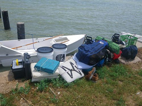

Chuck Pierce's Mayfly14 poses with all the gear it swallowed for the five day TX200 a while back. Not sure where Chuck put himself.

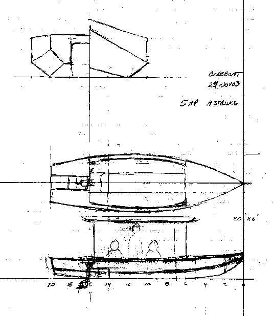

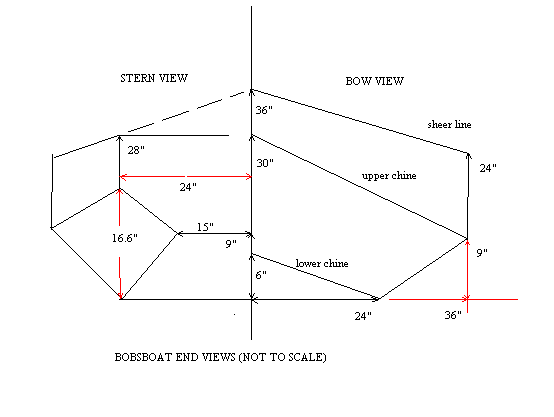

I'm going to start by putting hard dimensions on the drawing of the end view. A lot of this is arbitrary but based on experiences with past similar boats. The size of the boat is based on what it's mission is: lets' say take four adults in relative comfort at slow power speeds, say with a new 5hp four stroke motor that will be quiet and fuel efficient. Four adults will total maybe 700 pounds and that motor another 100. The hull of something like this will weigh maybe 400 pounds so the total I would like to float with good lines (ie the ends and chines of the boat, all the sharp corners, will be out of the water) will be about 1200 pounds. The next web page issue will show how to check this.
Another goal will be that the planks will not be twisted. This will mean that section lines of a plank in the end view will be parallel. But I'm going to break this rule in the bow of the bilge panels and allow some twist. I'll explain why later.
And finally as discussed the last time I'm going to show all the lines in the end view as straight lines. Like this (this drawing and others will not be to scale but the dimensions shown were figured on the paper drawing):
Just some general notes about the layout. The top width and depth is to give comfort and spread out room for the adults with some wide bench seating. The bottom width is at 4' to fit on a sheet of plywood, it could be narrower but I see no need for that and the wider the less tippy. The transom width is at 4' to fit on plywood also, it could be narrower but this boat is supposed to have its motor mounted in a wide slot so width might be important here. The stern is swept up higher than I expect will ever be needed to keep the transom from "dragging" through the water at this boat's slower cruising speeds. Same with the height of the bilge panels. But in the bow bottom I swept it up less with the idea that it will push through the water a bit and stay quiet. Bows like this work quite well if they are not swept up at all, by my experience. And by my experience a boat shaped like this can take quite an overload and still go well, unlike a plumb bow boat.
The sweep of the "sheer" on the bow and stern are also quite arbitrary in a boat like this. It is mostly for looks and I suppose the boat would go just as well if the sheer were dead straight but most folks would think that ugly. You could also sweep it too much and make it ugly, I think. This is one area where only a model can tell you how it's gonna look, although some of the new boat modling software will take a good stab at a pictorial representation.

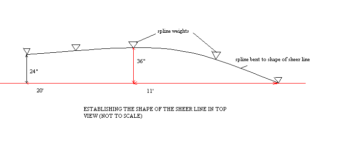

Here is how I would do that: First determine where the widest point of the boat will be. Hint: If you put the widest beam at 55% of the length you will end up with a normal looking boat. That is where I am going to put it on this 20' long hull - at 11' from the bow. (I'm reminded here of Phil Bolger's argument that the bow of your boat should be a little faster than the stern - otherwise the stern will on occasion try to pass the bow and that ain't good.)
So now I have three points of the top view of the sheer determined, the bow tip, the widest point and the stern flat. On the drawing board I lay out those three points and spring a batten through them using just three spline weights, like those shown in black. After those points were established I found I had to add other weights as shown because the natural curve of the batten wanted to spring outward beyond my 55% point and I used two more weights to spring it back into position. Like this:

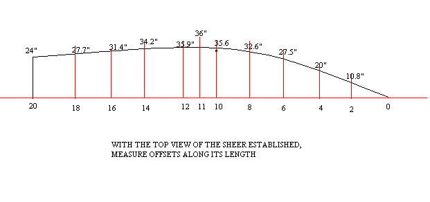

That done I take dimensions of the sheer's width say every two feet to sort of "digitize" the curve of the line. Like this:

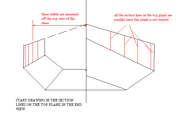

Let's go back to the stern and find all the points needed to draw the side view. First use the top view to take note of the width of the hull at various stations. Then draw those stations in on the aft end view, like this:
Now at each station you can measure up from the base line and determine the height of the sheer and upper bilge panel in the side view. You can spot them onto the beginning of a side view in that area.

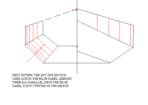

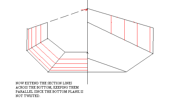

But since there is no twist in the panels in the stern we can also draw the lines that represent the bilge panel in the end view, like this:
Connect those bilge lines across at the bottom panel and you will get the width of the bottom panel at each section.

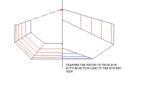

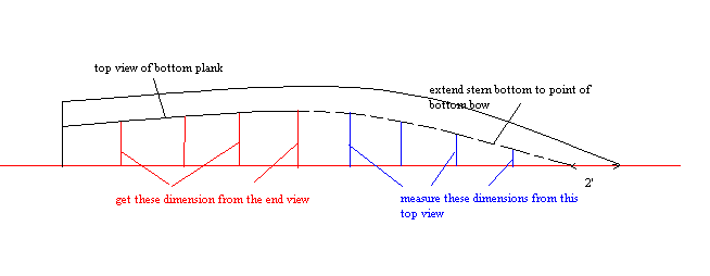

At this point you can go to the top view again and draw in the bottom plank, at least in the stern. In the region of the bow I will extend the bottom plank smoothly to a point 2' from the bow as shown in the original Bobsboat sketch. Like this:
Now we also can measure the widths of the stations along the bottom plank in the bow region and transfer those to the bow end view, like this:

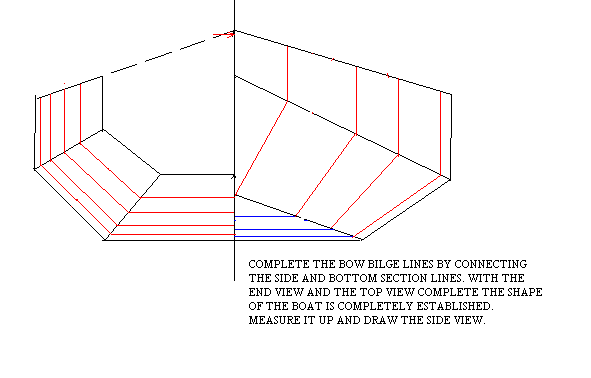

Then we can fill in the remaining section lines in the region of the twisted bow bilge planks, like this:
All the thinking is done. With the top view complete and the end view complete, the side view dimensions are all there. Just drawing it remains. The "lines" of this boat are done.
