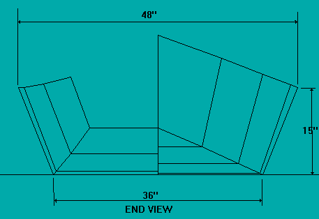

If we wanted a different cross section than the simple box shape I'm assuming here, we would have to tinker a bit. Draw up a cross section with the 1.38 square foot cross section and see if we like it. Actually in this case I'm going to flare the sides out to 4' at the top of the wale at the cross section. But that won't affect the area under the waterline much. We might sketch out something like this:

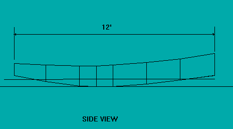

This method of the "curve of areas" is an accurate and flexible way of determining the volume of almost any oddly shaped thing. It's actually pretty easy to do but first you need a drawing of the proposed boat (unlike the prismatic coefficient which just needs a general idea of the boat).

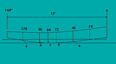

Let's take our proposed boat and draw a line on it that represents 5.5" draft, our guess at what is needed to float 470 pounds. Every now and then along the length of the hull we take cross sectional cuts of the hull and measure the area at each cut below the 5.5" waterline. The cuts can be taken anywhere but there must be enough to get a good definition fo the hull. Actually for a normal boat about five cuts will do. The more you take the more accurate your work but five will get you really close. Our example boat might be like this:
sections1

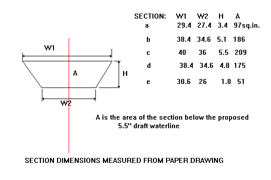

The dimensions of the underwater sections are measured right off the paper drawings and the area of each is calculated like this:
sections2

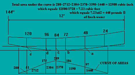

Next we graph those underwater areas spacing them the same distance apart as they are on the real hull to get the "curve of areas" like this:
curve of areas
The area enclosed under the curve of areas is a volume and is indeed the volume of the underwater hull - it's what we are looking for. In the old days you would measure the areas with a planimeter, a clever and expensive gadget. But you can do well by just breaking down the curve into triangles and trapezoids, figuring the area in each trapezoid, and adding them all up. In the example, second trapezoid from the left is figured by 1/2(175+209)X12 = 2304. Adding the sections together gives us a total of 12500 at 5.5" draft. That equates to 450 pounds of water. So the first guess was off by 20 pounds or about 4%. By the way, the drawing showed a waterline length of 9'5" instead of the first guess 10'.

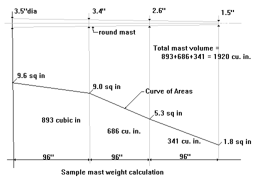

As mentioned before this method can be used to figure the volume of almost anything. Let's say we wanted to find the weight of a mast. Say the mast is 24' long, 3.5" in diameter at the base and 1.5" in diameter at the top, with a curved taper between. The figuring of the volume might look like this:
1920 cubic inches equals 1.1 cubic feet. Wood usually weighs 25 to 35 pounds per cubic foot. At 30 pounds per cubic foot the mast would weigh 33 pounds.

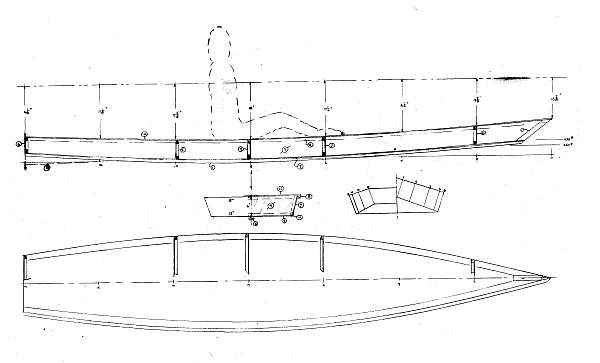

PADDLEPLANK, PADDLE BOARD, 14' X 32", 70 POUNDS EMPTY
Can you walk this plank? Actually the request was for a stand up paddle board, sort of like a surf board that is paddled while you stand up like on a real surf board shooting the big waves in Hawaii.
I had all sorts of reasons for not designing it, the first being that I could never stand up on such a thing myself for more than a second or two. As a starting point I decided to take the bottom of a light dory, which is usually about this length and about 2' wide. It is generally held that you should never stand up in a light dory and my experiences confirm that. But it looks like the surfers are well ahead of us mortals in that respect and besides they expect to get dumped regularly and maybe the long double paddle offers a bit of stability, sort of like the poles the tightrope walkers use.
So I started with that bottom and added a little top, maybe 4" of freeboard which will not keep you very dry. I put just enough rocker to support 470 pounds before the bow and stern start dragging, enough for two people plus the weight of the hull usually. I can't see two people standing up on this at once but if they both sit it might be a fun wet boat for warm waters. The deck is supposed to be totally watertight, of course, so it will shed water like a duck and be low enough in the water for a swimmer to reboard.
I knew from the start it would not be light, at least not light enough to carry under one arm as they did in "The Endless Summer". Bolger had warned all of us long ago that decks weigh a lot, more than the bottom he said because they must be strong enough to take your weight with no water underneath pushing upward. So Paddleplank will indeed weigh about the same as a light dory. I figure 75 pounds if made with the usual 1/4" plywood, maybe 15 pounds lighter if the topsides are made with 1/8" ply. You can't really go thinner than 1/4" on the bottom and you need some thicker area where you stand, so it is hard to make it much lighter.
I wondered a bit about how Bruce Brown carried his surfboard around under one arm. Sure, he's a big hunk but even so there were expensive tricks involved. Let's say you need to float a 180 pound man on a board. Light wood weighs over 20 pounds per cubic foot, so if you totally immerse a cubic foot of that wood it will have about 40 pounds extra buoyancy, given that water weighs about 60 something pounds per cubic foot depending on where it is from. So you would need about 5 cubic feet of wood to float the man, or at least 100 pounds of solid wood. But then he would be just awash, so to give an inch or two of freeboard to go surfing would require even more. I suppose that is the situation with old time historic surfboards.
I googled around some surfboard history. The first hollow boards were made about 90 years ago and they first broke the 100 pound barrier, so my guess was pretty close. Then they went to balsa cored boards (Hey! Balsa is really a hardwood!) and got down to 60 pounds or so. Then post WW2 they went to fiberglass and foam, etc.
Anyway, after the google, I stopped feeling guilty about the weight of Paddleplank.
I'm thinking Paddleplank is too wide for a real surfer dude but would be a good plaything for the rest of us.
Three sheets of 1/4" plywood with the chines done with taped seams. I have it drawn for jigless construction but you might not get away with that since the sides will be so thin and limber. Thus I have also shown some dimensions to a "base line" so you could set up the initial construction on a ladder frame to hold it all true until the bottom is on.
