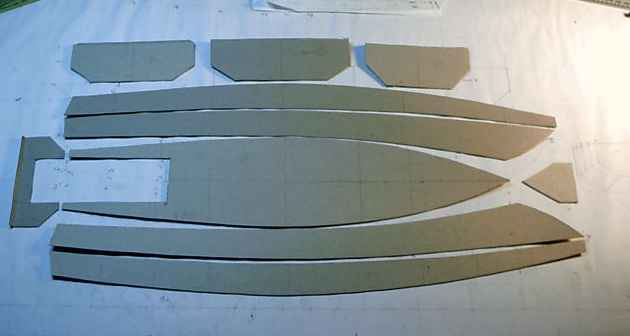

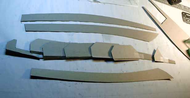

Next the scale panel drawings are placed over card stock and the shapes transfered to the card with pin marks right through the paper to the card. The pin marks are then connected on the card to reproduce the shape. Errors can creep in here pretty quickly but remember the original shape drawings are not changed. In this example I used heavy card stock that came in packages of blueprint paper but one of my favorite materials for a model is the thinner white card used for posters and such that I find at the drug store. After I get the shapes onto the card, I cut them out like this:
As with the real boat you need to mark the parts with centerlines and the locations of bulkheads and forms. This is just like building the real thing at this stage. You can get a quick check of your expansions by looking to see if joining edges all have the same lengths. Because of the scale and all the transfering of lines the model won't be as accurate as the real thing.

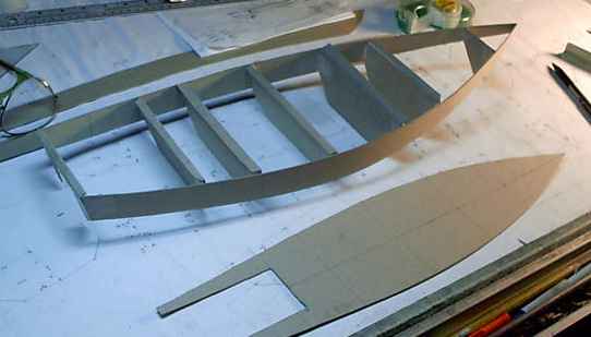

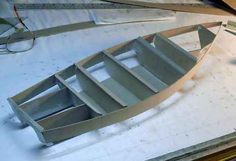

The assembly is not like building the real thing. On the real thing I would screw the sides to the center form and install the other bulkheads and forms by pulling the ends in with ropes and adding the elements one at a time. With a card model I tape all of the cross elements to one side at first, like this:
Then working from the stern I tape the cross elements to the other side and by the time I get to the bow I have the makings of a boat. Like this:

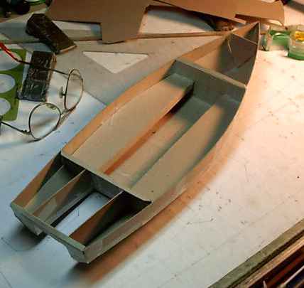

It will still be wobbly but taping the bottom to the cross elements will stiffen it up a lot, as it will with the real boat. I also added the panels that will form the walls of the motor well (by the way when I measured up my motors I found it takes a well 2' wide to allow the motor to turn fully.)

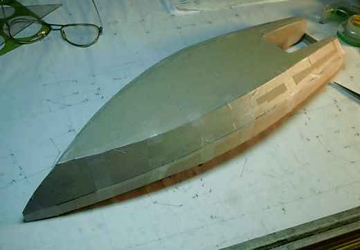

Now we will tape in the bilges. Usually the hardest part of the job, as it is with a real boat. I start by taping it in the middle of the boat, then work out to the ends. Takes a bit of time. If there is an error in the shapes you will notice it here. I thought the Bobsboat bilges fit pretty well and think the expansions are correct:
Next flip it rightside up and install some seats:

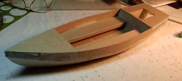

And then some decks:
Looks like a Bobsboat to me! Sometimes at this stage you will see things that you might want to change. I have been doing this for about 15 years now and one thing to watch out for is the proportions. Hard to see that as well in a computer rendering. In particular I have found the fore deck needs to be longer than you might first draw in a three view. I have this theory that your eye can quickly gauge the volumes under the fore deck and the stern deck and wants them to be equal for some reason. In a boat with a square stern and a pointy bow, that bow deck will look better if it is longer that you might first suspect. Anyway, I see no need to alter the Bobsboat. That stern well is looking quite large but right now I see no other way to do it. If you make it narrower you can't swivel the motor fully. If you decide to plate in the bottom opening leaving just a small hole for the motor you won't be able to raise the motor up without resorting to a lot of claptrap. As speaking of traps, if the water gets trapped there while the boat is in motion, the water level in the well can raise alarmingly, maybe right over the bulkhead into the boat depending on the speed and waves. How high can it go? On Birdwatcher water will spurt out of the top of the centerboard well at most any good boating speed and in a chop it will shoot right out the top of the boat! Imagine sitting next to a washing machine running with its lid open and you get the idea. So with Bobsboat I'm keeping it wide open on the bottom and stern to let the water flow through and out. I hope.
At this point it is a good idea to look for "soft spots" in the structure. Not sure but with Bobsboat a partial frame in the center of the cockpit might help stiffen the bottom up, always a problem with a long open cockpit. But if you are clumsy you will trip over it several times a day so a valid approach, especially with a prototype, might be to build the boat without with the idea of adding it if bottom flex is troublesome to you.
Finally, take your model and try to twist it. If it twists easily so will the real thing and that ain't good. This is a problem mostly with square ended open boats like jonboats. Best solution is to box in the ends with decks as done here.

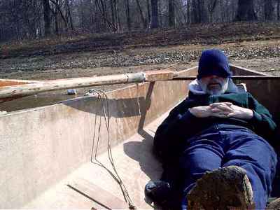

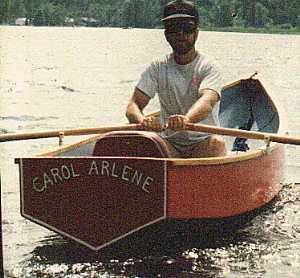

These are excellent camping boats, light enough to solo cartop, large enough for much gear and with a flat bottom plank long enough to sleep on while the whole rig sits upright. Kevin Garber took a Roar2 on a three day row of the Big Bend region of the Rio Grand, seeing no humans from put-in to take-out. He brought a folding chair, a barbacue, and a tent fly with poles. In camp he set up the fly over the hull and slept in the boat. Here is a photo of me in my old prototype (still use it) demonstrating proper nap position:

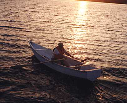

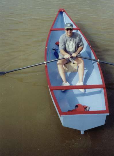

I have found some more photos builders have sent. I'm sure I've forgotten where I've stored others. Here is Charlie Ballou rowing off into the Massachusetts sunset:

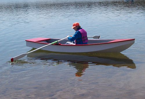

Here is Greg Rinaca in Texas:
I think this is Lincoln Ross but I'm not sure:

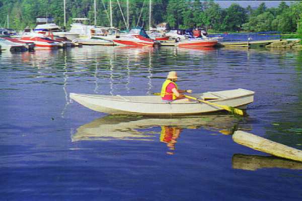

And Brian Walker in Canada:
