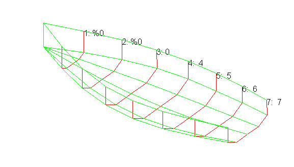

We can write the basic balance as the sail force S = W x D / L where W x D is the "righting moment" of the hull and D is the distance between the center of the sail area and the center of the leeboard (or keel or centerboard, etc.) area. W is the total weight of the boat with everything on board. L is often called the "righting arm" and changes as the boat rolls and is fairly difficult and tedious to calculate. But the free program Hullforms can handle it. To use Hullforms one must first model the hull in three dimensions. In the last issue we showed the model for Picara but this essay will focus on smaller boats. This is my Hullforms model of the 14' boat Ladybug:

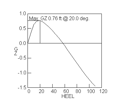

Given the hull lines and a weight/center of gravity information Hullforms will calculate the value of L and graph it for various values of heel as when the hull rolls. Here is the graph for Ladybug at 400 pounds weight and with the cg 24" off the bottom. This is about the lightest I would expect a loaded Ladybug would sail at complete with a minimum crew. I took a stab at the cg location.
Here Hullforms is calling the righting arm "Gz" instead of "L". The maximum value is .76' so the maximum righting moment of the lightly loaded Ladybug would be .76 x 400 = 304 ft-lb.

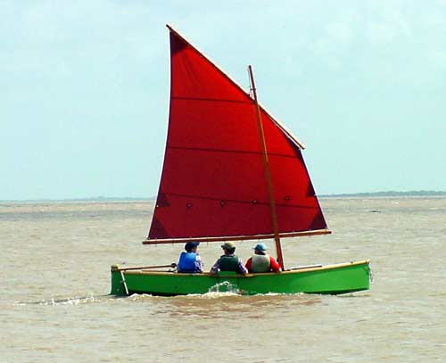

Here is a picture of Ladybug's sail rig:
The distance between the sail area center and the leeboard center is about 9'. So if we solve for the maximum allowable sail force we would get S = 304 / 9 = 34 pounds. If the force on the sail exceeds that amount then the lightweight Ladybug will roll past the point of maximum righting moment (at 20 degrees heel according to Hullforms) and continue to roll until the force on the sail is relieved.
Ladybug's sail area is 74 sq ft so the average pressure on the sail at this condition's capsize point is 34/74 = .46 psf.

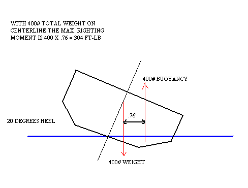

Anyway, the the above case has its weight centered on the hull because that is how Hullforms does its math. At the point of maximum righting moment the situation with Ladybug would be something like this:

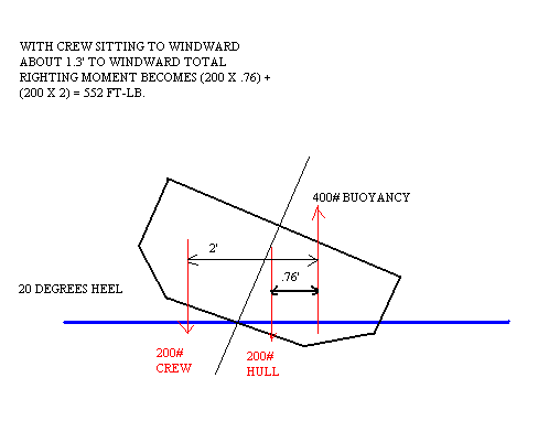

Now let's take the perhaps more common condition of the skipper sitting to windward on the bench seat. Not exactly hiking in any extreme way, just sitting on the bench on the windward side. In this example I will assume the boat weighs 200# and the crew weighs 200 # sitting to windward like this:
Now the righting moment is 552 ft-lb, up from 304 ft-lb, just because the crew has slid his butt to windward. 552 ft-lb means a sail load of about 552/9=61# for a sail pressure of 61/74=.82 psf. From our chart that happens at a wind speed of about 12 or 13 knots which is getting well up into the whitecap wave area, a visual sign that it is time to reef.

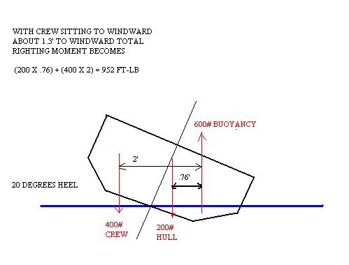

Now let's say you have an adventurous pal who wants to sail with you. He adds another 200 pounds to the effort like this:
Now the righting moment is all the way up to 952 ft-lb. Sail load required to capsize the boat is now 952/9 = 106 lbs which is 106/74 = 1.4 psf for this 74 sq ft sail. That happens at about 17 knots. Now the wind is really starting to blow! Your adventurous pal says, "No problem." and grabs a rope leading to the masthead and steps out on the rail with a trapeze, like this:

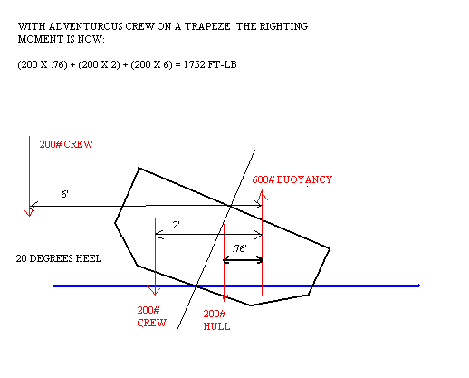

Now we are really getting up there. Righting moment with the big guy on the trapeze is now 1752 ft-lb! That figures to be 195 lbs on the sail for an average sail pressure of 2.6 psf. That happens in a 22 knot wind.
