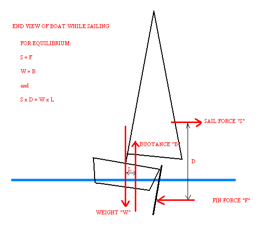

...We are trying to calculate how much sail a boat can handle. First we want to calculate the force on the sail required to capsize the boat. We started with this picture of a sailing boat in balance:

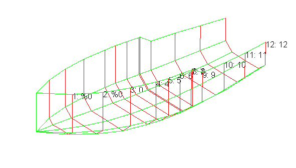

We can write the basic balance as the sail force S = W x D / L where W x D is the "righting moment" of the hull and D is the distance between the center of the sail area and the center of the leeboard (or keel or centerboard, etc.) area. W is the total weight of the boat with everything on board. L is often called the "righting arm" and changes as the boat rolls and is fairly difficult and tedious to calculate. But the free program Hullforms can handle it. To use Hullforms one must first model the hull in three dimensions, like this one shown for the boat Picara:

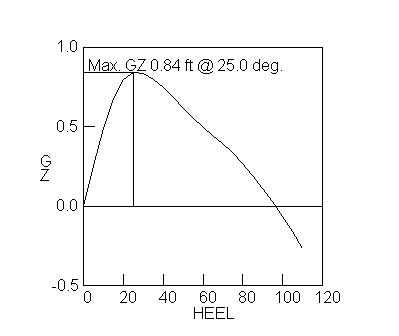

Given the hull lines and a weight/center of gravity information Hullforms will calculate the value of L and graph it for various values of heel as when the hull rolls. Here is the graph for Picara at 2000 pounds weight and with the cg 24" off the bottom:
Here Hullforms is calling the righting arm "Gz" instead of "L". The maximum value is .84' so the maximum righting moment of Picara would be 2000 x .84 = 1680 ft-lb.

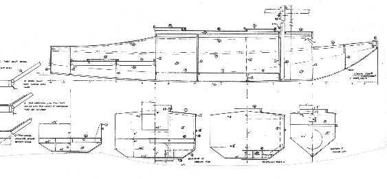

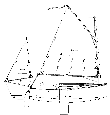

Here is a picture of Picara's sail rig:
The distance between the sail area center and the leeboard center is about 13'. So if we solve for the maximum allowable sail force we would get S = 1680 / 13 = 129 pounds. If the force on the sail exceeds that amount then Picara will roll past the point of maximum righting moment (at 24 degrees heel according to Hullforms) and continue to roll until the force on the sail is relieved.

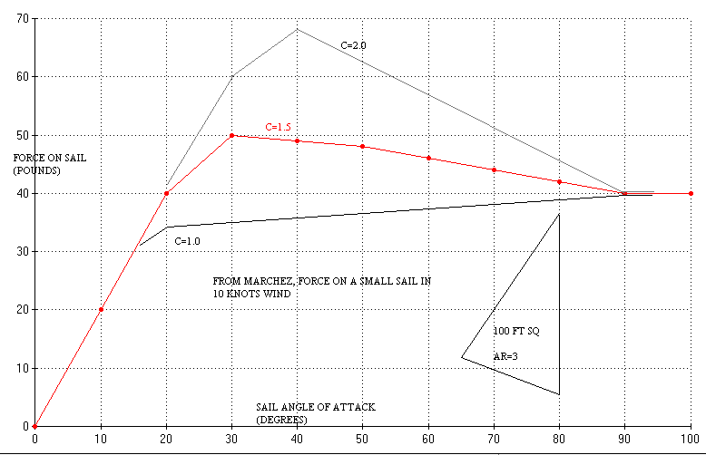

The coefficient "C" is the subject of much debate. The value of C varies with "angle of attack" which is the angle the wind acts upon the sail as shown below. But it tends to peak at about 1.5 for most good sails. Really super sails might peak at something like C=2.0 and a clunker might be down around 1.0, but when running downwind all sails will have a C of about 1.2. C = 1.5 is actually a fairly high value and few aircraft wings can operate at such a high value in real life without resorting to articulated flaps or leading edge slots.
As you see, the force on the sail increases proportionally with the angle of attack until it peaks and then decreases until the force on the sail is all drag and the coefficient is about 1.2. Tall skinny sails can reach their maximum at much lower angles than short fat sails. They can also be more efficient at low angles of attack because they have less drag and thus can provide better performance sailing into the wind (but they are harder to control that short sails so the effect may not be always real). Often tall narrow sails are less effective on other points of sail. Still, the peak value of C is little effected by the aspect ratio of the sail.
On rigs with several sails, the sail closest to the bow is often the most efficient since it gets the smoothest air. A large well shaped jib sail operating in front of a narrow main sail can be operating at a coefficient of more than 2 since the little main is working now like a trailing edge flap on an aircraft wing. The main sail will be operating at a much lower coefficient so the total might be close to 1.5. A mizzen is blanketed by those big sails up front and probably never operates at a C of 1.5.
The "V" in the equation is wind speed in knots. Since this value is multiplied twice, "squared", its effect can quickly overwhelm other factors. For example a 15 knot wind will produce 2.25 times as much sail force as a 10 knot wind. A 20 knot wind will produce 4 times as much force as a 10 knot wind. You can see that sailing in gusting winds can be a challenge. Design your boat for all out best in 10 knot winds and she will be grossly overpowered in a 20 knot gust. That's why nimble athletes make good dinghy racers and sometimes the heavier they are the better.
Sail area can be viewed as a somewhat arbitrary thing as a result of extremes in pressure resulting from fickle winds. One designer might give a skiff 100 square feet of sail and the next give it 50 and both claim they've got it right. The first might have it right in 8 knots wind and the second in 12 knots wind.

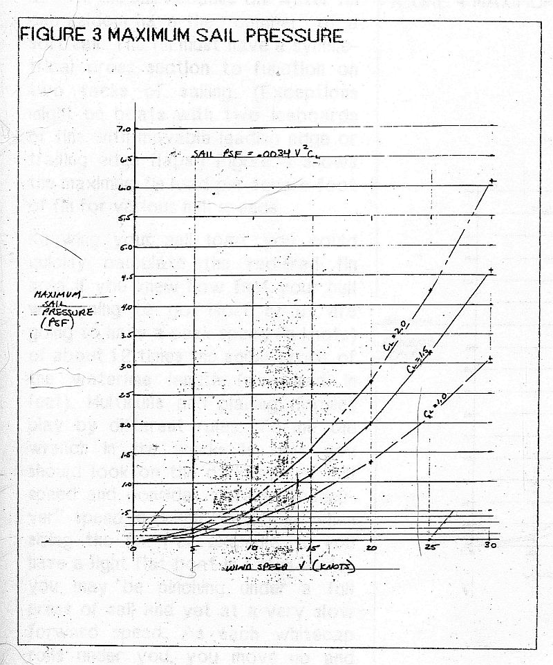

Anyway, the pressure on the sail can easily be calculated and charted out like this:
I've shown three value of C in the chart but remember that most good ones will be in the 1.5 area.

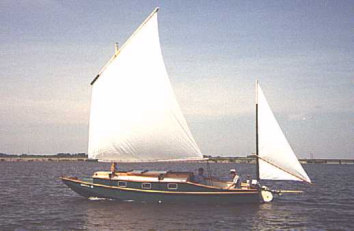

So you have another unknown in this matter, how fast will the wind blow? My feeling is that the sail should be sized such that you will need to shorten sail (tie in a reef) at about 14 knots. Why that number? Two reasons. First is that where I live a 14 knot wind will be kicking up whitecaps, a visual indication that you need to reef. Yes, it is arbitrary. Second is that the 14 knot wind produces about 1 psf on a typical good sail, a number I usually can remember.
How would this apply to the Picara example? Remember that the force on the sail required to knock down the boat is 129 pounds. So the sail area required to produce that force in a 14 knot wind is 129 square feet. In reality Picara has 171 square feet total of which 33 is in the mizzen. You might argue that the mizzen area is not as effective and the 138 square foot main is about right on. But I know the mizzen area can capsize a boat given the right conditions (as proven to me directly a long time ago when I capsized my Bolger Jinni).
Let's look at it a different way. How much wind is needed to knock down Picara in the given weight/cg condition? If you say the full sail area is effective then the wind pressure needed to capsize the boat is 129/171 = .75 psf and that occurs at about 12 knots of wind. Can you tell the difference between a 12 knots and 14 knots of wind without a measuring device? I can't. To me aerodynamics is not such an exact science that you can predict what a craft will do in real life until you build it and try it. I'm reminded of my term in the missile factory when it was planned to add four studs, about as big as your thumb, to the exterior of a missile that was about the size of an automobile in order to better support it in its launch tube. The aero engineers went through the roof with chart after chart of why it would reduce range below the minimun. But they test flew one and the studs increased the range! And then the aero guys said, "Of course! The studs acted like vortex generators that engergized the boundary layer, etc., etc., etc.". And they had plenty of charts to prove that too. They had charts to prove anything. We all did.
