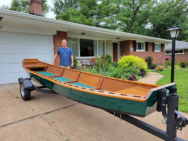

Dan Crowley poses with his new fancy Ozarkian. This design is actually a copy of an Ozarks drift boat from about 1900 that appeared in a 1950's magazine article. But that original was a very quick and rough build that used rebent iron wagon wheel "tires" for ribs. But way back then the lumber was wonderful and the bill of materials called for you to go to your lumberyard and pick up clear 1x12's, 20 feet long. Not today!
