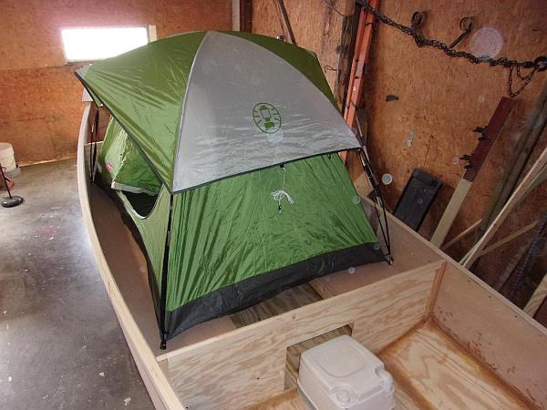

Dreaming out loud with a Mikesboat. So the plan is a small tent pitched in the cockpit with a potti conveniently tucked nearby to be pulled out when called for. The potty lives in a watertight nook open to the cockpit not built yet. Just like home!

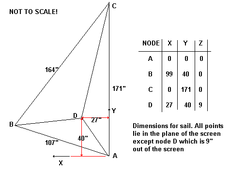

To review, the sail is drawn in "3D", with the perimeter as shown on the boat drawing and with a point in the center of the sail bulging outward. Like this for the sail shown on the Piccup:

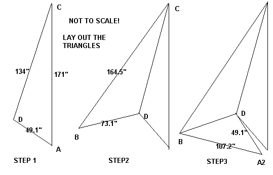

Next the lengths of all the lines shown above are calculated and then the sail is redrawn as a flat pattern with one edge slit like this:
Then this sail flat pattern is drawn out full sized on the polytarp and cut out (with allowances for hems, etc.). When it is sewn up the gap is sewn shut with a "dart" like this:

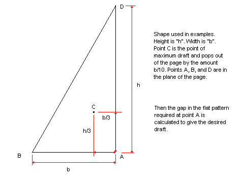

The model I used in the calculations looks like this:
Then I varied the height h and the width b and calculated the flat pattern that would result in the desired sail shape. Then I calculated the the gap at A. Hopefully a pattern would result such that the gap would be more easily calculated.

Let's first look at sail 1. It has a luff of 12' and a foot of 8' and a draft of 10% of the foot dimension for 9.6". The flat pattern gap at A needed would be 4.6".
Sail 2 is the same except now it has a foot of 12' instead of 8'. The draft stays at 10% of the foot for 14.4". The gap at A required to build this sail figures to be 9.0". That is an increase of 96% when the foot has been increased by 50%. So it is not in proportion to the foot alone.
Sail 3 is the same as sail 2 except the luff has increased from 12' to 16'. The gap required at A figures to be 8.2", only slightly down from sail2's 9.0".
Sail4 is the same as sail2 except the luff is all the way to 20'. The gap required at A figures to be 7.6". So the length of the luff does not have a huge effect - and increase of 100% in the luff reduces the figured gap from 9" to 7.6", about 15%.
After looking at the effect of the luff dimension on the gap at A, I tried one more in sail5. Sail 5 is the same as sail1 except luff is increased from 12' to 16'. The gap needed at A figures to be 4.1" to give a draft of 10% of the foot, down from 5.2" of sail1.
CONCLUSIONS???
If you were building a normally proportioned sail with an 8' width or foot, I would say the gap at point A would need to be "about 5 inches". A taller sail needs a bit less gap and the lower sail needs a bit more.
If you were building a normally proportioned sail with a 12' width or foot, I would say the gap at A would need to be "about 8 inches". A taller sail needs less and a lower sail needs more.

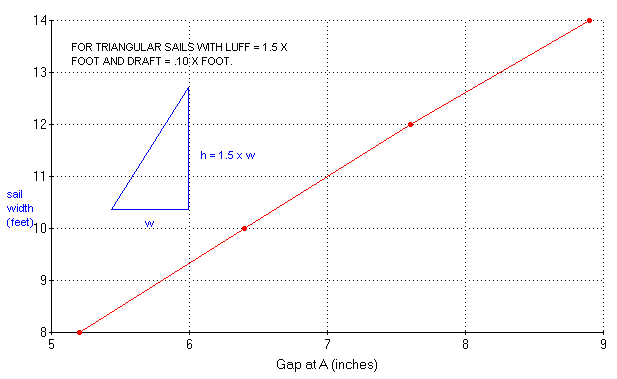

What if your sail is in between? I cranked through a few more examples to get a feel for it. Sail1 was the basic pattern with a luff of 150% times the foot and a draft of 10% of the foot. Here us what came up:
I would use this chart for triangular sails of normal proportions. It starts with a 48 sq foot sail which is about the smallest sail useful. And progresses to a 147 square foot sail, which is about the largest sail I would try with normal polytarp technology. Somewhere in between should be the A gap you are looking for.
I guess the way I would use make a sail this way would be to lay out the sail according to the basic dimensions shown in the plans, and then draw a line from the tack upward where I want the dart to run, about 1/3 to the top of the sail and 1/3 back from luff. Then at the tack I would draw the "gap" that is predicted by the chart and sew in a dart that would remove that amount of material. The resulting sail will be a few inches smaller than the blueprint sail but that should be of no consequence.

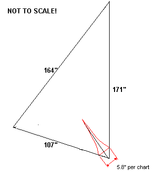

Here is how it might look for the sail I used on the Piccup Pram. The width of the sail is almost 9' and the chart predicts a gap at A of 5.8". I would draw it out like this, fold it on the black line going from the tack to the center of the sail, and then sew in a dart more or less on the red lines shown.
