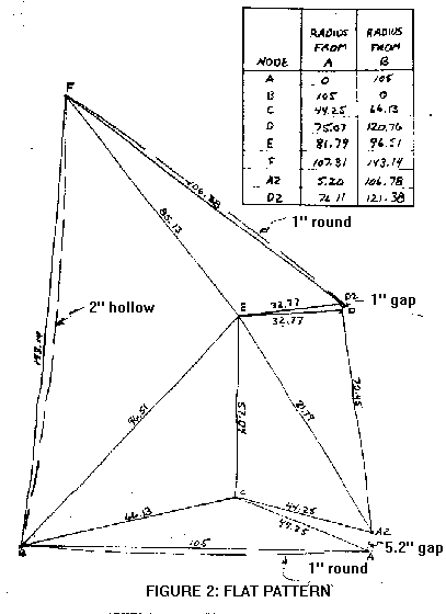

You recall the pattern we developed for a small lugsail to be made from a single sheet of polytarp. The pattern was predetermined to give a certain draft. The pattern below is for a Piccup Pram sail, about 70 square feet of area and 10% draft. We're going to cut and sew this sail.
As we discussed last episode, we have this pattern drawn in felt tip pen on polytarp such that no edge comes within about 2" of the edge of the tarp. We will not use any of the preformed edging on the tarp. Don't be tempted to do so. As for tarp material, I prefer the "Coleman" brand sold at Wal-mart stores although I doubt if the other ordinary tarps are much different. I haven't tried any of the "heavy duty" tarps although they might be worth a try. A few issues ago I suggested looking at the polysail page for gourmet tarps. Since I wrote that I saw some examples of those tarps at the messabout at Bloomington, Indiana in September. They are indeed superior to the common tarps, not only slightly heavier, but they can be bought in pure white, something I've never seen in a polytarp.
CUTTING THE TARP....
The tarp will be hemmed along the foot, head, and leech. So those lengths should be cut about 2" outside the line. The luff can be cut right to the line. DON'T CUT THE LONG V'S FROM A-C-A2 AND FROM D-E-D2! Instead cut straight across from A to A2 and from D to D2.

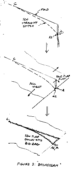

SEWING THE DARTS...
The darts at the two major shaping seams will be sewn as shown in Figure 3. In Figure 2 the two shaping seams appear as the deep V's of A-C-A2 and D-E-D2.
Break out the sewing machine. Any sewing machine will sew polytarp although you should use one that will sew a zigzag stitch. Use a rot proof thread like the V69 polyester SailRite sells. Practice a bit if you aren't used to sewing. Read the manual if you've got one.
I'd suggest you try the widest seam first, the wide ones seem the easiest. Practice sewing one or two with some scrap. First fold the cloth on the centerline of the seam. You might secure the fold temporarily with clothespins or paperclips. Then sew, using a straight stitch, from the inner part of the seam to the outer edge along the smoothly curved line shown in the figure. If you were to sew a straight line from point C to A you would end up with the double wedge shape of the original pattern (or something like it - the flexible cloth probably wouldn't take the exact shape.) But if you sew the ever-broadening curved line shown you will get a sail with smooth curves and the original double wedge will be converted to a smooth airfoil with the desired draft.
Next open the fold and pull the cloth tight across the seam. It won't be flat anymore but that's the whole point of the special seams. There will be a little flap of material sticking out. Fold it flat and sew down the loose edge with a zigzag stitch. Then sew over the other edge of the flap, that is the edge with the straight stitch, with the zigzag stitch to further secure it.
Repeat with the other seam.
