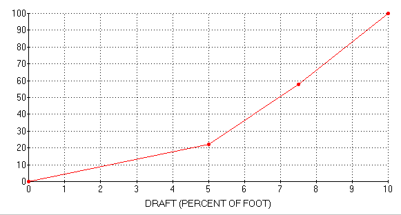

The gap shown in the chart was calculated assuming a 10% draft, which is sometimes thought to be the optimum. I ran some numbers to figure the effect of draft on the gap. The example used in the numbers had a foot of 10' and a luff of 15'. The chart shows a sail with a 10' foot would need a gap of about 6.4". The same sail with a 5% draft would need a gap of just 1.5" and with a 7.5% draft would need a 3.7" gap. So there is a large effect. Showing that as a chart in percentage, it would look like this:
For example, if you had a sail with a 12' foot and wanted a 7% draft, what would the size of the gap at the tack? The first chart shows the gap needed for 10% draft to be 7.6" for the 12' foot. The second chart shows that for 7% draft the gap would be 50% of that, for a tack gap of 3.8" which would mean a shaping dart 1.9" wide.

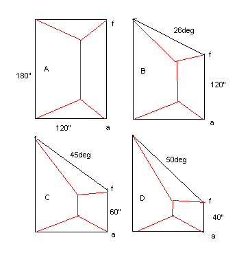

From figuring the shape of lug sails in the past I had the opinion that the peaking of the yard has the effect of reducing the size of the dart needed at the throat. In fact I suppose the extreme case would be a Solent lug where the yard is peaked all the way up as an extension of the mast - a triangular sail needing only one shaping dart. I looked at four sided sails that look like this:
So the overall size was the same as the triangular sails, 120" foot and 180" height.
All of these sails needed a gap at the tack of about 5.5" compared to about 6.5" for the triangular sail, 85% of the triangular sail. So the peak angle really has no affect on the tack dart.
The throat dart changes with the angle of the peak. Sail A needs 5.5" gap at the peak dart. Sail B needs 5" gap at the peak dart. Sail C needs 2.6" gap at the peak dart, and sail D needs 3.4" gap at the peak dart.
Plotting it out looks like this:
I expected a smooth curve! But no, there is a bump. I double checked my numbers and it was still there. If there is an error in there I think it is in the 50 degree example. I would expect that sail would need a gap of about 2" instead of 3.4".
