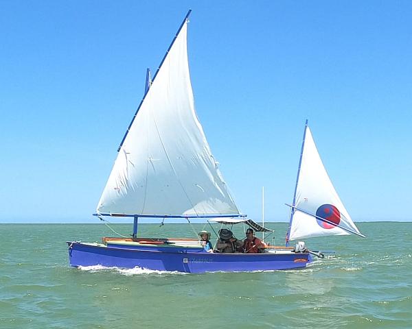

Chuck Leinweber's Toon19 at this year's Texas200, with Chuck, Bill Moffitt, and Harper Mitchell on board. Chuck writes, "This was her 5th Texas200. She points well - lots of tacking this year. She handles the sometimes severe bay chop with aplomb. She sails well in shallow water (we have some down here) and does surprisingly well in a foot of water with the board barely in the water. She is fast - it's always fun to pass other boats.. I have built and sailed big boats and small boats and this is the sweet spot. She is so easy to launch and retrieve yet has a capacious cabin area that can hold a lot of gear. if she is not the perfect camp cruiser, I don't know what boat is. She is easy to build and cheap - I built mine with construction grade pine plywood (carefully selected, of course) - and she is holding up very well.
