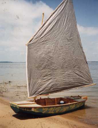

By the time I'd built Piccup Squared I was already thinking Piccup could stand more sail area and Piccup Squared quickly became a test bed. My first polytarp sail was tried on it as shown below. This sail has 74 square feet of area and is to the Woobo sail plan. This sail was made exactly as a Dacron sail would be made. I cut the tarp into 3' wide strips and sewed it up with normal broadseams.
piccup squared
Looking at this great photo reminds me of how it came to pass. Karl James had called me saying he was thinking about making my Jewelbox design but was unsure about the lug sail rig. He was returning to Texas from Woodenboat School and stopped by Rend Lake for a sail in Piccup Squared with a lug rig. That's Karl at the helm. Karl went on to build the Jewelbox and went on to many adventures with it. (Jewelbox has a new owner now in Florida somewhere. Karl replaced it with his own design, sort of a blend of Bolger's Black Skimmer and Martha Jane but he's stuck with the balanced lug rig.)
In the photo you can see the wind is quite light but the boat is moving well under that big sail. She is heeled a bit and Piccup Squared is in her element. Under these conditions she is probably as fast and as good as the original Piccup. Many folks would think she is more comfortable because of her wider bottom. The heeling is pretty important to a flattie and I think the trick to sailing one is to keep the heel just right with the windward chine barely out of the water. In really light winds you might sit on the "wrong" side of the boat to keep that chine out. Piccup is different - sail it flat whenever you can. In high winds you need to tend the sail so the heel is just right. I never capsized Piccup Squared except on purpose. The sides were low enough that I'm pretty sure she will take water over the side before capsizing, unlike higher sided flatties, and I feel that is a good feature in that you get a small wet warning instead of a big wet surprize. The original Piccup really is better in rough water but you would expect that.

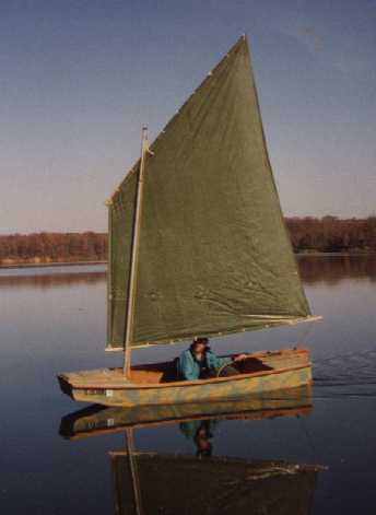

Here was another test sail on Piccup Squared. Jim Huxford was at the helm here. The green sail was my second polytarp sail. This one was made in one piece though, no cutting the tarp in strips and sewing it back together. "Darts" were sewn in four places where a Dacron sail would have variable seam widths. This sail was also the first 68 square footer, the sail I advise everyone to use on the Piccup family. The yard and boom are the same length as with the original 55 square footer, but the hoist is 2' taller. When reefed this sail returns to 55 square feet.
piccup squared
Looking back at this photo I'm reminded of the troubles I had with stretching of the luff. A balanced lug sail will set closer to the wind if there is a lot of tension in the halyard, as will almost any sail. But the stretchy polytarp had trouble in the highly stressed luff. It didn't tear, but it would stretch a lot of the draft out of the front of the sail. The result was the front of the sail was very flat and the draft was mostly in the aft half of the sail - not the ideal. This sail luff was later stiffened with a couple of fiberglass tapes which helped a lot.
