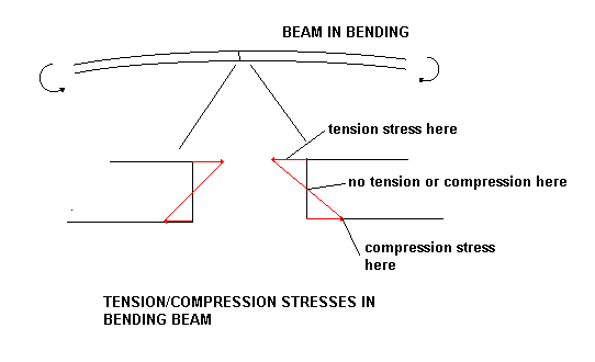

elastic bending
The above figure shows the pattern of stresses in a beam that is under pure bending. Here the material is still in the "elastic" range, which is to say it it is not so highly loaded that it won't spring right back to its original shape once the load is removed. What is significant here is that compression and tension stresses develop that resist the bending and that the stresses are highest in the outer fibers of the beam. In the middle, at what is called the "neutral axis" there is no bending stress at all. You might think that the outer fibers are doing all the work, the inner fibers almost nothing. That would be just about correct in the conditon of pure bending but in real life the middle fibers do other important things. So you can't just remove the middle fibers totally but you can skinny them down in a beam meant to take mostly bending loads. The classic way to take advantage of the situation is with a I beam, where the outer fibers are thick and wide while the middle fibers are reduced to a thin web.
Similarly a tube has had its middle fibers removed. It does not have the bending strength of an I beam but has the advantage of being able to take bending loads in all directions because of its symmetry (unlike the I beam which is optimized for bending in just one plane) and is the optimum shape to handle torsion loads.

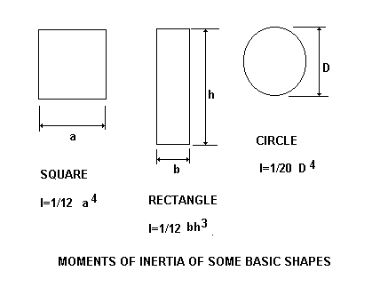

It's actually pretty easy to determine the effect of hollowing out a spar, which is to remove a lot of those middle fibers that don't do much, on strength and stiffness. The effects are pretty much related to the "moment of inertia" of the section which is fairly easy to calculate. Some of the sections you might use for a spar are shown above.
The reason the moment of inertia tells you so much is that in a beam under a bending load, the stress and deflection are both directly related to the moment of inertia. For example, all other things being equal, if you double the moment of inertia of a beam's cross section, both the stresses and the deflections will be cut in half.

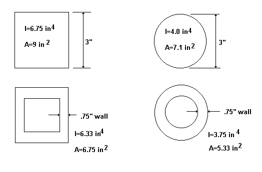

The answer is that you can figure the moment of inertia of the hollowed out cross section, provided the cross section is still symmetric, by subtracting the moment of inertia of the hollowed out area that you removed from the full unhollowed moment of inertia. Here are some examples:
hollowed moments
Two things to point out here: First the moments are not reduced in proportion to the amount of material removed. You lose material a lot faster than you lose strength. For the 3" square the tube version reduces the section area by 25% but the reduction in the moment of inertia is but 6% Such a good deal!
Second, the square section is a lot stiffer and stronger than the round section with same width. The 3" square has 26% more area but its moment of inertia is 69% larger. Such a good deal! Some sail types like the lugsail or spritsail or even the sharpie sprit sail can use a square mast with little loss in sail efficiency. If your round mast flexes too much, convert to a square one! Can't do that with a gaff rig though because the gaff jaws insist on a round or octagonal mast.
By the way, another way to look at all of this is to see the effects of going to a smaller diameter mast. You quickly get yourself in trouble. The stiffness is proportional to the fourth power of the diameter or mast thickness. If you reduce the mast from 3" to 2", the mast stiffness is reduced by 80% !!

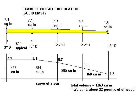

Let's look at a typical mast to see how much weight is really saved. Let's use this one as an example. It is round and I've shown the diameter at distances along the mast along with the section area at those points.
basic mast
The example shows the solid mast. The method of figuring the weight is to calculate the volume and then figure the weight from the density of wood which is typically about 30 pounds per cubic foot. The figure shows the volume calculated with a quick "curve of areas" where the area at each section is plotted along the length of the mast. The area under that "curve of areas" is the volume of the mast. Add them up and you get the volume of the total. In the example the mast would weigh about 22 pounds if solid.

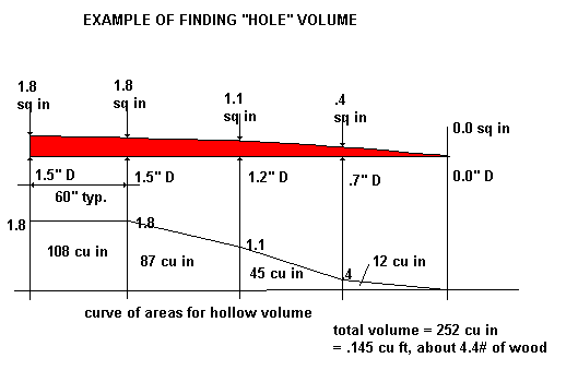

You can use the same technique to figure the volume of about anything, including a hole. Here we'll use it to figure the volume of the hole in the center of the mast if it were hollow such that it had a 3/4" wall.
hole volume
The proposed hollow amounts to about 4.4 pounds of wood. The hollow mast will weigh about 17.5 pounds instead of 22 pounds assuming it has no beefed up solid sections for fittings. Whether the work involved in hollowing out the mast is worth the trouble is something the individual must decide. But you can see that this mast has its weight reduced about 20%, its stiffness and strength reduced by about 6%.

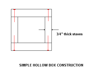

I've built two hollow masts, one for my Birdwatcher and later another for my Jinni which had been coverted from a sharpie sprit to a balanced lug. I built hollow to allow an easier construction and not to save weight, although the hollow masts were lighter. Both used simple box construction from 3/4" boards like this:
boxmast
The Birdwatcher mast was 5" across and the Jinni mast 2-1/2". The staves that formed the walls were scarfed to length first and then cut with a circular saw to the proper taper one at a time. Then the masts was assembled with glue and nails like simple boxes, 24' long in the case of the Birdwatcher and 14' long for the Jinni mast. By doing this I avoided having to saw and shape the taper of sticks that would be way to thick to cut with my saw, as it was I never cut any wood more than 3/4" thick.

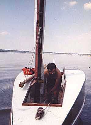

Both masts worked quite well. The original Jinni mast was square in cross section even though it was a sharpie sprit sail. I doubt that the small square mast disrupted airflow as you might think. The Birdwatcher mast was supposed to be octagonal and hollow - a fairly involved building effort. You might think the 5" square mast that I built would really disrupt the airflow to the sail. To minimize the disruption I turned the mast 45 degrees to the axis of the boat like this:
Birdwatcher mast
I thought it worked out very well. The sail is laced to the mast and is somewhat free to align itself from side to side, unlike a sail that is trapped in a groove or track on the aft face of the mast. (Phil Bolger has written several times that a sail set on the mast with loose mast hoops as in the old gaff days has the best aerodynamics. More modern streamlined masts with sail track or grooves often are supposed to swivel on the deck at each point of sail to allow proper mast/sail alignment. You can see how complex the details can become.) One day I was out sailing in Birdwatcher and snapped a photo looking up the leading edge of the mast. The sail flowed right off the mast as in the above diagram. Alas, I can't find that photo. Here is one in which you can make out the "diamond" mast. (I think you can also see why I've stuck with the slot top cabins and offset masts that characterize the Birdwatcher layout):
Birdwatcher mast
So in this case I felt I had it all: light hollow mast, easy construction, and good aerodynamics. Still, I hardly ever draw hollow spars on plans because the drawings can get really complex and I don't want to deny anyone the challenge of brainstorming a new way to make a hollow mast. There seems to be no end to the ways of making one.

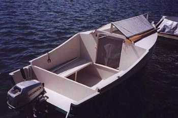

AF4Breve
AF4Breve, POWER CUDDY SKIFF, 15.5' X 5', 350 POUNDS EMPTY

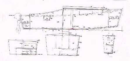

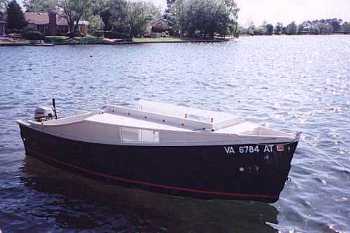

Bruce Given of Virginia Beach, Virginia, did a perfect job on the AF4B prototype shown above. He said he didn't have the shop space to build the 18' AF4 and when I saw the photo of him working I believed him. So I scrunched the 18' AF4 down to 15.5'. I took 1' out of the cabin shortening it to 7', 1' out of the cockpit shortening it to 5', and 6" out of the motor well. I'm pretty sure everything is still acceptable, although the longer AF4 might still be preferred if you can live with the length. The width and depth of the cabin and transom are tha same as AF4's.
To a certain extent you could build the shorter boat without new plans by scrunching up the length dimensions. That method would be a lot more reliable for a simple flat iron skiff like this one. For more complex shapes where all the panels are expansions, including sides, bottom and bilge panels, it would not be so reliable. Bill Wainright built the original Smoar rowboat by scrunching up the Roar2 drawings but he is a sculptor and did the job with a model. Later I drew Smoar from scratch. Also the bevels shown on the long boat drawings will not be correct. That might be no problem with a taped seam hull.
af4b
So AF4B is a totally new set of drawings. There are two changes made besides the scrunching. I made the bottom 1/2" thick instead of 3/8" as I built into my AF4. Most folks would prefer the extra stiffness. On AF4 I think of the bottom flexing only when running hard into chop. The extra thickness finds its way into a lot of other parts since they are made from the off fall of the bottom panels. You could make the bottom from 3/8" ply and save about 50 pounds on the total weight. The second change adds a bottom to the bow well which lifts the well bottom up about 18". It is more complex to build but the original deeper well is hard to reach all the way into. The area below the new well is accessible from the cabin for an iota more storage.
Still suggesting 10 horse power max.
