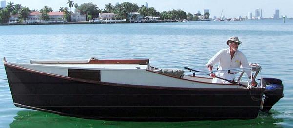

It has been a few years since I met Rene Vidmer at Grafton, Illinois, where the Illinois River meets the Mississippi, as he was looping the eastern US in his AF4Breve. After that it went to Europe on the back of a freighter. He recently wrote and I asked him where the AF4Breve is today. His answer: "KOTW is up on the hard for the winter in southern France, on the Med. (Agde). Since last Spring she�s been to Strasbourg, Budapest, Belgrade, Triest, Venice, Genoa, Marseille, and half a hundred ports in between." Such an adventure in such a cheap boat!
