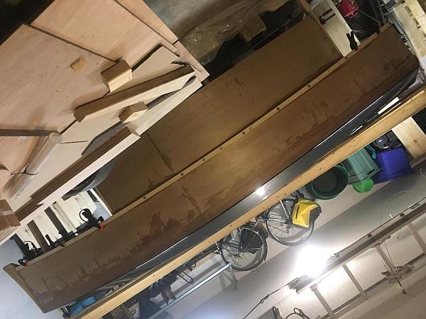

Tom Burton's Philsboat project has his world a bit out of whack.
