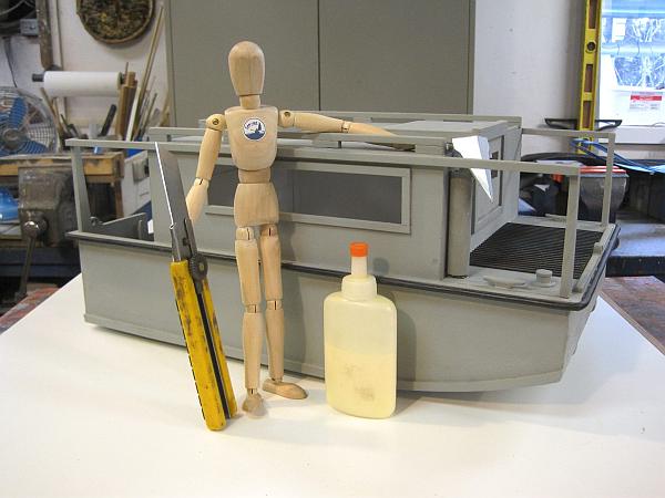

A neat Dockbox model by Brian Matthews. (Knife and glue pot not to scale.)
