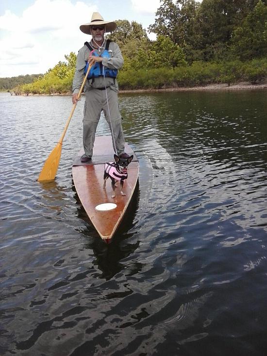

REND LAKE 2019...
The Captain directs and Gene Berry obeys on his PaddlePlank.
