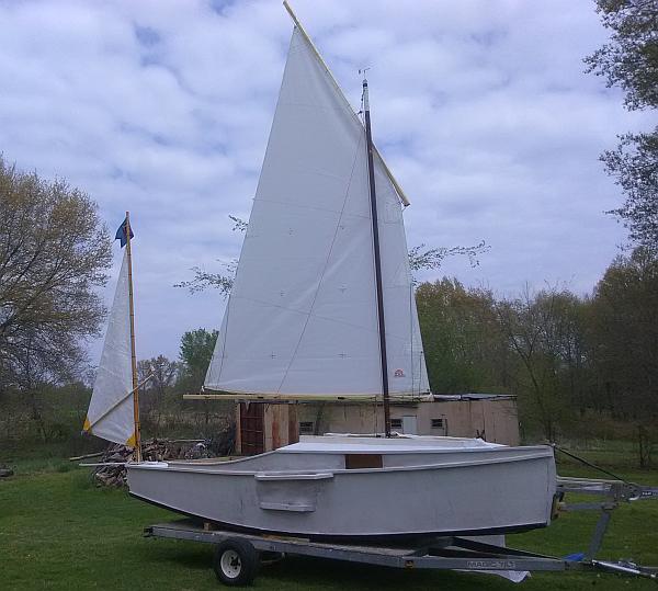

Gene Berry's new Normsboat gets in some lawn sailing...
