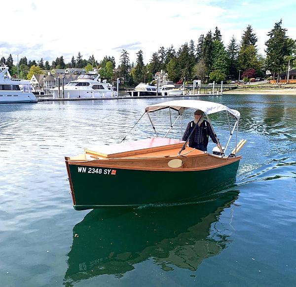

Ken Preston, and his reflection, go out for the first time. 1983 Evinrude 7.5 pushes it to plane at 9.5 mph but the boat is still very light.
