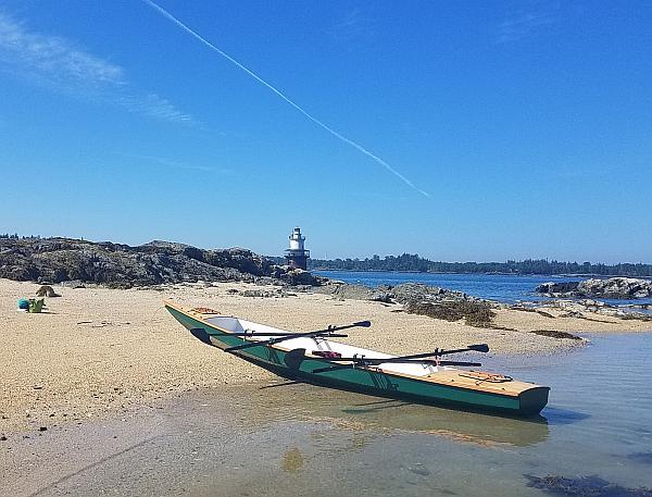

Darrin Hallowell's RB42 on a Maine beach, I think. Set up to row two. A pretty picture!
