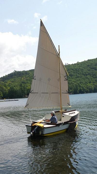

Herb McLeod with the prototype OliveOyl with a new lug sail he made from canvas (with some extra added to the foot). Looks and sails fine he says.
