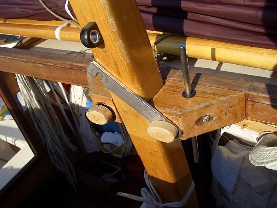

The mast partner closure on Norm Wolfe's Normsboat.
