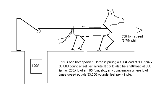

...that you lived in Olde England. Your name is Wilbur. The Duke is starting up a coal mine and wants to hire you and your horse to lift coal out of the pit. You have a horse name Mr. Edward. He is a totally ordinary work horse except he can talk.
The Duke's operation is quite small at this stage and you rig up Mr. Edward like this with a simple rope with one well greased pulley that offers no drag. The barrel is loaded up my the miners and then lifted up by walking Edward at a fast walking pace of 3.75 mph.
All goes very well until the Duke's miners pick up the pace and start working Edward harder than he can on a day to day basis. Edward calls everyone together for a meeting and tells them," Look, I'm a totally average work horse. When I walk at 3.75 mph (which is 330 feet per minute) I can tell that the most weight I can pull is 100 pounds. Let's multiply that speed by the load I pull. So 330 fpm times 100 pounds is 33,000 pounds times feet per minute. Somebody write that down and call it 'one horsepower'!"
So horsepower is a force being pulled at a speed. One horsepower is what you can expect from an average work horse over an average work day. He can come back the next day and do it again."

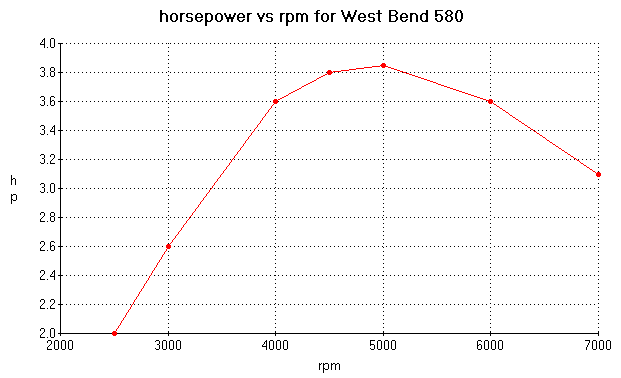

Some modern dynamometers work more or less as above except they might use a pump like a water pump or electric device with the engine mount reactions having a scale that will read the torque directly. I think the "load" on the pump is controlled by a valve that regulates how much water is entering the pump. So the dyno operator might rev up the motor with no load and then open the water valve to allow it to start pumping water and load up the motor. The rpms will drop until the motor's effort matches the demand of the pump. The operator takes note of the rpm and the torque (which is the reading on the spring scale times the arm length). He will add a bit more load and the rev's drop a bit more and takes his readings. And so forth. If he plots out the torque vs rpm he might get something like this:
Of course since horsepower is just torque times rpm times a constant you can quickly figure the horsepower and plot it. For example from the chart above we might read at 5000 rpm that the torque is 4.05 ft-lbs. So the hp at 5000 rpm is 4.05 x 5000 / 5254 = 3.9. The hp chart below is from a real old magazine where a West Bend 580 gokart motor was tested. Motors like this were also used in smaller outboards like the Elgins. Here is the horsepower chart for that motor:
Note that peak horsepower does not usually occur at the same rpm as peak torque. If you are gearing your motor or prop for say maximum boat speed you will want to arrange it so the motor is turning at the rpm for peak hp with throttle wide open.

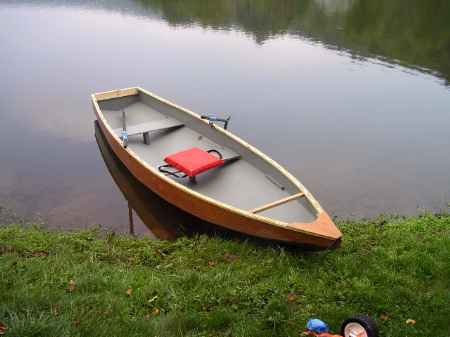

Vireo14 is a 14' version of the original 12' Vireo which was quite popular with all of its builders. In this case the extra length comes from a straight "stretch" of the original design. By that I mean that the same cross sections were used but now spaced 14" apart instead of 12". Another way to lengthen a boat is to add a straight "plug" in the center as is sometimes done to even completed boats and full size ships. I doubt if the stretch has any advantages over the plug except maybe in looks. Even there a short plug is hardly noticable, for example in the case of where I put a 30" plug in my Toto canoe to make Larsboat.
The extra length usually gives a bit more speed for the same power in a low powered boat, at least until windage gets to be a big factor. And in the case of Vireo it means about 110 pounds more capacity. The original 12' boat will float 290 pounds before the chines start to enter the water. Beyond that I would expect the boat to slow noticably, although boats with bows shaped like Vireo are superior in this respect. So you see that it is a push to float two large adults in the 12' Vireo. The Vireo14 will float the same way at 400 pounds and will be much better with the two adults. Hull weight will increase by 10 or 15 pounds, of course.

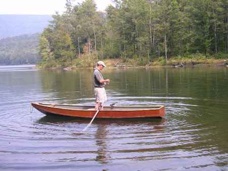

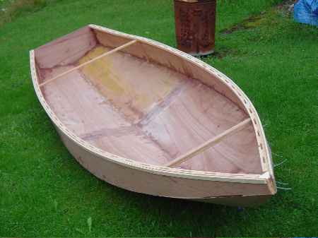

The prototype Vireo14 shown in these photos was built by Steve Fisher in New York in a matter of a few weeks. If you look at his construction photo below you will see that there is not a helluvalot involved. Steve elaborated on some of the details but with these small simple boats often there are between twenty and thirty pieces of wood to make counting everything.
Vireo14 uses taped seam construction needing four sheets of 1/4" plywood.
