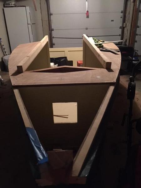

Ellsworth Thorndike got his AF4Breve about to the painting stage but medical issues forced him to stop. If you are interested in this project contact him at kethorndike@gmail.com. The project is in New Jersey.

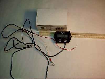

In my tests the rev's of the powerhead were measured with this handy tachometer on loan from Motor Max. It is a handy thing bought for about $40 from www.northerntool.com. One lead goes to a ground on the motor and the other wire wraps around a sparkplug wire. You can set the thing for different ignition designs, for example a spark on each rev, or every other rev, etc. The only problem I had with it is that the lead is so sensative that on a two cylinder motor it can pick up the jolt from the wire several inches away and give a false reading. What I did on a two cylinder engine was to wrap the lead around both sparkplug wires, right where they come out of the ignition plate and are close together and set the gadget to read two jolts per rev. Then all was fine. The gadget also records the operating time of the motor, thus you see the number on the screen below. When the motor is running it reads revs, when the motor is not running it shows total operating time.

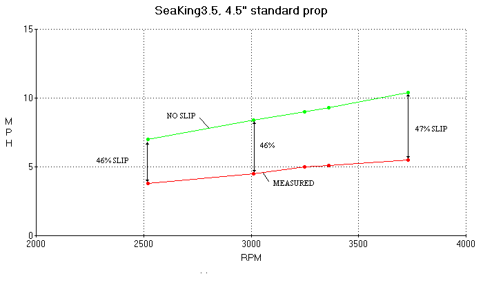

The actual tests with AF4 were quite simple. Just mount a motor, remove the cowling so that the tach could be wired up in a minute, head out on the lake and run at several speeds, writing down the rpm at each speed. Then chart that data along with the Vns for that prop and lower unit. Here is the first one with my lowly SeaKing3.5, which is a Clinton made motor from about 1970:
Slip measures out at about 45% across the entire range. I've read that is very typical of low hp/weight boats with small props that won't plane. I got similar results but up to 50% slip with a Sears5 (Eska) using a 6" pitch that gives 6.8mph at 3500rpm full throttle.

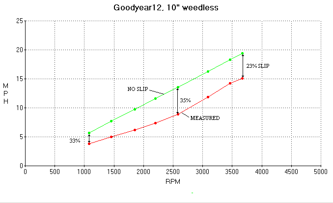

Next I ran a 12hp Goodyear (OMC, about 1956) with a 10" semiweedless prop that was standard on motors like this for a long time.
Now we have something different with slip starting at low speed with about 30% maxing out at 35% when the boat is at its "hump" before planing. Once it starts to plane the slip reduces, going down to about 23% at full throttle at 3670 rpm at 15.1mph. The motor is rated at 4000 rpm indicating that a lower pitch prop might be in order.

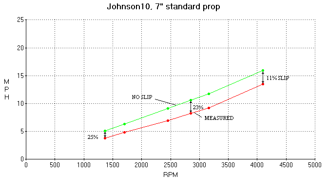

Next I tried a Johnson10. This one has a 7" prop that is not weedless. It has large straight blades. It was a very windy day but I found a sheltered cove for most of the testing.
The slip of this prop is much lower than that of the weedless prop. It slips about 25% at low speeds, dropping to about 10% at full throttle of about 14mph. At one point it went 15 mph at 4300 rpm for 6% slip, probably wind aided. This motor is also rated at 4000 rpm. I don't know if that should be considered to be a "redline". But in fact I used this motor for a few years when my AF4 was still stripped down and lighter and a lot faster than it is now. We once measured it at 17mph with this motor and that would mean about 5000+ rpm. That seemed to do no harm. The motor is 47 years old!

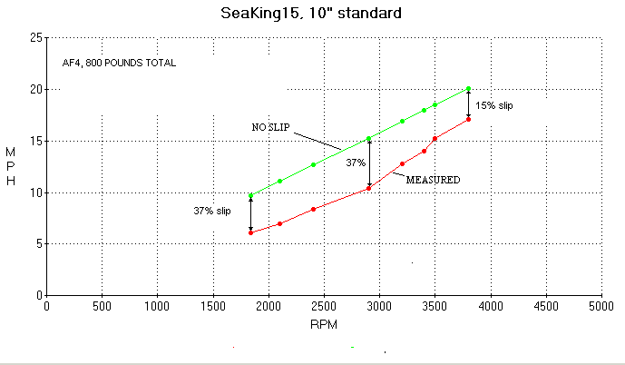

Anyway, off to the lake with the SK15 using a 10" standard prop. Here are the test results:

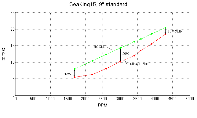

More or less similar to the Goodyear12 results except now slip continues to drop with speed to 15% at 3800rpm full throttle at 17.3 mph. This motor is rated at 4500 rpm indicating that less pitch might be nice. We tried it with several other props but settled on this 9" standard as being the best of the bunch:
Now full throttle gave 18.5 mph at 4300 rpm with 10% slip. That is not a huge increase from the 17mph that the 10" prop gave even though the revs are higher and the slip is less. The thing about changing prop pitch is that if you increase pitch you increase the load on the engine and you lose revs, so the top speed may not change much. And if you decrease pitch you decrease the load on the engine and you gain revs, but again the top speed may not change much. It is horsepower that moves the boat and horsepower is torque times rev's. Depending on the torque/rpm curve for a particular engine you might find that the horsepower is fairly constant over a pretty wide range because the torqe falls off as the motor revs up. And if your motor has say a constant 15 hp between say 4000 and 4500 rpm then the top speed of the boat might be constant too anywhere in that range. I'm thinking that is about true with my Seaking15 and most of the OMC's and that the extra speed I got was due more to a more efficient prop than to raising rev's and tapping into more horsepower.
