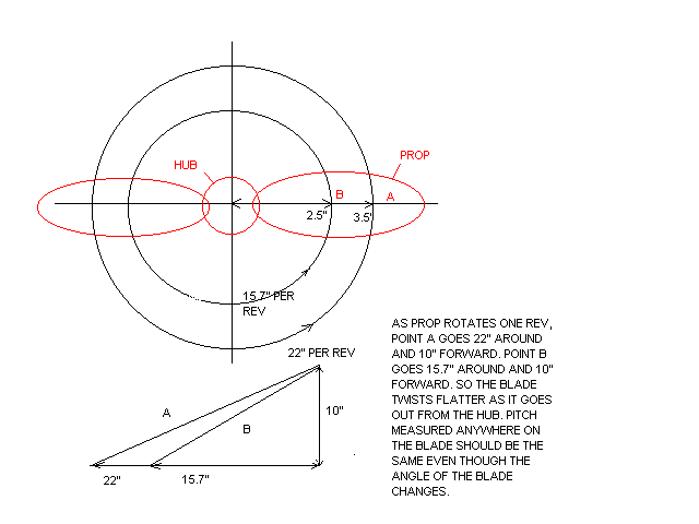

Here is a picture of a prop:
Let's say this one has a 10" diameter and a 10" pitch (actually a common size for a 20hp or so outboard). Look at point A which is 3.5" from the center. As the prop turns a revolution that point will travel pi times 3.5 times 2 = 22". That point will also travel forward 10" (by definition as a 10" pitch) with that revolution assuming no slip so the angle the props face moves through is 10 to 22 which is 24 degrees. Now look at point B which is 2.5" out from the center. That point will turn 15.7" with each rev (pi x 2 x 4.5 =15.7) but travels forward the same 10" as point A. So the prop face there moves through an angle of 10 to 15.7 which is 32 degrees. And so forth along the entire face so that you see as you move from the hub to the tip the blade twists to have a flatter angle. I would think that any effort to "repitch" a proper propellor would be a compromise because you won't be twisting the area near the hub as much as that near the tip.

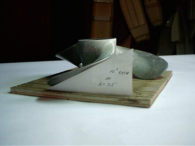

Here is the simple gadget I made to do that.

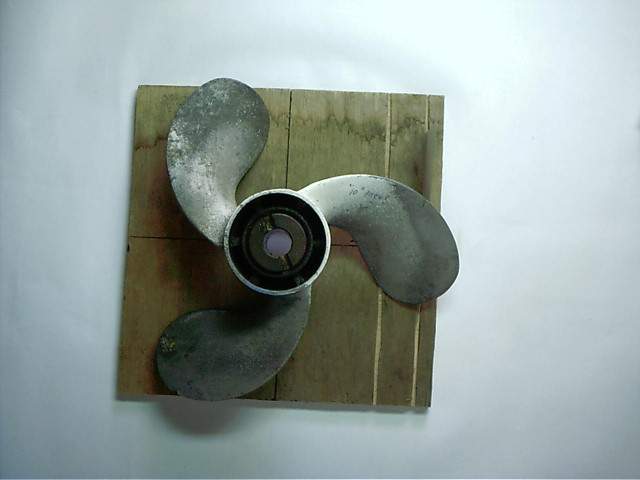

Start with a 10" square of plywood. Draw crosshairs on it. In this case I cut a 1.5" diameter hole in the center to allow it to be used with props already mounted on the motors but the hole is better omitted otherwise. Then I cut narrow grooves out 2.5" and 3.5" from the center.

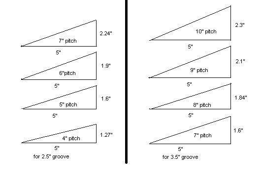

I cut out a bunch of angle templates from index card stock and labeled them for angle and pitch. They look like this:

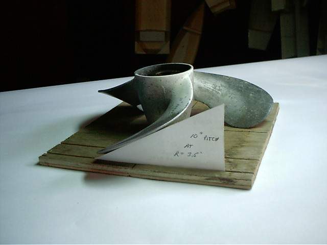

So to measure the pitch of a prop you first place it centered on the plywood with its aft face against the wood because it is the angle of the aft face that is easiest to measure (because the aft face is usually flat). The center of the blade to be measured should be centered over the crosshair that passes over the grooves. Not always easy to do that as you see here with a "semiweedless" curved blade from an old OMC.
Next we slip the angle templates into the most appropriate groove until we have a match, like this:
I used the 3.5" groove here but with a smaller prop I would use the 2.5" groove. But remember that you need a different set of angle templates for each groove. Here is another view:
It isn't totally exact because the face of the prop often isn't exactly flat. (I think the "perfect" way to measure the pitch would be to get the angle that goes through the the tip of the leading edge and the tip of the trailing edge. )
There you have it. This old OMC prop measured out at 10 inches of pitch.

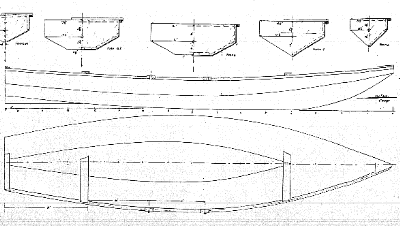

I'd like to point something about the way I draw the line on many of my boats. I make card models of my designs which help me check the panel expansions and allow me to get a 3D check of the shape. The models are done in the same scale as the blueprint, in this case 1/8 and the model is fairly large. So I knew that Oracle has nice curves all around. But if you look at the end view in the lines drawing you see all straight lines! In a way this is a throwback to the original "instant" boats which had hull panels made from straight saw cuts. It is easy for a designer to make the jump to more flexible shapes, that is hull shapes which can look like about anything you might imagine being made from plywood. Back when I started drawing boats I noticed some of the nicest shapes in 3D had end views made totally of straight line segments. Don't ask me why. Not only does that give a nice shape, the designer's job is simplified. For example, with Oracle I might start by drawing the top view. Then I might sketch in the side view needing nothing more than an idea of what the stem, midsection, and stern will look like. Next I draw the end view which will include those elements connected by straight lines. In normal mechanical drawing it only takes two views to totally define an object. So without even drawing the side view of the boat the shape is defined. It only remains to go back and figure it out and adjust the top view, etc., etc.. Happy is the designer who gets it right the first time through.
Oracle is built with taped seams using four sheets of 1/4" plywood. No jigs, no lofting.
