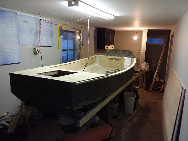

Jerry Lewis's Piccup is nearly done. The "finish" here is on sale Walmart polyester cammo cloth set in epoxy.

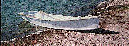

Paul Krayniak of Odessa, NY, built the prototype QT, his first boat, in a couple of weeks. Here is the letter he wrote me:
"Hi Jim,
Building Qt was very easy and a great learning experience. I have read Payson's books, so there were no real surprises in this project. As you know, I mostly used hand tools, and really didn't need much else, though the oar I built with a belt sander was quite a revelation. I used a rasp, handsaw and plane which were my grandfather's, so that added something to the experience. Altogether, including making oars and painting, I spent about 60 hours abuilding. I used polyurethane glue, which worked fine, but makes a real mess when it expands into foam, and costs more than epoxy. She was painted with alkyd porch and deck enamel, which gives a very nice finish and should be extremely tough (according to the salesperson). The plywood was AC exterior, the other wood was yellow pine. If I were doing this project again, I would use fir instead of pine, the Weldwood glue as recommended by you, and latex paint since the alkyd takes a long time to cure. Also, I think Grandfather's memory has been honored enough, and I would use a table saw and a belt sander for sure.
When I took QT to the water for her first trial, it was quite windy and I hadn't rowed for many years, so our path was pretty erratic. For the next trial, I adjusted the oarlock position up the oars an inch, moved their pivots two inches astern and adjusted my seat to get the level oars at belly button height, per your instructions. It was still pretty windy but the rowing went much better. The next time out, the wind was calm and we went for quite a long way, about 5 miles. I was very impressed with the small rowing effort required with this boat, and we covered the distance easily in about an hour and a half.
This testing was all done with my wife and me aboard. As I mentioned to you before, we are both big people. Frankly we had some doubts about quarter inch plywood holding us up, but it seems very sturdy and tolerates us walking on the bottom just fine. Also, we are able to change places and otherwise move around in her OK.
We tried putting our 70 pound grandson in with us and it didn't work well. If he sat in the back, the drag increased noticeably, and if he sat in the front, the stem was immersed and the drag was bad. Our impression was that she does best, given the limited places to sit, with two people of about the same size aboard. I'm sure, though, that all boats need to be balanced to do best.
The project has been loads of fun and the most satisfying thing I've done for years. Thanks.
Paul"
Later Paul reminded me that the idea behind his QT was first to have a boat to carry atop his motorhome.
He added, "QT fits very well on our motorhome. I made a simple bow holder from a short piece of 2x6 bolted flat to the roof. It has an outline of the wales routed into it, and I just hook the bow gusset over it. With lines running from eyebolts in the 2x6 to an eyebolt through QT's stem, it ain't going anywhere. The stern is fastened with lines down to the bumper braces and tied to the ladder to prevent lateral movement. The oars fit nicely with my fishing poles in a 10 inch square compartment which goes all the way across the motorhome. My wife and I can have her ready to travel or row in 5 minutes."
Well Paul certainly did an excellent job. One comment about his experience. Trimming you and your boat for level operation is very important as he points out. Always take the time to do it. I always give oarlock locations on my drawings but they are just suggestions and don't be shocked if you have to tinker with them to get the boat right. Often you can't tell if the boat is trimmed right without having an observer dockside to advise. If you are rowing solo or with passengers, you will need separate oarlocks for each configuration. When Paul tried to row with his grandson making a crew of three, it didn't work because the boy's weight ended up in the boats ends and threw off the trim. The usual solution would be to put the boy between the two adults, in the middle of the boat. But QT may not really be big enough for three, she's only 13' long.

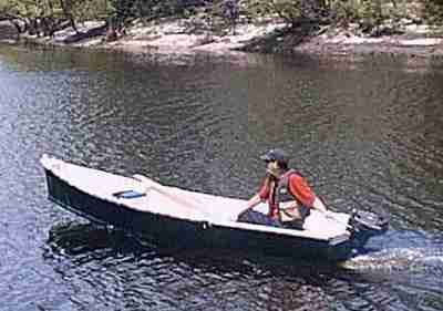

The QT plans also included a page of the same hull set up for a small motor, say 5hp max. Eventually one got built by Barron Wester. He he goes...
So you get both the rowing plans and the powerboat plans in the same packet. This is a simple nailed together job from three sheets of 1/4" plywood. No jigs, no lofting.
