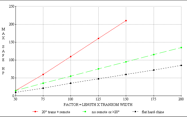

Next I'll try to conjure up the chart for boats with factors above 52.
Here we have three selections. The red solid line is "FOR OUTBOARDS WITH REMOTE STEERING AND A TRANSOM HEIGHT OF AT LEAST 20 INCHES". I've limited the factor to 200 which would be a pretty large boat, 25' x 8' for example. But in the pamplet there is no limit to the factor so to power an even larger boat you could extend the straight line as far as needed with the same slope.
The green dashed line is "FOR OUTBOARDS THAT DO NOT HAVE REMOTE STEERING OR TRANSOM HEIGHT IS LESS THAN 20 INCHES".
The black dotted line is "FOR FLAT-BOTTOMED, HARD-CHINED OUTBOARDS THAT DO NOT HAVE REMOTE STEERNG OR TRANSOM HEIGHT IS LESS THAN 20 INCHES".

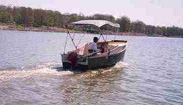

OK, the obvious question is what about flat bottomed boats with remote steering and 20" transoms? I'm pretty sure the writers didn't mean to place them in the high powered catagory. For example my stock AF4 has a 15" transom with 18' length and 4.5' transom width for a factor of 81. By the third line it would have a max safe hp of 25, and having used AF4 I would agree with that. Here is mine planing at about 12 mph with a 10 hp motor at about 3/4 throttle.
But if I raise the transom to 20" with a long shaft motor and add remote steering do I now jump to the red line and go to 72 hp?? If the problem with the flattie is handling in turns I don't see how the deeper transom or the remote steering makes it safer for triple the power. (No doubt it would be safer though). But a literal reading of the pamplet makes it appear that way.

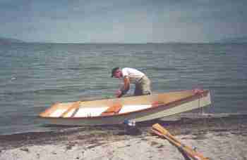

VAMP, LIGHT ROWBOAT, 12' X 3.5', 60 POUNDS EMPTY

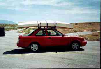

After the success Frank Kahr had with Robote I designed a smaller version with most of the same features. The idea was to get a fast and seaworthy boat that would cartop so easily that you would want to leave it on the car top more or less all the time, ready to go at a moment's notice. From cartopping smaller boats like Toto I had found that they hardly slow the car down or keep a compact car from getting 30+ miles per gallon on the highway. I thought the trick was to keep the boat small enough that complicated tie downs were not required. I also knew that Piccup, at about 90 pounds, is about the most a fellow would want to cartop. Lighter is better, of course, but once the weight gets below 70 pounds the boat becomes so easy to load that getting it super light is not mandatory. The prototype Vamp that you see here was built by Ken Prims of Layton, Utah. Here is his boat atop his compact car, a very nice package as I had hoped.

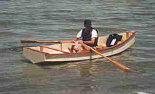

Why not stick to a canoe like Toto? It has the size, weight and shape (mild sheer and squared stern) that makes for easy cartopping. But a good rowing boat can be as fast, dryer, and take a passenger with more ease. The only problem I see with Vamp is that her V bottom can make beaching more challenging than a boat with a flat bottom plank.
Construction is with taped seams from three sheets of 1/4" plywood, the same bill of materials as for the larger Robote. Robote will be a lot better if you are rowing with a passenger all the time. Vamp might be a handier impulse boat for a solo boater, although it can take two adults in a pinch.
