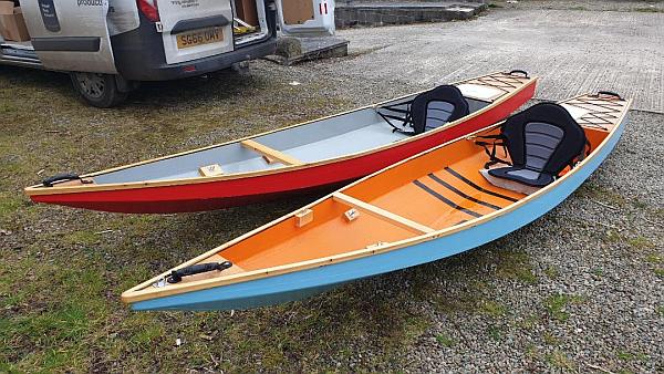

A pair of beautiful Totos from Andrew Parks in Northern Ireland.
