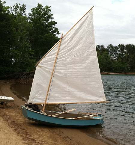

Matt Pinkley's new Piccup Pram is fitted with the larger sail used on Mayfly, Woobo, and others. I've done this with my own Piccup at times and the boat can take it if you can, But ventually you simply can't fit the larger rigs inside the boat while rowing.

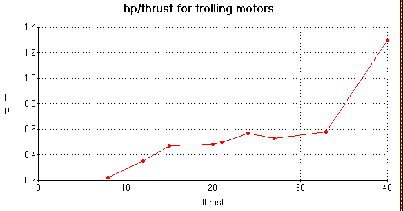

In Douglas Little's book ELECTRIC BOATS he presents some power measurements from typical trolling motors. Remember that his "horse power ratings" are based on current measured TO the motor and not the acual measured output of the motor. Here is a chart I made from some of his tests:

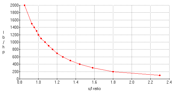

Finally, here is a new chart of approximate boat performance, speed vs hp, that is in Little's book. This sort of chart takes no account of "fast" and "slow" hull shapes so is only a very general starting point for figuring performance.

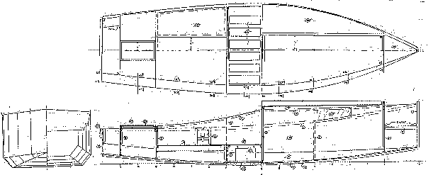

ELECTRON, ELECTRIC CUDDY BOAT, 18' X 5', 900 POUNDS EMPTY
Electron was an interesting project done for a man who had done his homework on electric boats. In particular he had studied Doug Little's great book ELECTRIC BOATS. He wanted a cuddy cabin boat capable of some cruising, the ability to go about 30 miles on batteries when desired.
We started with my old Fatcat2 design, stretched it to 18' and narrowed it to 5', which made it visually a lot sleeker. He told me right off the bat that his figures showed he would need six trolling motor batteries to get the desired range while using a 24 volt, 2hp Minnkota trolling motor at half throttle.

Now we go up to the performance chart to guess at the speed of the boat. At full throttle we might have a lb/hp ratio of 1300/2 = 650. The chart predicts a speed ratio of about 1.15. The square root of the water line length is about 4.12. So the chart predicts a top speed of 1.15x4.12=4.7 knots which is 5.4 mph. Not bad.
Cruising at 1 hp gives a lb/hp ratio of 1300. The chart predicts a speed ratio of about .97. So cruise speed should be about .97x4.12=4knots which is 4.6 mph. Not bad (and it shows how boats can cut their power a lot and just slow down a little).

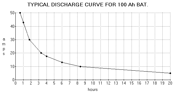

Now let's guess at the endurance. The 24 volt motor running at 1 hp should use 750/24 = 31 amps per hour. The six batteries in the plan are like the 12v, 100 amp-hour battery shown in the above chart (power-wise, they are 12x100=1200 watt-hours each for a total of 7200 watt-hours for the six). They must be first wired two in series to produce three 24 volt sources. So in use they will look like three 24 volt batteries, 100 amp-hours each.
If each battery pair pulls its share of the load, about 31/3=10 amps per hour, then the chart estimates an endurance of about 8 hours. keeping the battery draw to 70% maximum would imply an endurance of 8x.7=5.6 hours. At cruise that means 5.6 x 4.6=26 miles.

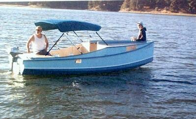

An Electron was built in California...
...but never had the electric system or sail rig. Shown here it had a 2hp Honda as I recall, which might not be enough in brisk conditions which might also be true with most electrics. Later he went to 10 hp with it which is well beyond the limits of the hull but I suppose you can always throttle back. What happens is that at high power the boat will try to raise its bow and plane but with a sailing type hull the stern is too small to allow doing that under control and your bow points up to the heavens out of control. So my 4hp theory never got a test. The 2 seemed too small and the 10 is too large. Almost any larger sailing boat can make a nice power cruiser provided the power is kept quiet and reasonable and you never intend to go faster than the sailing speed. Just leave the sail rig at home. Your boat will be simple, quiet and smooth and free from the usual restraints of the wind.

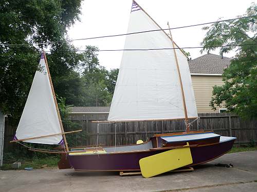

The Texas Hapscut awaits testing time. (He has scarfed some material on the stern to finish the boat with a built in motor well like Laguna. Good idea.)

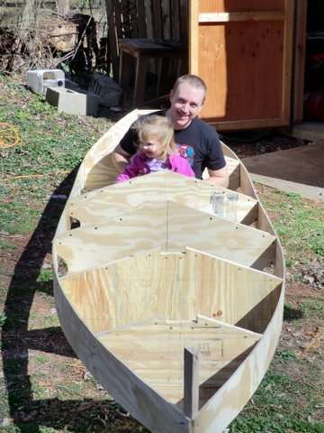

And here is a custom project going together so quickly that I am going to hold releasing prototype plans, just release "done" plans in a few weeks. He also already has a crew. As I write this boat also is complete and awaits testing.
