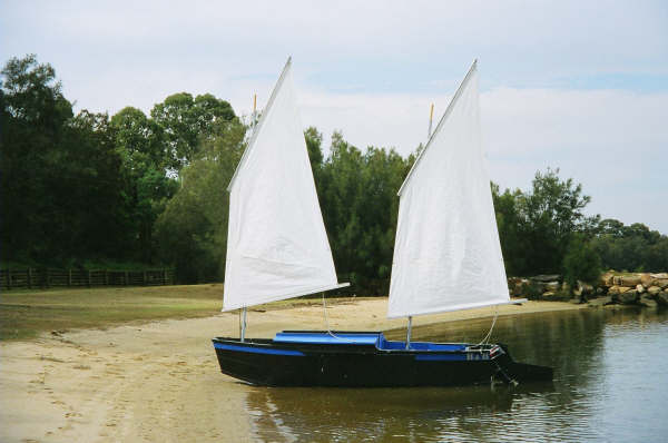

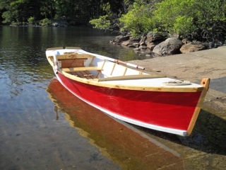

Richard Maldonado built this delux QT Skiff for rowing and maybe sailing. Quite a pretty job!

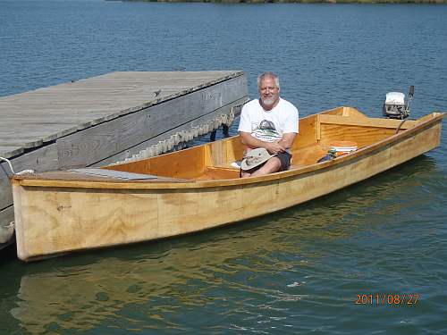

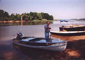

(Here is a photo of Max at our last messabout beside his boat. The motor is an early 40's 22 hp Johnson. No doubt Max is contemplating starting it, where the boater spends about five minutes wooing and courting the motor, climaxing with wrapping a cord around the flywheel and giving a mighty pull (sometimes over and over again). When she starts with a pounding throb your concerns have only started for the motor is direct drive and 22 hp will will push that little boat very quickly. You had better be pointed in the right direction. The motor is water cooled but there is no pump - it works on head pressure from forward motion so you can't idle long either. Outboarders were hearty men back then, not like the button pushing wimps of today.)

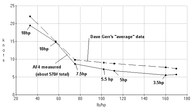

Pulling out the mandatory graph...
WHAT DOES IT MEAN???...
One observation is that at about 7 or 8 mph the bow of AF4 starts to lift a few degrees and I suppose it has met the "hump" that comes before planing. By about 10 mph it is on full plane. Above about 15 mph the bow starts to come down again and at 22 mph with the Johnson 18 the boat was about as level as at pure displacement speed, although it is skimming over the water at that speed.
Remember that Dave Gerr's information above is a very "standard" thing for an "average" boat. The smaller motors tend to not go as fast as the chart would predict if you use the rated powers of those air cooled motors. My own feeling is that these motors put out about 2/3 of the rated power, not because they are weak or worn, but more because of the way the vendors lied about their power. For example, I have the original literature that came with the Sea King 3.5. It states very clearly that full throttle operating range is 4000-5000 rpm, but the peak hp is reached at 6800 rpm at 60 degrees F. Many of these motors have power curves that are essentially straight lines starting from zero and going up until the motor blows up. Thus if the Sea King operates at 4500 rpm full throttle as installed on the boat, but peaks at 3.5hp at 6800 rpm on a dyno, then it would to me be reasonable to think that at 4500 rpm the real output is around 4500/6800 x 3.5 = 2.3 hp. If true, then that run is really made at 240 lbs/hp instead of 160 lbs/hp, and then Gerr's graph would predict 6.6 knots. That still doesn't bring it up to Gerr's line and it is quite possible that the wide deep power boat stern simply isn't going to keep up with a better displacement hull shape in the low power tests. But a good displacement hull shape has little or no chance of being driven past displacement speeds under control.
Another factor to consider is that new motors have their power measured at the prop and the older ones were measured with the power head removed from the drive section, as was the 3.5 hp Clinton. Max said the drive train typically absorbs about 10% of the power.
The 10 hp speed falls right on Gerr's line and the boat is fully on plane by then. 10 horse motors are famous for being under rated, that is many put out more than 10 hp. The idea is that "my 10 horse is faster than your 10 horse" is a big plus for the ad makers. Max told me once that the Mercury 10's of the 1950's had more cubic inches than the Johnson 15. I think I once figured my Johnson 10 is putting out about 11 hp to totally agree with Gerr's chart.
I think I could come up with a lot of reasons why the performance fell below the ideal but what sort of surprises me the most is how smooth the measured curve is. And if someone were to hand me an ordinary old motor between 3 and 20 hp I could use the chart to quicky estimate my AF4's top speed with that motor. Maybe someday I'll get to run these tests with new motors.

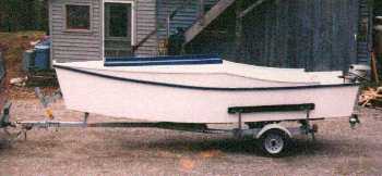

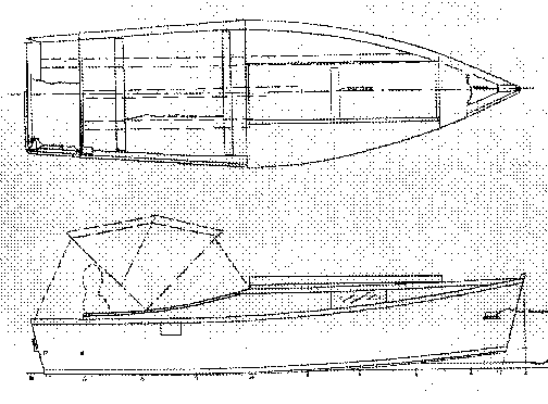

AF4, CUDDY POWER SKIFF, 18' X 5', 350 POUNDS EMPTY

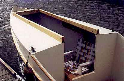

AF4 is a simple low powered cuddy cruiser intended for protected waters. Kilburn Adams of St. Louis brought a boat similar in spirit to AF4 to our Midwest Messabouts and it was easy to see what a good idea this is. Kiburn's boat was a modified Sturdee Amesbury power dory witha a small cuddy added and a new 4 stroke Yamaha 10. He thought the empty boat weighed about 600 pounds ready to go. It planed quite well with two men on board at about 13 knots. He made a 60 mile trip on the Mississippi (above the Alton dam where the current is small) burning about 4 gallons of fuel. It's quiet and cheap to operate. It's a good idea now that smaller 4 stroke motors are more common.
Here is an AF4 by Barry Targan. I think he is using a new 8 hp 4 cycle.
AF4 is supposed to do about the same job. Its simple hull shape won't handle rough going like the dory, but it's very easy to build and roomier. This boat has an open bow well for anchors and junk. The cabin is 8' long and 3' deep and 4' wide for minimal camping. It should be comfy for one and snug for two. it has a slot top to allow stand up boating in good weather. You cover it with a snap on fabric piece in the rain and cold. The cockpit is a full 6' long and 4' wide and totally open. You could lounge there too with a folding chaise. Aft of the cockpit is a draining motor well which will take the standard 6 gallon fuel tank and then some.

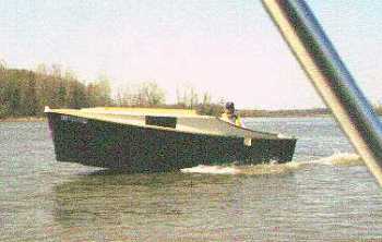

For power Iwould say 10 horsepower maximum. AF4 planes easity with an old Sears 7-1/2 horse (single cylinder, air cooled, for $50 at a yard sale) as you can see here:

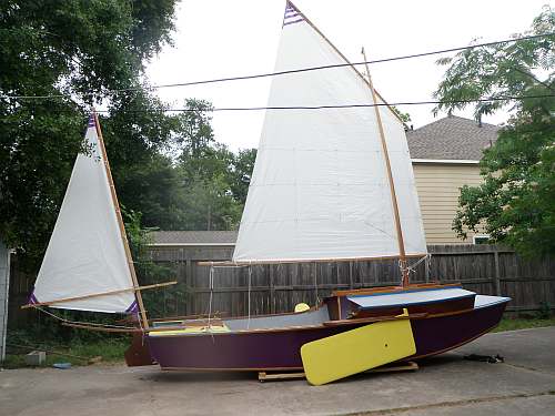

The Texas Hapscut awaits testing time. (He has scarfed some material on the stern to finish the boat with a built in motor well like Laguna. Good idea.)
