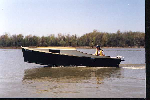

My real AF4 looks like this (back a few years ago when both the boat and I were younger and lighter)...

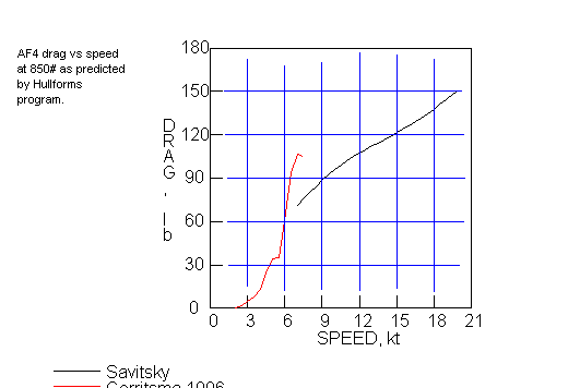

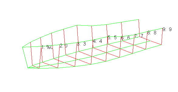

The Hullforms program predicts for this model, at a full weight of 800 pounds (about real life) and a cg location 11' aft of the stem, this drag vs speed chart (I've added grid lines to make guessing easier).
Well now, if such a chart is accurate can Hullforms be used to predict the performance of a boat given a certain weight and trim and power??

You might recall in the "horsepower" essay from a few issues ago that horsepower is basically speed times a load. Hey! That chart above is speed times a drag so it can be used to figure the horsepower pushing the boat. Does it work? Let's take an example. It is known that in real life my 15 hp motor will push my AF4 at about 18mph tops. But when I look at the Hullforms chart I see that at 18 (about 15.6 knots) mph the hull will have about 120 pounds of drag. 18 mph is 1600 feet per minute so the speed times the load is 190,000 pounds - fpm. A horsepower is defined as 33,000 pounds - fpm so the chart predicts 5.8 horsepower needed to get 18 mph on the AF4! Not much agreement there.

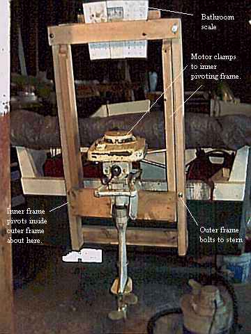

I tried to think of ways to measure the thrust at the prop as the boat was underway. If I were a true tinkerer's mechanic I think I would try something like this: the motor mounts on a transom bracket that is hinged at the top and has a "load cell" sort of thing on the bottom. I thought that might be a small hydraulic cylinder more or less like an auto's brake cylinder with a pipe that leads to a pressure dial on the dash. As the motor pushes forward at the prop the cylinder gets pinched against the transom which is resisted by the oil inside with increased pressure. Read the pressure in the cylinder with the gauge and you can figure out the total force on the cylinder and from there you can figure the thrust at the prop. This could be a permanent thing although I've never heard of it being done.

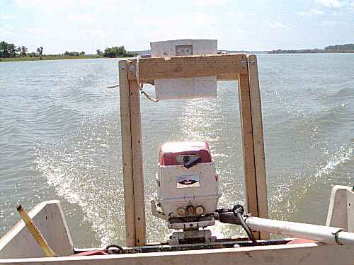

Not being a true tinkerer I settled on a method that relied on 2x4's, duct tape and a bathroom scale. Here is a photo of my Thrustometer.
The outer frame of the thing bolts to the real transom. The inner frame which has the motor mount is pivoted inside the outer frame. As the propeller thrusts forward the inner frame wants to swing its top aft. In doing so it pinches an ordinary bathroom scale which you can read very easily. The scale does not read the prop thrust as 1 to 1. Since the motor mount pivot is about 20" from the prop thrust line and the scale is about 33" above the pivot, the actual thrust at the prop is about 1.65 times the scale reading.
This bolts to the transom with two small bolts. I don't think it will take for very long the stresses of trailering so I mount it on the hull after the boat has been launched. Also the thrustometer is not braced in any way to take reverse thrust of the motor so that is a no no. I tried to keep the motor mount as close to the real transom as possible so that the motor geometry would be as close to the real use geometry as possible. I thought the limiting factor here would be the motor's clamping handles and I left just enough space for them. But in use I found I can't tilt the motor forward with the thrustometer so care is needed that way in addition to not being able to use reverse. Plan ahead.

These bathroom scales are wonderful things and I must take one apart sometime to see what makes it tick. This one cost $3 at Dollar General. When I hang a motor on the Thrustometer it's weight alone puts pressure on the scale. No problem since the scale has a wheel to zero that out so all tests start with zero.
First testing was done with a 1956 Montgomery Wards 12, a Gale made motor that is essentially an OMC. I could tell the moment I popped it into fwd that the Thrustometer was OK. Testing actually only takes a few minutes using a gps. Starting from idle in fwd let the motor and boat settle to a certain throttle setting and write down the speed and scale reading. Increase throttle to a new speed and so forth right up to full throttle. Afterward figure the prop thrust using the 33/20 factor of the Thrustometer's geometry and that is the prop thrust, right?
In detail I don't think it really is the prop thrust because the drag of the lower unit never gets into the system. The lower unit drag I think cancels itself out and never gets measured. So the prop thrust is no doubt actually greater than what I am measuring. BUT THAT IS GOOD! I think what is really being measured here is the thrust actually pushing the boat forward. It is the force that counteracts the drag predicted by the Hullforms chart!
Also I think that in detail the Thrustometer seems to slow the boat down about 1mph. At least with the two engines I used I got that result both times. It could be the extra weight in the stern, something AF4 has never cared for. Also I noticed a lot of splashing going on back there that is not present usually. The Thrustometer mounts totally above the bottom of the hull so I don't really know what the splash is about.
Here is a photo of the Thrustometer in action with a Montgomery Ward's 15 mounted (another Gale OMC motor from about 1960).

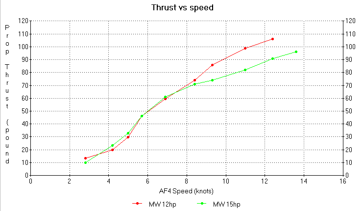

I plotted the results of the two motor tests and got this:

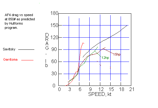

Here is a chart of the testing results on top of the original Hullforms prediction.
I thought they matched pretty well all things considered. The big "hump" predicted by the low speed professor never happened with my AF4 even though I went looking for it with several test runs in that speed range. Perhaps if you are properly prepared you really can use the Hullforms charts to predict speed for new hulls or effects of weight and trim.
Note that the MW12 and MW15 lines don't agree above "hull speed". (They were for all purposes identical up to that speed.) I think they should agree and can't think of any reason why they don't. I thought when I did the MW15 tests that the Thrustometer might have been binding somewhere to give the odd results but I ran that motor a second time with the same results. To be sure I gripped the Thrustometer together with my hands which sprung the scale beyond the range of the test and it bounced right back to zero freely when I released pressure.
Secondly it is interesting to wonder where all the horsepower goes. Only about 30% of the rated power is used to push the boat forward.

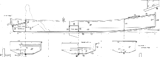

Brucesboat followed pretty quickly from that. I kept the plumb bow, easy to build and lots of folks like its looks. The multichine shape is very good in rought water. it's not as stable as a flattie of course but sometimes I think it is safer in that you must walk on the center of the boat because you can;t step on the slanted bilge panels. Your weight is always close to centerline where it should be. I made the main cross section 6" wider than Woobo and a bit deeper. From the center aft the bottom is straight and flat. The sides could be that way too, but I pinch them in a little and sweep the sheer up in the stern a bit for looks. I gave it a skid/stiffener on centerline so she would stay put on the water. These multichine boats have little lateral resistance on their own and sometimes would just as soon go sideways as forwards.
I'm a big chicken on power and would keep this one at 10hp max. I think the main problem will simply be the weight of the motor, fuel and skipper in the stern. I've never designed a downward hook into the bottom to cope with bow wanting to go skyward, although some swear by that hook. The boat could be trimmed with wedges glued to the bottom stern if needed.
I kept Woobo's light taped seam construction and the plywood bill looks like three sheets of 1/4" and four sheets of 3/8". That's about 250 pounds of plywood and I would expect the finished boat to weigh about that much. The bow is boxed in with a storge/buoyancy chamber, the middle has a stout boxed thwart, and the stern is boxed in with a draining motor well. There are actually two places in the boat long and wide enough to lie down in. It might be a reasonable expedition boat given a small motor that burns little fuel and a canoeist skipper who is used to roughing it.

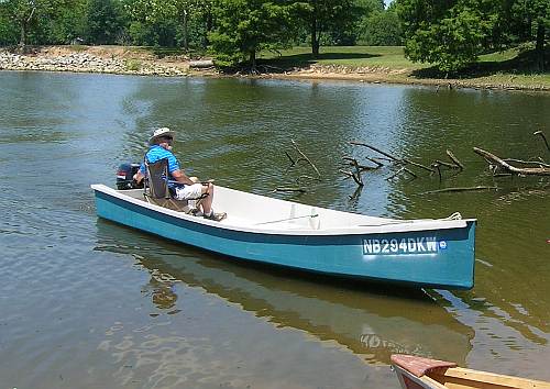

Brian Nimmo built the prototype:
He brought it to Rend Lake with fresh paint and a new 10hp four stroke...
And I hopped aboard for a ride. He had his gps with him...
Very nice I thought. He will be using it to run rivers. We figured we were at about 800 pounds total. At 8 mph she started to lift on plane and at full throttle was doing 15. She banked her turns nicely, something you can't expect a true flattie to do.
