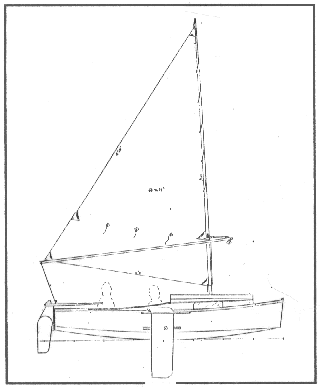

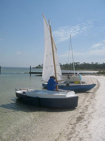

On a quiet beach on the Florida Gulf Coast two cuddy cabin boats get ready to sail. Closest is Tim Gosnell's Toon2 and afar is Gary Blankenship's veteran Frolic2.

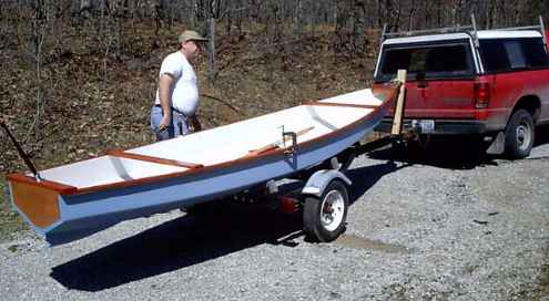

I've been showing photos of Max Wawzyniak's Oracle prototype for the past few month. The project was done a while back but we were frozen in until about the first week of March. Then it all burst out then and we had a day in the 70'sF and it was time to launch. That particular day the wind was gusting to 30 and no testing was going to get done but it was a good day to take photos and also to set the boat up in the way I like to see it done.
We went to Washington County lake here in Illinois which is about a mile long and with many arms, steep hills around and a shallow launch ramp in a protected area. A very nice rowing lake.

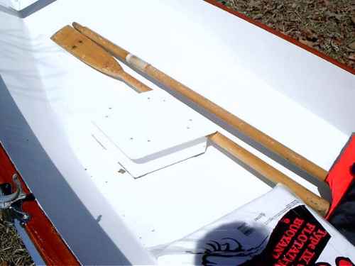

Max unloaded his new Oracle and showed me his gear. He had made a low rowing seat, 3-1/2" high, and had some nice 8' oars. The seat looks low but you will usually have a cushion on top and this is a low sided boat. This seat turned out to be just right for Oracle.

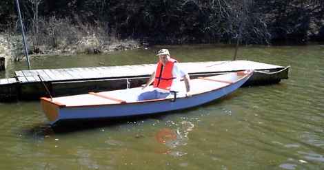

Next the boat was placed in the water tied loosely to the dock. Max climbed in and we looked for the seating position that would provided a level boat.

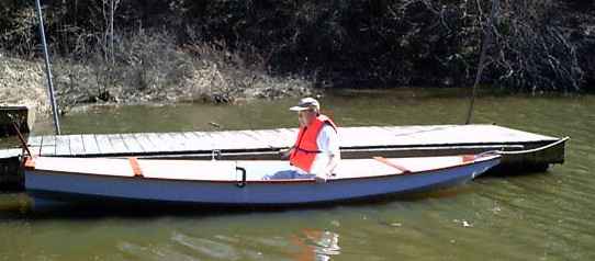

Here he is too far forward and you can see that the bow is down and the stern is up. I might add that it really takes two people to get this just right - one to be the skipper, and another to watch for the correct trim since seeing the trim from inside the boat can be difficult.

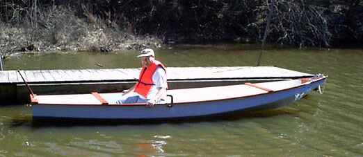

Here he is too far aft. The bow is up and the stern is down:

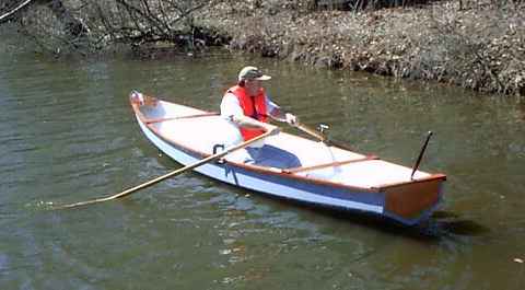

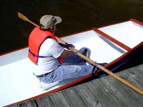

Sitting in the properly trimmed boat Max holds the oars comfortably and notes where they cross the wale.

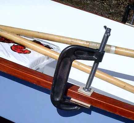

At those points he places a large C clamp in position to simulate the rowlocks.
Now for a test row using those C clamps as thole pins. If the clamps are large enough you might pass the oar through the opening or you might tie the oars to the clamps. In this case Max was just careful to keep the oars against the clamps.

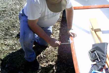

At this point you can shift things around. Once you find the best place for the oarlocks, note the position and install the lock sockets. In this case Max used common sockets mounted outside the wale. He screwed them into position for now, to replace the screws with small bolts in the future. (Screws have a bad habit of working loose at the worst time.) Sockets mounted outside the wale instead of inside? They function a lot better outside with no chafing on the wale but if you are using the boat as a tender then inside the wale might be better because there will be no metal to gouge the mothership.

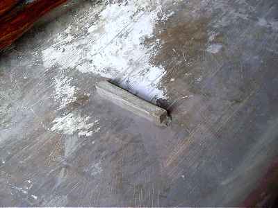

Not quite done yet. A good rowing setup will also have cleats inside the hull against which you can brace your feet. It's not a big deal in calm conditions but for rowing hard, and in some conditions all rowing will be hard, the cleats will make a huge difference in the amount of force you can deliver to the oar.
Max didn't install his on his test day but the cleats can be about 3/4" square and 6" long and mounted in a comfortable position. Many rowing boats will have several cleats spaced maybe 3" apart to allow for different sizes of oarsmen. Here is a photo of the cleat in my old Roar2. It was meant to be a temporary fit and was plopped in place with a blob of Bondo. Still temporary after 12 years!

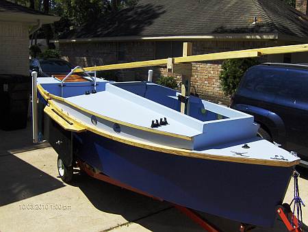

As I am writing this there are two Toon2s afloat that I know about. Both were recently launched. This one by John Wolf in Texas..
...was made with the blueprint sharpie sprit rig. He says it sails fine.

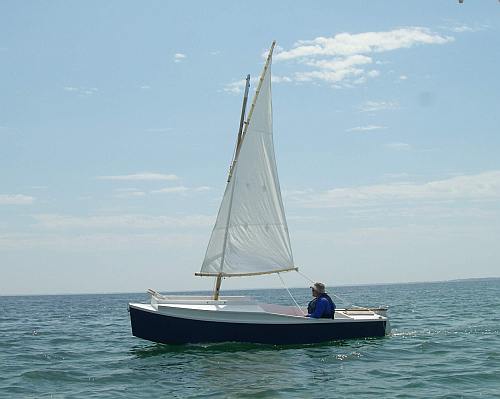

And this Toon2 by Tim Gosnell in Florida has a balanced lug sail adapted from the AF3 lug sail plans...
This Toon2 is also said to be a fine sailor. Compared to the stock sharpie sprit sail I would expect it to sail not so close to the wind. On the other hand it will certainly be easier to tow and set up and easier to reef and maybe be as good or better on the other points of sail. It's all the usual tradeoff. Note that it is not really a large boat and that the weight of the skipper in the stern affects the trim quite a bit. So with fine tuning she will be faster and better all around with the weight more forward. Then again, for lazing around on a slow day I found with my Piccup Pram that trim was not that critical and if the skipper lounged comfortably against the aft bulkhead, it looked bad but it sailed good. On its maiden voyage Mark's Toon2 was cruising all well with a Frolic2 and a Wooboto.

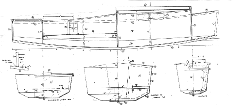

Toon2 uses taped seam construction with no lofting or ladder building jig required. She needs seven sheets of 1/4" plywood and two sheets of 1/2" plywood.
