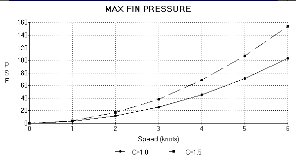

(Here is a chart that you can use to figure the pressure that water exerts on an underwater board at various boat speeds. I've shown two values of the force coefficient, C=1 that I recommend, and C=1.5 for you optomists.)
That is actually a pretty large board for Frolic2. As designed it has about 4.4 square feet of leeboard immersed. What does that mean? That means that with two big boys sailing on the rail in 15 knot winds, they need to maintain a speed that will produce about 129/4.4 = 29 psf on the leeboard. If you look at figure 2, you will see that is 3.2 knots. If they don't do that here is what happens. The crew will slide off to leeward. Rudder movements intended to increase the board's angle of attack and thus its lift will do no good. About the only things they can do to regain complete control would be to head downwind a bit (to increase the boat's speed), or let out the sheet a bit to feather the sail somewhat and thus reduce the sail load to something the board can handle. If they try to "pinch" the boat closer to windward, their hull speed will diminish more, they will be stuck, bouncing up and down in the waves, probably going one foot sideways for each foot forward. I've been there many times! How about you? (Another solution is to reef to reduce the sail force.)
