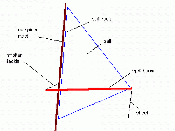

The Jinni was itself an update of the sharpies of the old days. Made of plywood, flatbottomed, shaped like an old flat iron (with special Bolger bottom rocker) and complete with a yawl rig set with a very large sharpie sprit main with a small sharpie sprit mizzen. (My Jinni eventually evolved into my AF3 design which shares the same main sail and mast). To refresh, here is a sketch of the sharpie sprit sail....
Pretty simple. These can be wickedly effective in that you can tighten up the sail, bow and arrow style, by hauling the snotter good and tight and a two or three part tackle on the snotter is the way to go. That will bend the mast aft and flatten the sail if needed just like modern racing boats. I think one great advantage seldom mentioned for this rig is that it can be set up by a beginner correctly from day one, although it may take him a while to learn the tricks with the snotter adjustment. They work great with a free standing mast.

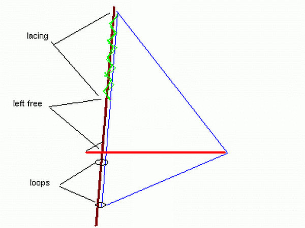

I think I relied on Chapelle's writings for this. This sharpie sprit sail saw very wide use a hundred years ago in work boats that were locally built and maybe the Herreshoffs down the road could get all the sail track hardware they wanted but the local fishermen couldn't. So they laced the sail to the mast. I tried that and it works great if you aren't gonna reef. But on the 200 pound Jinni with 125 sq ft of sail reefing was very often in order. Now the problem becomes how do you lower the sail with lacing when it has to clear that snotter tackle. Can't be done quickly or safely solo says I in the conditions that made you want to reef to start with. I did find moderate success with lacing only the top half of the sail to the mast, the bottom held to the mast with just two loops around the mast, both below the snotter attachment. This worked in a pinch although it would upset the lacing at the top of the mast in the lowering process to use regular slab type reefing bundling up the extra cloth at the foot of the sail. Like this:
I hope you see how it works. You can lower the sail with the halyard down to where the lacing starts to hit the snotter tackle and no more. You can't easily lower the sail totally as you can with real sail track.

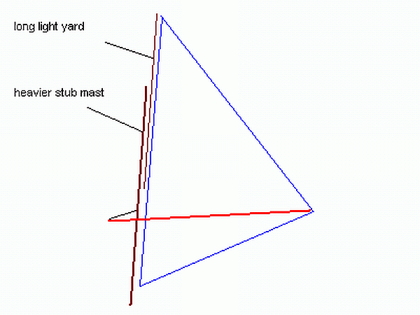

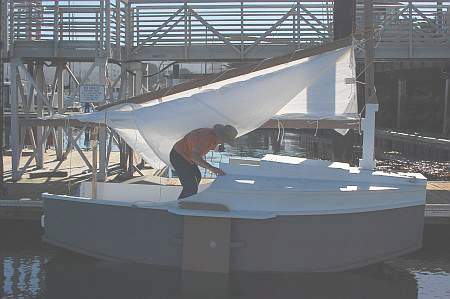

In the second updating of the Birdwatcher Phil added more sail but did not go with a taller mast. The original 25' mast is about all one man can put up by himself at a calm anchorage. So to get a taller sail he used what he called a Solent Lug in his book. It is essentially a true lug sail but uses a triangular sail, like this...
So the sail was not attached to the mast at all except at the tack. It was laced to the yard which was hoisted to the mast like any other lug except in this case it would hoist to the vertical position. The yard needs to be a lot longer and heavier below the hoist point than above so that it stays vertical. And as with any other lug you can drop it all at once and work with it on deck to reef and rehoist.
This is one rig I've never tried myself. You might ask how it is different from the gunter rig. The gunter is similar but the yard is a lot shorter and is attached to the mast with jaws, not unlike say a gaff sail that has its gaff hoisted all the way to vertical. I've never tried the gunter myself either but apparently there can be an issue with jamming up there and having it cock this way or that upsetting the sail.

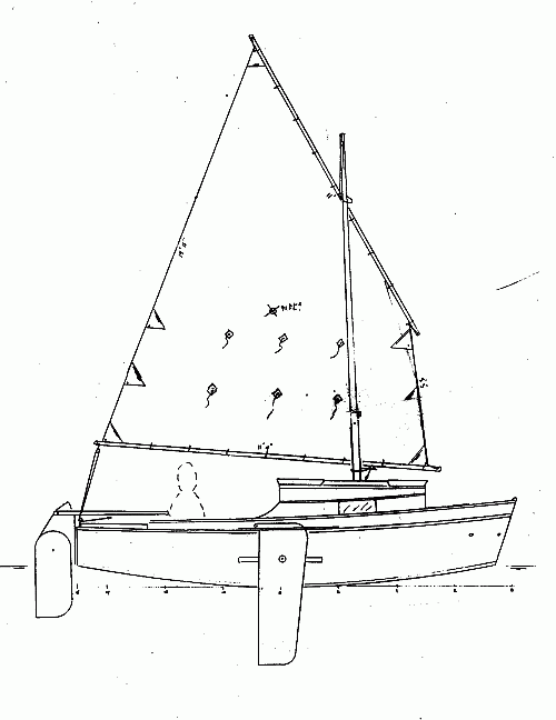

I found this gem in L. Francis Herreshoff's great book SENSIBLE CRUISING DESIGNS. I take it the Herreshoffs made a good living designing and building yachts for the rich folk of Long Island Sound, but in all their writings you will find a real base of small boats, beautiful yet surprising simple and useful, I used to read this stuff over and over when I got started and when I review it now I see where my ideas (and maybe Bolger's) had a subconsious or consious foothold in the Herreshoff ideas. So if you can get a copy of this book look it over deeply and mine out many details. L. Francis was big on small beach cruisers, the sort of thing that I have tried to do over and over. Mine are no where near as elegant but you don't really need to be an experienced boat builder to do mine. Heffeshoff thought plywood was for dummies and fiberglass was frozen snot, but that was almost a hundred years ago. Anyway, in this book among the rich yachts I see small open beach cruisers with leeboards and lug rigs, etc., all standard for me now.

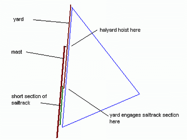

In the book are complete plans for the H14 sailing dinghy. It's a beauty. Its daggerboard gives it away as more of a performance boat than a beach cruiser but I note many practicalities in the design. L. Francis wrote:" As for the rig, I believe it is most important to have a sail plan that can be lowered away instantly, so I have adopted an improved sliding gunter rig. With this rig the dinghy can be rigged or unrigged very rapidly, and when reefed there will not be a long masthead above the sail which is often detrimental in a sailing dinghy."
Here are the basics of the H14 rig:
OK, what L. Francis did was simply attach the lower end of the yard to a short section of sailtrack attached to the aft face of the mast. I copied it with my Jinni because even on the prairie I could get a four foot section of sailtrack that would be plenty for the job. Since nothing slides down in front of the mast, as with lacing, the snotter attachment can stay attached as the sail is lowered. So to lower the sail you just release the halyard and it all folds back under control, unlike a true lug yard which can require care when it is not fully hoisted. You can leave it all down if desired and reef in the cockpit without standing. Once reefed I used a second hoisting point higher up the yard, the entire sail now would be a lot lower than originally, the sailtrack connection didn't need to be reset in any way. It just didn't slide as far up the mast track when reefed. The attachment from yard to sailtrack needs to be somewhat loose to keep from binding but I just used a normal sail slide with a 1/8" steel rod bent to a U and welded to small plates that bolted to the yard. It was slick. It was safe. I could drop and rerig it in terrible conditions without leaving the cockpit or standing up (Jinni had that mizzen which kept it head to wind in a bad patch).
Got to admire Herreshoff. I just noticed the H14 was 14' long and both the yard and boom are 13'6" long, a little sign that he was thinking way ahead for his boaters.
