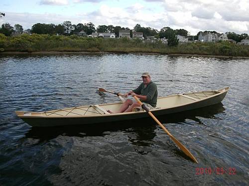

Jake Millar rows his rocketship! This is the Batto design which is a plywood update of Pete Culler's Bateau design. Jake has added both old and new, adding Culler's original trim and Jake's own sliding seat (the original and my plans show a fixed seat).
