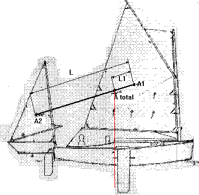

I have to rerun this essay every year. This subject is the most common area where tinkerers of designs get in trouble. It always has been and always will be. Anytime you modify the sail rig you need to keep this math in mind.
sail balance

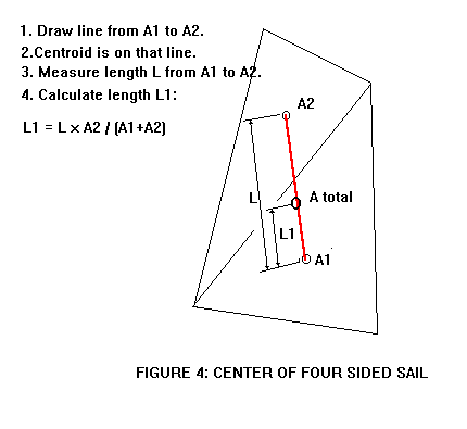

THREE SIDED SAILS...
3 sided sail
triangle centroid
FOUR SIDED SAILS...
area of four sider
centroid of four sider
