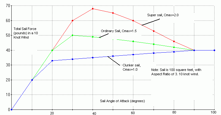

Let's look at this rough curve I gleaned from the writings of the great Polish sail scientist Tony Marchaj.
What we have here is a graph showing sail force, in pounds, at different angles to the wind for a 100 sq ft sail in a ten knot wind. There are three lines shown to cover the "efficiencies" shall we say of three grades of sails. Fabulous sails can produce more force per square foot that ordinary sails, at least up until they stall (or luff to a sailor). Sails have been studied in wind tunnels for a long long time, way before Marchaj. They are essentially wings and the values shown here closely agree to curves for real aircraft wings, although the aircraft designer has little interest in how the curve goes way past the stall point. But sailors do care about the sail force past the stall point since this is "downwind" sailing.
Anyway, a super sail, state of the art, might have a peak force coefficient of 2 and a crude sail might start to lose efficiency at a coefficient of 1. For a real life example I suggest using the 1.5 line. I think that would be a pretty good sail for the home built boat. But notice that once the peak is reached and the sailor turns downwind all sails have a coefficient of about 1.2. So damn near anything will go well downwind if you can control it - no need for fancy stuff here.
If we use our first example of the unballasted boat with H=10, then it takes 40 pounds on the sail to knock the boat down and if the boat had the rig shown on the chart, that happens in a 10 knot wind. Now, I think in this case we have an acceptable answer, that is to say this 100 sq ft rig is about right for the job here. I know ten knots is not a lot of wind but where I live the lakes will start to whitecap then, a visual indication that you are in for a rough sail in this boxy boat.

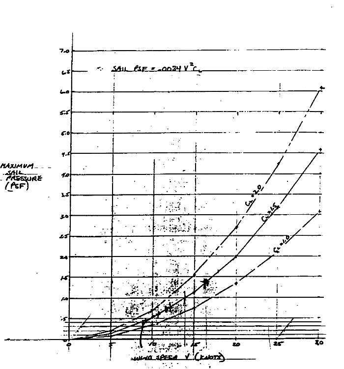

Here is a chart I whipped up to show the wind/force relationship. It shows wind speed vs pressure (in pounds per square foot) for the three sail efficiencies we discussed.
One number I like to keep in my back pocket all the time is that a 14 knot wind will produce about 1 pound per square foot force on a normal sail. So in the examples the 100 square foot sail will produce a 100 pound force and the 60 square foot sail will produce 60 pounds. Both in theory will capsize the example boat with no ballast. It doesn't take much of a gust to burst from 10 to 14 knots and thus the exciting/dangerous aspect of sailing in gusting winds.
