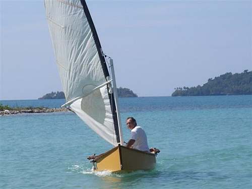

This was from Walter Platzer in Bankok, Thailand. Beautiful! Walter wrote:
"Dear Jim,

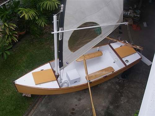

Attached are some pictures from building and sailing Mixer.Started building in Nov.2009 and finished in March 2010. In Thailand localy manufactured exterior plywood is of good quality but heavy( Keruing wood is used).For the bottom I used 7 mm (35 lbs ! )but for everything else on the hull I used 5mm(22 lbs ! )and the wood for framing the transom and side framing the bulkheads is red cedar(not western).Did not glass the bottom. Mixer completely stripped and ready to put on the car roof weighs exactly 100 lbs. I finished all the spars for a balanced lug but then I built a stub mast(60mm square cross section) and use my old windsurf sails on a bamboo spar which is pulled up to the stub mast through a 2 to 1 purchase.Works rather well. Drawback is no reefing possibility and have to lower the sails and change to a smaller one (have 5 sails from 45sqft to 67sqft).The seats which are demountable make the boat much more comfortable and give you the possibility to outride a little bit.I think Mixer is more stable than you expect and standing up and going around feels safe to me(I weigh 160lbs and my wife 98).I like that Boat.
Hope you enjoy the pictures and feel free to use them anyway you like.
One more thing: In Thailand cartopping is prohibited but if they catch you you pay a fine(quite low)which certainly does not go into the state coffers and the best thing is after you paid they let you continue driving :-)
Best regards
Walter Platzer, Bangkok"
Certainly enjoyed the photos. He added some photos showing this is one of the most tricked out Mixers ever, especially when you know it also was built with the original lug rig plus a bowsprit plus a mizzen...

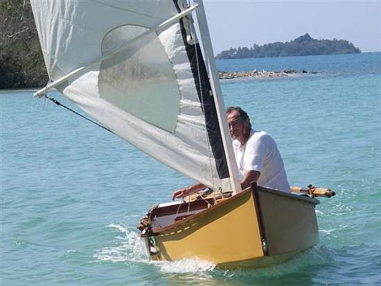

But what about that a windsurfer sail?? Walter sent some photos of the boat in action...
Now the thing that I have heard about windsurfer sails is that in some places there is quite a surplus of them and they can be quite cheap. Apparently they can be about the right size for a small boat, around 50 or 60 square feet. But they are meant to be used with limber masts that are not supported in the usual way, with a step and partner. They fit in a socket on the surfboard, pivoting freely there in all directions, and are held upright by the skipper who hangs on to the sprit boom, which in the windsurfer's case is a double curved wishbone that can be handled from either side of the sail. What Walter had done was support the windsurfer sail pretty much as it was intended, with a limber mast that was stuck somehow in a flexible step and held upright with a stub mast, in the usual Mixer mast step and partner, in a manner that was both strong and allowed the flexible sail system to work.

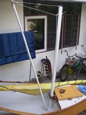

"Jim,

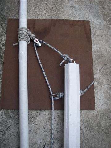

Thank you for the kind words. The system with the stub mast/windsurf mast is very simple. Three issues are important:

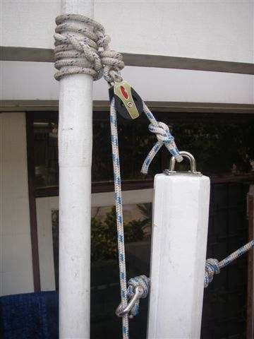

-The stub mast must be firmly fixed so it cannot move upwards.I jammed it firmly at the mast partner with the two wing nuts and the wood across.
-The block lashed at the wind surf mast should be alittle bit above the top of the stub mast.Then the halyard holds the windsurf mast down in its mast foot.
-The rope lashing at the lower end of the windsurf mast has to be a little slack otherwise it will have a lot of tension and may cause some damage to the fixing when lowering or raising the windsurf mast.It is actually only necessary when raising it.During raising this mast it may settle beside the mast foot mold but this is not a problem as it easily can be moved into the mold with one hand before the halyard is fastened.There is certainly room for improvement by tinkering with the geometry of the rope lashing.My mast foot looks a bit overbuilt and could surely be in one piece for both masts.
Most windsurfsails around 5 to 6 square meters(53 to 64sqft) will fit a stub mast which is arranged vertical(parallel to Mixers forward bulkhead)with the leeboard down vertical as well.I made some simple wedges to insert in the mast partner changing mast rake. Did not have to use them yet.
Attached are some pictures which make everything clear without comment.Some are from the early mock up stages, others are without the sail.You can use them freely any way you like.
Just finished a curved sprit boom from bamboo and epoxy since I noticed the windsurfsails do not have a nice shape with a straight boom on the "wrong" side.
Regards, Walter"

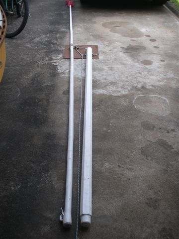

Now some of his detailed photos. Here are the two masts layed down for inspection.
The stub mast is fairly stout and the sail's mast, or yard I suppose, is quite limber. The halyard attachment detail shows an important feature of the rig....
So when you pull tight on the halyard the yard is raised up into position and once raised the halyard also pulls downward on it to press the yard into its own step

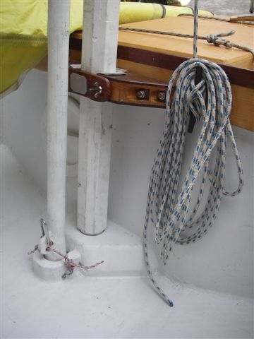

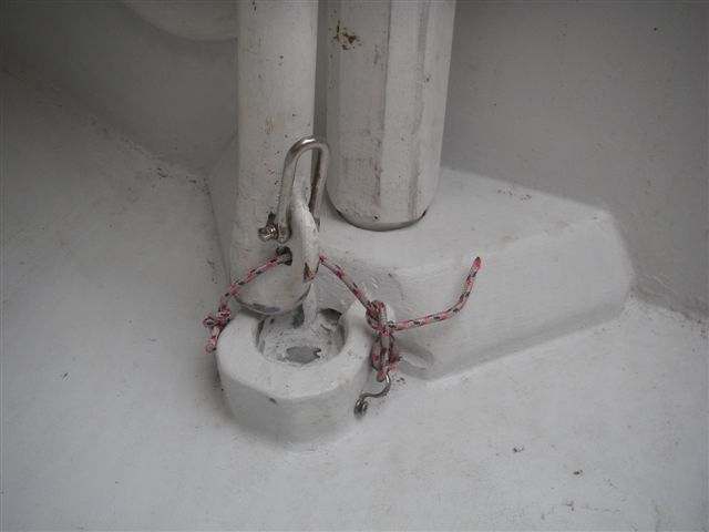

And then is a real clever touch in that there are two steps, one for the stub mast and another for the yard...
Here is a closer detail of the yard step...
Note that it is all rounded, sort of a ball and half socket joint, with a loose lanyard to keep it somewhat in place but remember it is the force of the halyard pushing down on the yard that keeps the ball in the socket. Here is another view of the halyard attachment ....
And another of the yard being hoisted into position by the halyard...
