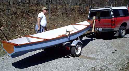

I've been showing photos of Max Wawzyniak's Oracle prototype for the past few month. The project was done a while back but we were frozen in until about the first week of March. Then it all burst out then and we had a day in the 70'sF and it was time to launch. That particular day the wind was gusting to 30 and no testing was going to get done but it was a good day to take photos and also to set the boat up in the way I like to see it done.
We went to Washington County lake here in Illinois which is about a mile long and with many arms, steep hills around and a shallow launch ramp in a protected area. A very nice rowing lake.

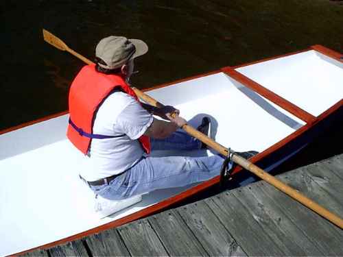

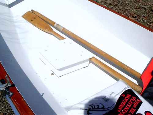

Max unloaded his new Oracle and showed me his gear. He had made a low rowing seat, 3-1/2" high, and had some nice 8' oars. The seat looks low but you will usually have a cushion on top and this is a low sided boat. This seat turned out to be just right for Oracle.

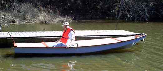

Next the boat was placed in the water tied loosely to the dock. Max climbed in and we looked for the seating position that would provided a level boat.
Here he is too far forward and you can see that the bow is down and the stern is up. I might add that it really takes two people to get this just right - one to be the skipper, and another to watch for the correct trim since seeing the trim from inside the boat can be difficult.

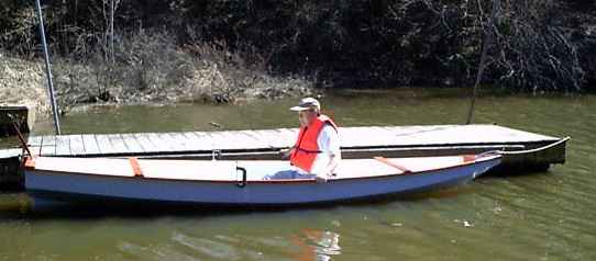

Here he is too far aft. The bow is up and the stern is down:

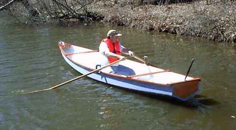

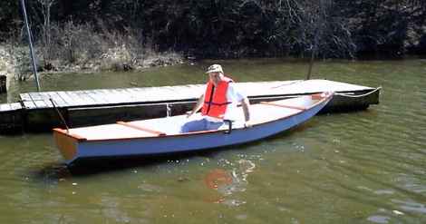

Here he is with his weight located properly for a level boat. At this time he marked the seat location on the bottom of the boat so he could easily repeat the location in the future.
Sitting in the properly trimmed boat Max holds the oars comfortably and notes where they cross the wale.

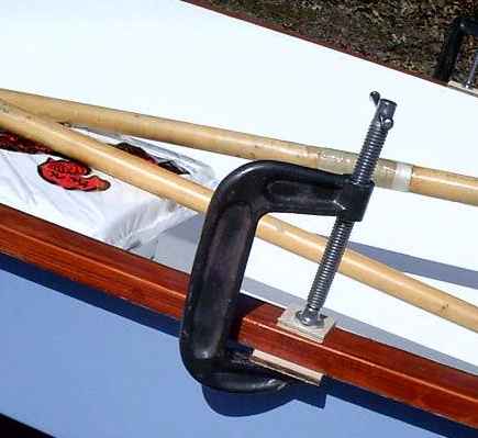

At those points he places a large C clamp in position to simulate the rowlocks.
Now for a test row using those C clamps as thole pins. If the clamps are large enough you might pass the oar through the opening or you might tie the oars to the clamps. In this case Max was just careful to keep the oars against the clamps.

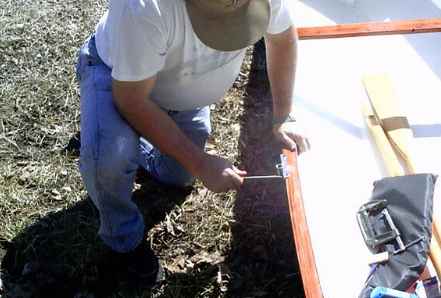

At this point you can shift things around. Once you find the best place for the oarlocks, note the position and install the lock sockets. In this case Max used common sockets mounted outside the wale. He screwed them into position for now, to replace the screws with small bolts in the future. (Screws have a bad habit of working loose at the worst time.) Sockets mounted outside the wale instead of inside? They function a lot better outside with no chafing on the wale but if you are using the boat as a tender then inside the wale might be better because there will be no metal to gouge the mothership.

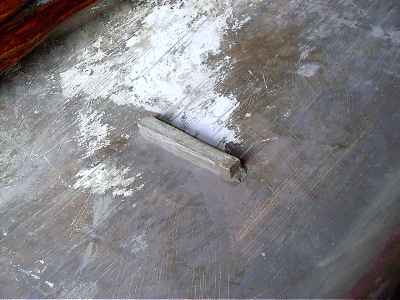

Max didn't install his on his test day but the cleats can be about 3/4" square and 6" long and mounted in a comfortable position. Many rowing boats will have several cleats spaced maybe 3" apart to allow for different sizes of oarsmen. Here is a photo of the cleat in my old Roar2. It was meant to be a temporary fit and was plopped in place with a blob of Bondo. Still temporary after 12 years!

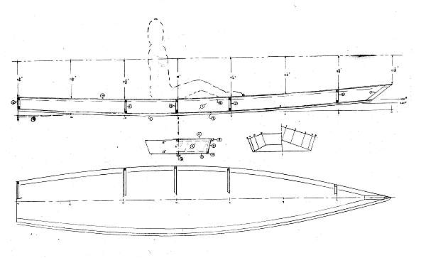

Can you walk this plank? Actually the request was for a stand up paddle board, sort of like a surf board that is paddled while you stand up like on a real surf board shooting the big waves in Hawaii.
I had all sorts of reasons for not designing it, the first being that I could never stand up on such a thing myself for more than a second or two. As a starting point I decided to take the bottom of a light dory, which is usually about this length and about 2' wide. It is generally held that you should never stand up in a light dory and my experiences confirm that. But it looks like the surfers are well ahead of us mortals in that respect and besides they expect to get dumped regularly and maybe the long double paddle offers a bit of stability, sort of like the poles the tightrope walkers use.
So I started with that bottom and added a little top, maybe 4" of freeboard which will not keep you very dry. I put just enough rocker to support 470 pounds before the bow and stern start dragging, enough for two people plus the weight of the hull usually. I can't see two people standing up on this at once but if they both sit it might be a fun wet boat for warm waters. The deck is supposed to be totally watertight, of course, so it will shed water like a duck and be low enough in the water for a swimmer to reboard.
I knew from the start it would not be light, at least not light enough to carry under one arm as they did in "The Endless Summer". Bolger had warned all of us long ago that decks weigh a lot, more than the bottom he said because they must be strong enough to take your weight with no water underneath pushing upward. So Paddleplank will indeed weigh about the same as a light dory. I figure 75 pounds if made with the usual 1/4" plywood, maybe 15 pounds lighter if the topsides are made with 1/8" ply. You can't really go thinner than 1/4" on the bottom and you need some thicker area where you stand, so it is hard to make it much lighter.

Anyway, three sheets of 1/4" plywood with the chines done with taped seams. I have it drawn for jigless construction but you might not get away with that since the sides will be so thin and limber. Thus I have also shown some dimensions to a "base line" so you could set up the initial construction on a ladder frame to hold it all true until the bottom is on.
Prototype Paddleplank plans are $20.
