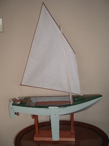

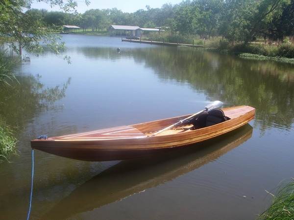

What's this - a strip built Toto??? YES! John Farrell made up flat panels of strips on a bench, cut them to shape by the Toto plans and assembled this super delux beauty. I don't think this has been done before with one of my boats anyway.

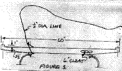

My cross bars, shown in Figure 1, are from 2x4's although fancy pipe bars are available. Make your bars a foot wider than the boat so you can strap oars and sail rigs up there too. Add blocks to the top ends of your cross bars so your hull won't accidently slip over the ends while loading.
My tie downs are 1/2" lines. You want big stuff here that won't stretch and make them plenty long, too. One end is secured with a loose bowline around the interior section of the cross bar. The free end goes over the boat, under the cross bar and belays on a sturdy 6" cleat which is well fastened to the bar. You can secure the rope very tightly and quickly. My system has no redundancy. If any line or cleat comes loose, the boat comes loose. So everything needs to be solid and secure. The benefit is that there is a minimum of things to attend to.

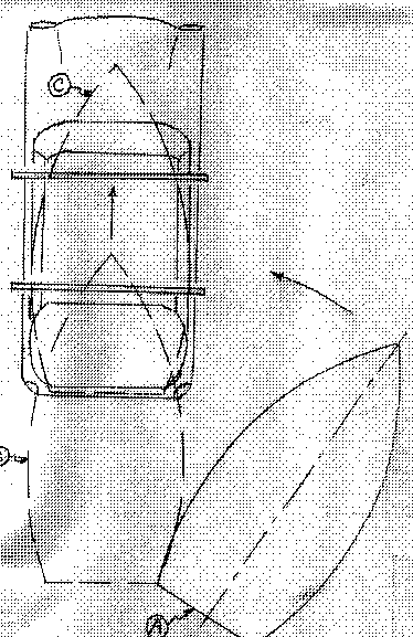

With the major elements in place it's time to load up. Practice helps a lot. First place the inverted boat next to the hull as in Figure 2, position A. (If it worries you that all this flipping and dragging will scratch your boat, most likely you are correct and will be better off with a well padded trailer.) From position A lift the bow ans swing it up to the aft cross bar and rest it in position B. Now lift the stern and push it forward to position C. After a few times you'll get a good feel for where each position is in relation to your car.
Experience will show how far forward the boat should be and you might experiment. I prefer the boat shifted slightly aft of center. Also I find shifting the boat to the right side of the rack reduces buffeting from passing trucks. Don't go to an extreme though, because it's best if the ties pull mostly straight down.

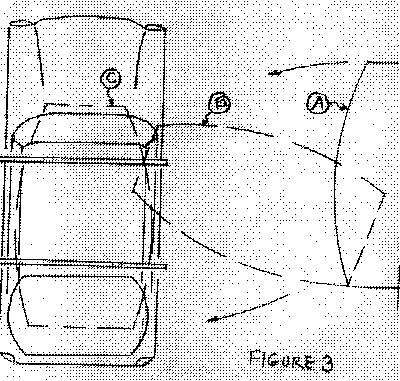

If your boat is too short (or your car too long) to bridge the span from ground to rack in position B, then try the alternate method shown in Figure 3. I use this for short dinghies. Be very careful she doesn't fall off the front crossbar as you swing the stern around.
The hard work is done. You shouldn't have lifted more than 50 pounds at one time.

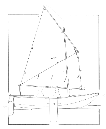

FAMILY SKIFF, SAILBOAT, 15' X 5.5', 350 POUNDS EMPTY
The Family Skiff is large enough to swallow up three men or maybe a family with two kids. She has two benches that are 7' long and there should be plenty of room for all. I would say her fully loaded maximum weight might be 900 pounds and her empty weight about 350 pounds, leaving about 550 pounds for captain and crew and gear.
At the same time the Family Skiff can easily be handled solo, although with just the weight of the skipper she will not be a stable as when heavily loaded. The boat also has two large chambers for buoyancy/storage and I can see her used as a solo beach cruiser because the benches and the floor space are large enough for a sleep spot. This shape of hull has proven to be both fast and able in rough water, a lot better than a similar flattie. I've made her deep, too, with lots of freeboard.
The balanced lug rig sets on short spars and sails very well reefed, in fact can be set up with jiffy reefing. The spars are all short and easily made and stowed, the mast being but 14.5' long and setting 97 square feet of sail. In addition there are oar ports for those with lots of time and little money and a motor well for those with lots of money and little time. Two horsepower is all that a boat like this can absorb without going crazy. The motor well is actually an open self draining well that uses the full width and depth of the stern. It will come in handy for storing the wet and muddy things you don't want inside the boat, like anchors and boots. I've suggested in the plans that the rudder can be offset to one side a bit to give more room for the motor. both Petesboat and Frolic2 have used an offset rudder with no harm other than perhaps needing a curved tiller to make it more comfortable. In the case of Petesboat the 60hp motor was on centerline and the rudder way over yonder to one side with linkage to a centerline tiller. Pete said the large rudder offset had no effect on steering.

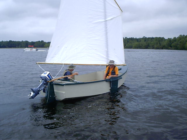

Paul Ellifrit built the prototype in Missouri in a matter of a few weeks as I recall, including this model first:
Then construction went quickly in spite of cold epoxy weather:
... and his own polytarp sail. He brought it to the Rend Lake Messabout:
We agreed there that I should have drawn the mast taller but she was otherwise right on. We had no strong wind that weekend so we don't know yet how she would handle that but this shape hull is about the best I can draw for rough water. She is big and roomy inside...
An ideal family boat in a way. The offset motor/rudder all seemed to work well. We were all happy with the outcome.

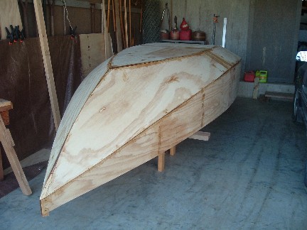

And the first Brucesboat is assembled, ready for taping...
OK, so he found a major league goof in my plans on fitting the bilge panels. He did some cut and fit and did a great job of salvaging the work but I have to correct the drawing for the aft end of the bilge panel (I drew it in upside down!!)
