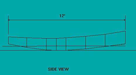

Remember that the prism has the same length as the hull's waterline length and underwater cross section as the boat's maximum cross section. Remember we want a 12' boat, but the waterline will be shorter if we want some rake to the ends (for looks) and maybe enough rocker to make sure the stem and stern don't drag the water (for low drag). We might guess that the waterline length will really be about 10'. Then the maximum cross section would have to have 13.8/10 = 1.38 square feet of area below the waterline. If we wanted a flat bottom 3' wide (wide enough to have sailing stability and narrow enough for reasonable rowing) we would have a draft of approximately 1.38/3 = .46' or 5.5".

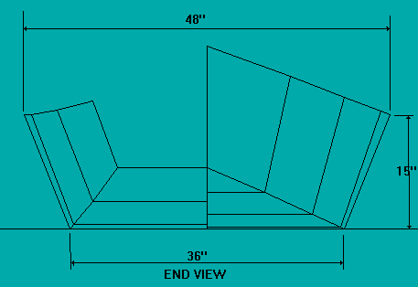

If we wanted a different cross section than the simple box shape I'm assuming here, we would have to tinker a bit. Draw up a cross section with the 1.38 square foot cross section and see if we like it. Actually in this case I'm going to flare the sides out to 4' at the top of the wale at the cross section. But that won't affect the area under the waterline much. We might sketch out something like this:

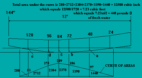

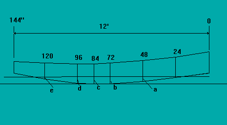

Let's take our proposed boat and draw a line on it that represents 5.5" draft, our guess at what is needed to float 470 pounds. Every now and then along the length of the hull we take cross sectional cuts of the hull and measure the area at each cut below the 5.5" waterline. The cuts can be taken anywhere but there must be enough to get a good definition fo the hull. Actually for a normal boat about five cuts will do. The more you take the more accurate your work but five will get you really close. Our example boat might be like this:

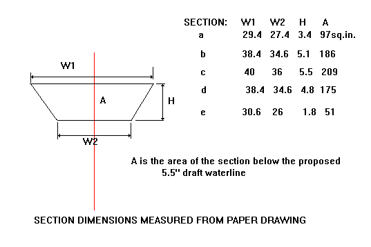

The dimensions of the underwater sections are measured right off the paper drawings and the area of each is calculated like this:
Next we graph those underwater areas spacing them the same distance apart as they are on the real hull to get the "curve of areas" like this:
The area enclosed under the curve of areas is a volume and is indeed the volume of the underwater hull - it's what we are looking for. In the old days you would measure the areas with a planimeter, a clever and expensive gadget. But you can do well by just breaking down the curve into triangles and trapezoids, figuring the area in each trapezoid, and adding them all up. In the example, second trapezoid from the left is figured by 1/2(175+209)X12 = 2304. Adding the sections together gives us a total of 12500 cubic inches at 5.5" draft. That equates to 7.2 cubic feet of displaced water which is 450 pounds of fresh water. So the first guess was off by 20 pounds or about 4%. By the way, the drawing showed a waterline length of 9'5" instead of the first guess 10'.

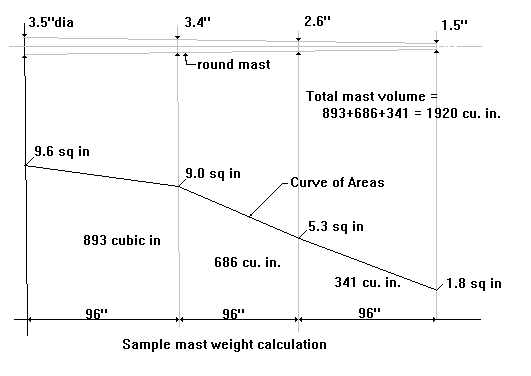

As mentioned before this method can be used to figure the volume of almost anything. Let's say we wanted to find the weight of a mast. Say the mast is 24' long, 3.5" in diameter at the base and 1.5" in diameter at the top, with a curved taper between. The figuring of the volume might look like this:
1920 cubic inches equals 1.1 cubic feet. Wood usually weighs 25 to 35 pounds per cubic foot. At 30 pounds per cubic foot the mast would weigh 33 pounds.

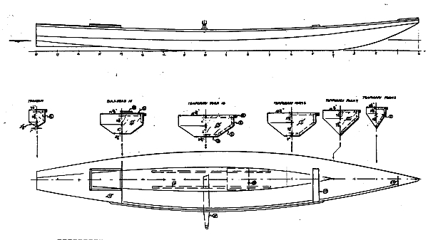

Marksbark, Fast Rowboat, 18' X 3', 90 POUNDS EMPTY
This long narrow boat was designed a long time ago for Mark Bustemonte who thought it might be possible to have a boat for fast sliding seat rowing, for slower fixed seat rowing with a passenger, and maybe for use as a canoe by kids.
I agreed with the idea. I had already once rigged Toto with outriggers and oars. Toto is too short to take a sliding seat. She was a bit faster under oars than with paddle - you can get lots more muscle behind oars and I think the oars are less tiring. But the low slung oars were a problem in rough water and I suspect that is a problem with all low sided rowboats. Also I didn't think the extra speed made up for the extra gear involved and having to watch my own wake instead of seeing what's up ahead. For sneaking up on wildlife and such, the double paddle or kayak has it all over any type except for maybe an electric. Anyway, with the extra length of Marksbark, I think she'll hit 6 mph in good conditions and cruise forever at 4 mph.
It will be interesting to see if Marksbark is stable enough for normal kid rough housing used as a canoe. She's already wide for a sliding seat boat.
Marksbark was drawn well before I put a simple straight plug in the middle of Toto to get a Larsboat. Today I would suggest simply putting a 5' straight plug in the middle of Toto to get the length of Marksbark, long enough for a sliding seat. Instead back then I stretched out the Toto which will probably look more elegant but the prototype builder will have to keep a close eye out to see if the pieces all fit since all this was done before I figured out how to use a PC to give the shapes of the expanded panels. He ought to do what I did with the original Toto - stick it all together except for the bilge panels and then trace the shape of the bilge panel hole onto cardboard and transfer to plywood. The Marksbark plans do give the shape of the bilge panel but as with all multichine shapes it pays to cut that bilge panel well oversized and trial fit to see if the lines are correct. The thing is the last piece of the puzzle catches all the previous mistakes of the builder (and designer!) and a trial fit before cutting to the line is always a good idea.
Marksbark plans are $20 until a prototype is built and tested. Needs four sheets of 1/4" plywood with taped seam construction. No jigs or lofting required.
